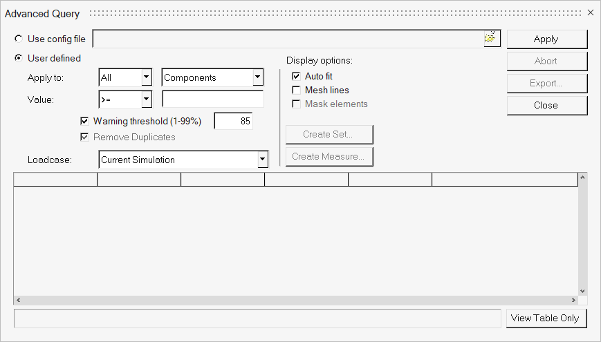

From the Query panel, click the Advanced button.
The Advanced Query dialog is displayed.
Figure 1. Advanced Query Dialog

If User defined is selected, use the Apply
to drop-down menu to determine the entities that the query will
apply to.
- All - Apply the query to all entities.
- Displayed - Apply the query only to the displayed entities.
Select a parameter from the list using the Value
drop-down menu.
If the entity type is set to Components, the options include the following operators:
- greater than or equal to, >=
- less than or equal, <=
If the entity type is set to Elements or Nodes, the options include the >= and <= operators, plus:- Top N
- Bottom N
These two options allow you to display only a certain number of entities in the table. For example, if you are querying elements, and the query returns 1000 elements, then you can set the top 500 elements to be reported in the table. -
Remove all duplicates from the queried nodal data by enabling the
Remove duplicates check box.
This option is enabled when either:
- The native result binding is set to nodal.
OR
- The Average across component boundary option is selected in the Contour or Iso panels.
Note: This option is disabled for all query entity types other than node. - The native result binding is set to nodal.
- Specify a warning threshold by entering a positive decimal number (between 1 - 99) into the Warning threshold (1-99%) field.
From the Loadcase drop-down menu, select a loadcase to
apply the query to.
Option Description Current Simulation The current simulation step. Current Loadcase Cycle through all simulation steps. All Loadcases All available loadcases. -
Click Apply to apply your settings and start the
query.
The acquired data is displayed in a table. Based on the entity type, the table consists of different columns. Data can be sorted in the table by clicking on the header cells. When clicking on a colored cell, the corresponding component/node/element is displayed in the window.
