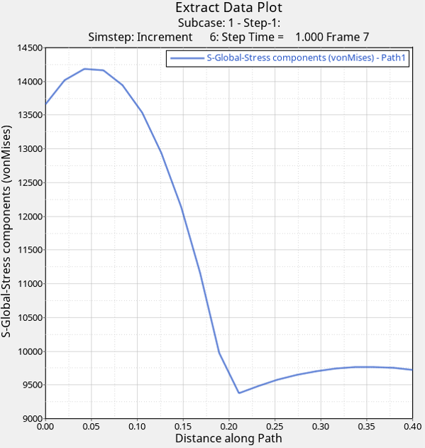

From the Plot portion of the tab, choose the layout for plotting the data in
HyperGraph.
Option Description One plot per line Creates one HyperGraph window for each selected Path. One plot for all lines Creates one HyperGraph window for all selected Paths. Preview Plot Displays the plots for all selected Paths in a preview window. - Optional:

One curve per path is generated in the case of extract data method. In addition a report is created if the Save Report option is selected.
