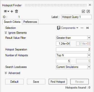

Open the Hotspot Finder dialog by clicking
on the guide bar.
Review the hotspot search settings in the Search Criteria tab.

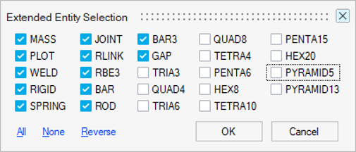

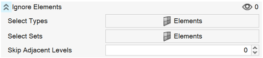

- Optional:
You can choose to ignore the elements from your selection by their
configuration (type) or by specific sets during the hotspot search. Start by
expanding the Ignore Elements options in the
dialog.
Figure 3.
- Use the Select Types button to choose the element configurations to be ignored.
Figure 4.
Use the Select Sets button to choose any element set to be ignored.Figure 5.
- Optional:
Apply a threshold for hotspot values by using a Result Value
Filter.
You can choose from Greater than, Less than, Within Range, Out of Range, and None.By default, an 80 % of the min-max range from the current legend is used with Greater than filter as a threshold.
- Optional:
Apply a tolerance around the hotspots found by using a distance-based
Hotspot Separation.
The hotspot entities will be away from each other at least by a distance equal to the value you have entered. This method uses distances between nodes, element centroids, or component centers depending on the type of result chosen.By default, this tolerance value is taken to be 10% of the length of the biggest diagonal in the model bounding box.
- Optional:
Select a maximum number of hotspots to be searched and listed using the
Number of Hotspots drop-down menu.
You can choose from extreme Top, Bottom or both types of values. You can even choose to disable this filter. By default, this option looks for the Top five hotspots.

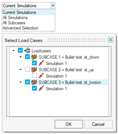

Select the loadcases for hotspot selection by using the Search
Loadcases option.
By default it uses Current Loadcase. You can change this by selecting options like All Simulations, All Subcases, or Advanced Selection.
Figure 6.
You can repeat the hotspot search individually for each and every selected
simulation step, component, or assembly by using the
Advanced options.
Figure 7.
- Save the current hotspot query definition using the Save button.
- Run the hotspot search using the Find Hotspot button.
