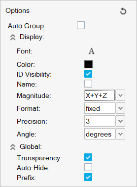

- With Auto Create enabled, pick entities graphically or input
the IDs. One measure item is created for every entity picked
and assigned its own measure group (default). If the “Auto
Group” check box under the Options menu is selected, then
all items are put under a single group.

Nodal Contour or Elemental Contour When a contour has been applied to the model, an additional measure option is available. Nodal Contour is added if the contour contains nodal results; Elemental Contour is added if the contour contains elemental results. For each of these measure types, you can display the nodal or elemental values of the selected nodes or elements by activating Value.
- Guide bar Method
If you want to first select many entities and then create measures for all of these entities in a single click, then disable Auto Create, pick the desired entities, and click the Create button. This will also put all the created measure items under a single group.

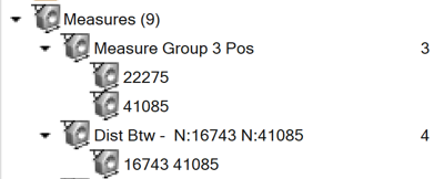

- Display of Measure Items within a Group:
All of the items/entities included in a measure group are displayed under the Measure group in the Results Browser. Simply expand the Measure Group folder to view the items. Right-click on an item in the browser tree to access the delete option. In the case of a minimum distance measure item, an edit option is also available in the context menu.
Figure 4.
Measure items in a group are also listed in the Items field in the Entity Editor. Move a selected item to a different location within the list (up/down) using the reorder arrow buttons
