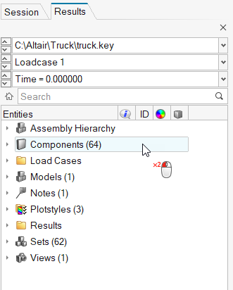

- In the Results Browser, double-click on an entity or collector to
open its respective view.
Depending on the type of entity selected, a flat list of hierarchical list is displayed and additional columns may be appended to the Results Browser. The color of geometry and mesh in the modeling window will be changed if the entity type selected has a corresponding color mode.
