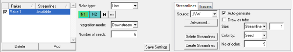

Streamlines
Use the Streamlines tool to generate streamlines using any available nodal or elemental vector field (typically a velocity field).

From the Create tools, select .
