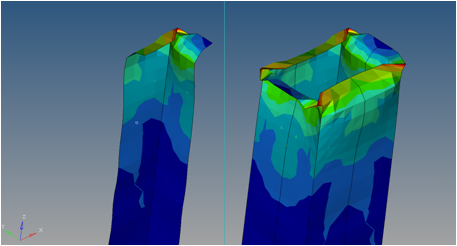

Symmetry visualization allows partially modeled geometry to be shown in full extent by reflection and/or duplication or in the case of axisymmetric models, by 3D geometry generation.
The Symmetry dialog allows you to define options which can be used to visualize what a whole model would look like when you are modeling only a half, quarter, or a partial segment or as axisymmetric.

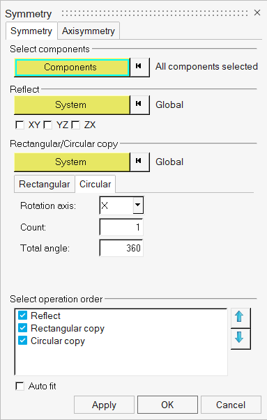

| Reflect | Generates a mirror image of the selected geometry across the plane of symmetry specified. Multiple planes of symmetry are supported, along with an option to specify a local coordinate system for the plane orientation. | |
| System |
Use the System input collector and the extended entity selection menu to select, or change, a local system to be reflected: Global or User Defined (Rectangular, Cylindrical, or Spherical). If no selection is made, the Global system will be used by default. See Select Entities Using the Input Collector for more information on selecting entities. You can also pick systems directly from the screen by clicking on the model display. The user-defined system, or any local system, is helpful in specifying the planes when the model set up is such that the planes of symmetry do not pass through the global origin or when they are not parallel to the global axis. The currently selected system is displayed to the right of the input collector. |
| XY/YZ/ZX | Use the various check boxes to determine the symmetry about any or all of the
XY, YZ, ZX planes (of the selected system). You can combine planes by selecting/checking multiple options. |

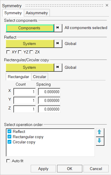

| Rectangular/Circular copy | Generates geometry that is spaced in a rectangular or circular array. The number of copies and the direction in which the geometry is copied can also be controlled using the available options. | |
| System |
Use the System input collector and the extended entity selection menu to select, or change, a local system to be reflected: Global or User Defined (Rectangular, Cylindrical, or Spherical). If no selection is made, the Global system will be used by default. See Select Entities Using the Input Collector for more information on selecting entities. You can also pick systems directly from the screen by clicking on the model display. The orientation of the local system is more important than the origin for a rectangular copy. All the distances specified for separation are incremental distances from the model position. The currently selected system is displayed to the right of the input collector. |
| Count |
Input the number of rectangular copies to be displayed in each direction (X, Y, Z) using the specified spacing (see below). For example, if 2 is specified in the Count field for X, Y, and Z - then a total of 8 copies would be displayed (2 x 2 x 2). The number specified must be equal to or greater than 1. |
| Spacing (Rectangular) |
Specify the offset distance relative to the original location to be used. The spacing is the incremental distance from the current position. The direction of translation is obtained from the system selected. A negative number translates the geometry in the opposite direction of the axis. | |
| Rotational axis (Circular) |
Use the drop-down menu to determine if the reflection or copy will be displayed in the X, Y, or Z direction. | |
| Count (Circular) |
Input the number of circular copies to be displayed in angular sectors. Starting from zero degrees, the angular placement of subsequent sectors is (total angle/count). For example, if an analyzed sector spans 30 degrees and a Total angle of 90 degrees and a count of 3 is specified - then the first copy will be set at 0 degrees, the second copy at 30 degrees, and the third copy at 60 degrees. Or if the count = 3 and total angle = 180 - then the first copy is set at 0 degrees, the second copy at 60 degrees, and third copy at 120 degrees. |
| Total angle (Circular tab) |
Specify the offset distance (in degrees) relative to the original location to be used. See the explanation for Count (above) to better understand the relation between Total angle and the number of copies made. |
| Select operation order | Allows you to control the application and order in which the operation(s) will be executed. To modify the operation order, click on the desired option (Reflect, Circular copy, or Rectangular copy) and use the blue arrows to move an operation up or down the list. The operations can be placed in any order - for example you can move copy before reflect, or reflect before copy, etc. | |
| Auto fit | Automatically adjusts the view so that model and duplicated geometry fit in the window. If this option is not selected, the view is not adjusted and portions of the reflected/copied symmetry could move out of the window | |
| Apply | Apply the settings/changes made to the symmetry. | |
| OK | Apply the settings/changes and exit the Symmetry dialog. | |
| Cancel | Disregard the settings/changes and exit the dialog. | |

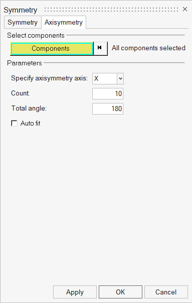

Axisymmetry Tab
| Select components | Typically the entire model is swept, however component selection provides the flexibility to apply the visualization mode only on specific components. | |
| Components |
Use the Components input collector and the extended entity selection menu to select, or change, the components of the model to be swept. If no selection is made, all components of the model will be used by default. See Select Entities Using the Input Collector for more information on selecting entities. You can also pick components directly from the screen by clicking on the model display, or by using the quick window selection method. The currently selected component is displayed to the right of the input collector. |
| Parameters | Specify parameters for generating 3D geometry from an axisymmetric component. | |
| Specify axisymmetry axis | Specify the axis of Axisymmetry for the model. The component will be swept about this axis and a 3-D geometry will be generated for visualization. | |
| Count | Specify the number of slices by which the 3D geometry will be divided. The default value is 10. | |
| Total angle | Specify the angle of sweep about the axis. Default value is 180. Positive and negative values can be entered and the sign will determine the direction of rotation. | |
| Apply | Apply the settings/changes made to the axisymmetry. | |

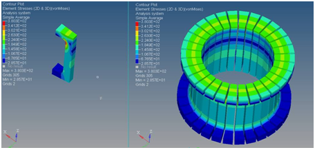

- The Axisymmetric visualization mode is meant to be applied only on axisymmetric components.
- Axisymmetry, if defined, will be applied first to the selected component(s) before applying other symmetry operations, such as reflect or copy, which will be executed in the order specified.

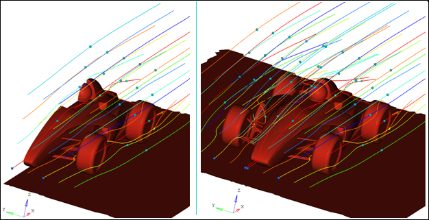

- Components (geometry), Results (contour/vector/tensor plots), Explosion effects,
Section cuts, Added objects, and Tracing will all be reflected/copied onto the
duplicated geometry. In the case of Axisymmetry, the geometry along with any applied
contour will be swept onto a three dimensional shape. Note: In a few cases, when results are on nodes or on elemental corners, the contour on the face of the generated 3D geometry may differ from that on the original component. This is due to the differences in which HyperView renders a contour on 3D elements versus 2D elements.

Reflect or Copy a Specific Component on a Model
From the Transform tools, click the Symmetry tool.
Figure 8.
The Symmetry dialog is displayed. -
In the Symmetry tab, for Select components, select a
component using the input collector or pick a component on the model
display.
If no selection is made, all components of the model will be used as default.
- For Reflect, select a system using the input collector or pick a system on the model display.
Activate the desired check boxes to determine the symmetry about any or all of
the XY, YZ, ZX planes (of the selected system).
Tip: You can combine planes by selecting/checking multiple options.
- For a Rectangular/Circular copy, select a system using the input collector or pick a system on the model display.
From the Rectangular sub-tab, input the number of copies to be displayed in the
Count field and specify the offset distance to be
used in the Spacing field for X,
Y, and Z.
ORFrom the Circular sub-tab, use the Rotational axis drop-down menu to select a direction (X, Y, or Z). Next, input the number of copies to be displayed in the Count field and specify the offset distance to be used in the Total angle field.
For Select operation order, place the operations in the
desired order by clicking on one of the options (Reflect,
copy) and using the blue arrows to move the location of that
You can also activate or deactivate any of the operations by checking/unchecking the boxes located next to each option.The operations can be placed within any order in the list.
Click Apply to display the reflection/copy symmetry in
the graphics area.
ORClick OK to display the reflection/copy symmetry in the graphics area and exit the dialog.
Create a 3-D Visualization of an Axisymmetric Component
Figure 9.
In the Axisymmetry tab, for Select
components, select a component using the input collector or pick
a component on the model display.
- Under the Parameters section, specify axisymmetry axis, count, and total angle.
Click Apply to display the 3-D visualization in the
graphics area.
ORClick OK to display the 3-D visualization in the graphics area and exit the dialog.
