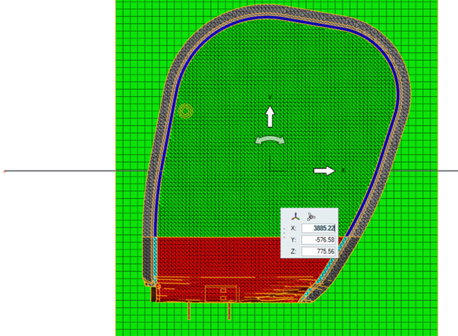

Once the selection is made, a line appears in the modeling window. Using the arrows, you can change the
position of the folding line by rotating it or translating it.
- On the guide bar, click Side.
- Select a node to define which side the airbag is folded on. In the case of a symmetric fold you have to select the side according to the initial fold line. The side for symmetric fold line is calculated automatically.
