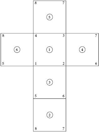

Hex Elements
3D hexahedra elements.
- Hex8
- Configuration 208 - 3D (1st order) hexahedra elements with 8 nodes.
- Hex20
- Configuration 220 - 3D (2nd order) hexahedra elements with 20 nodes.
