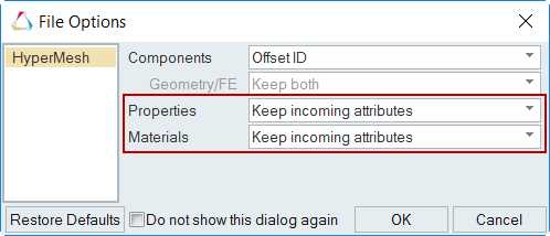

Undefined entities imported from new include files will be organized in the master model.
If an entity is referenced in a solver deck, but is not defined, an undefined entity will be created and assigned the ID of the referenced entity on import. A default card image and a default name will also be assigned to the newly created undefined entity.

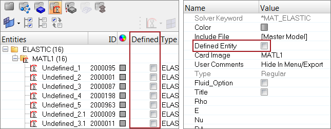

Referenced components are created as an undefined entity.
- If Defined is inactive, the entity not will be written to the solver deck.
- If Defined is active, the entity will be written to the solver deck.
The export status of undefined entities cannot be changed. If Defined is inactive, the export status will also be inactive in the Entity State Browser.

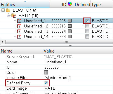

Undefined entities can be defined interactively in the session or via the import of a model that contains the referenced entities. This ensures the entity will be written to the solver deck.
Define an entity interactively in the session by activating the
Defined checkbox in the browser or Entity Editor.

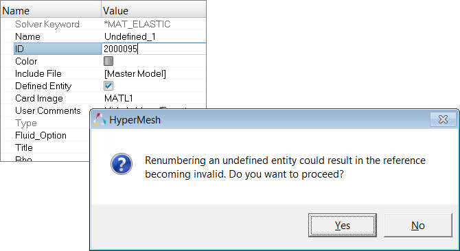

Renumber Undefined Entities
The renumbering of undefined entities is restricted to ensure references to entities that reside in external Include files will not be invalidated.
- In the Entity Editor, ID field, enter a new number for the undefined entity.
In the dialog that appears, click Yes to execute the
renumbering operation.
