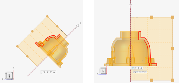

Click X, Y, or Z to align to the global axes. Click
to define target model orientation with the Vector tool.Note: Using these options not only change the axis but performs a global transformation on the entire model as well.- In Figure 2 the original model orientation is random.
- You can select an axis along the part center as described before.
- Aligning to the global x-axis performs a global transformation using a 4*4 matrix that transforms the original axis position to match the desired axis.

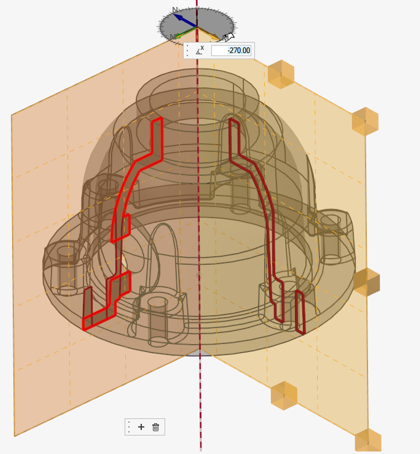

Position the primary cross section at the desired location and resize.
Use the rotation manipulator to position the primary cross section at the desired location to define primary representation (not available for User Surfaces).
Optionally, reduce the size of the cutting plane using the plane handles.

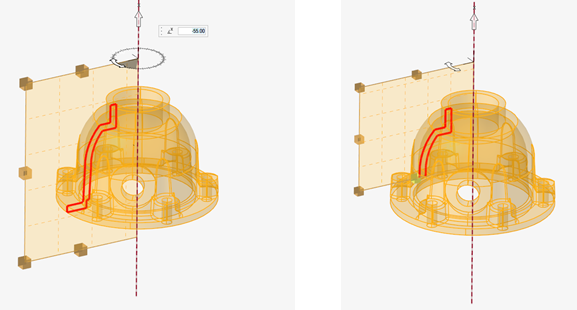

Option Description Add Cross Sections With the Cross Section selector active, click
to add a secondary cross section entity. Use the rotation manipulator
and the dynamic preview to place it at the desired location. It is possible to add multiple secondary cross sections sequentially.

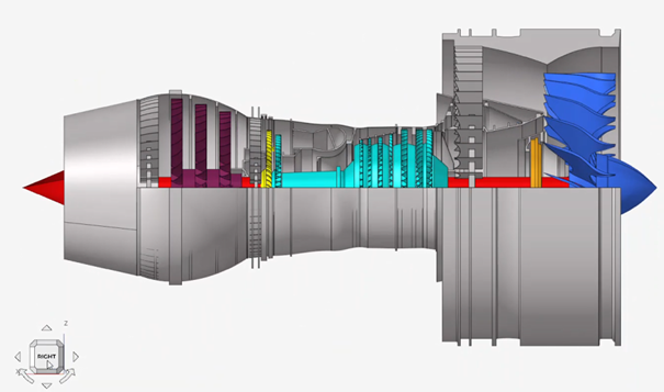

Imprint Solids In some cases, the assembly to represent as axisymmetric surfaces contains a collection of periodically distributed solids (such as the blades of a turbomachine in Figure 5). In this case, the original periodic solids do not need to be part of the solid selection in the Axisymmetry entity creation. Figure 5.
Instead, you can select one instance of such solid as a Solid to imprint.
After Solid selection, a microdialog opens to define the number of instances (def 1), that is the number of repetitions around 360°. The solid is swept around the axis projected to the main surface. An extra parameter is saved at surface level to account for the volume reduction.
