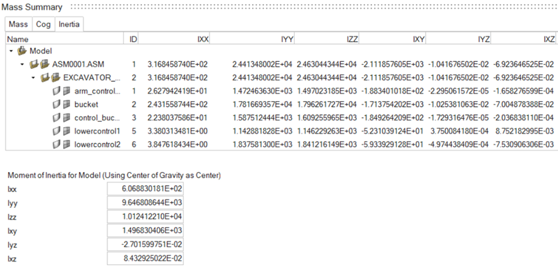

The detailed mass values are displayed in a table.
CoG and inertia selected as the Result Type, per component:Figure 3.

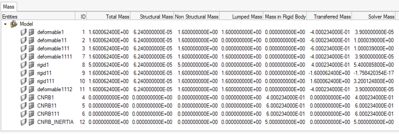

The relevant Total values are displayed at the bottom of the dialog.- Total Mass
- Represents the engineering mass as:
- Structural Mass
- Represents the physical mass of the structure, calculated from the property and material characteristics assigned to the FE mesh.
- Non-Structural Mass
- Represents the additional solver masses added on the structural mesh.
- Lumped Mass
- Represents the portion of the non-structural mass, which is distributed on structural nodes.
- Mass in Rigid Body
- Represents the mass of the nodal rigid body elements in the collector.
- Transferred Mass
- Represents the nodal mass transferred to the nodal rigid body elements or rigid Parts.
- Solver Mass
- Represents the mass as it is calculated by the solver.
Figure 4.
