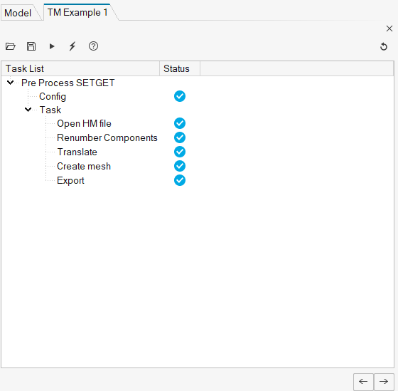

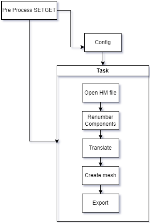

Task Structure
Process Item
- Process
- Task 1
- ProcessCategory1
- Task 2
- Property 1
- Property_Category 1
- Property 2
- Property 3
- Task 3
- Task 2

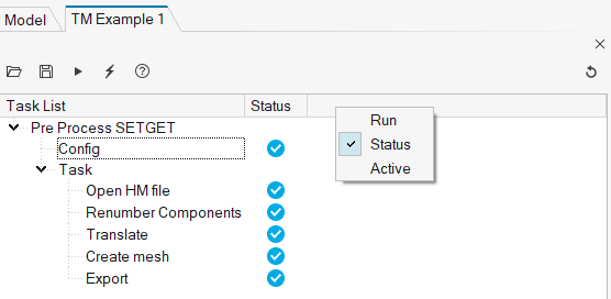

| Run Active |
To change the columns/attributes that display in the browser, right-click on a column heading and toggle
the check boxes in the micro dialog.![]() The Run and Active options are off by default. Click the arrow in the Run column to run a specific task. Active indicates that the task is active within the process. |

Run a Task
From the Developer ribbon, select the Tasks tool.
Figure 6.
If the Developer ribbon is not visible, select . -
From the Tasks Browser, click
to load an XML file that contains tasks and their
attributes.

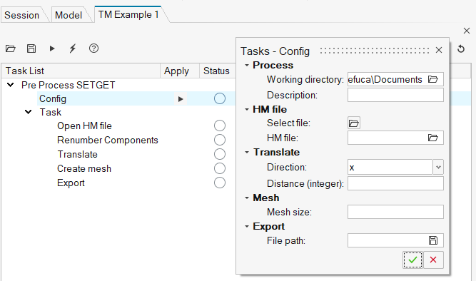

Click the first task.

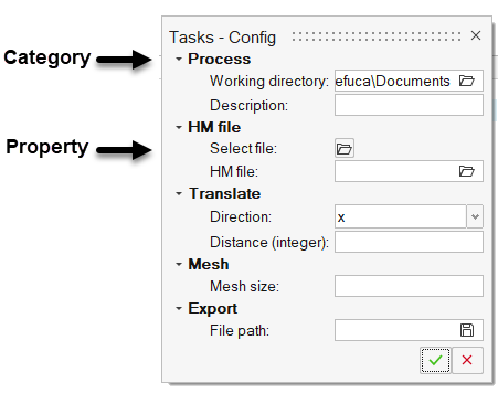

The Tasks-Config dialog is displayed, which contains the properties that are part of the Config task.Note: Click the arrow,
, to expand and collapse the
categories.Figure 7.
Click Apply,
, to execute the task.
The task succeeds or fails. -
