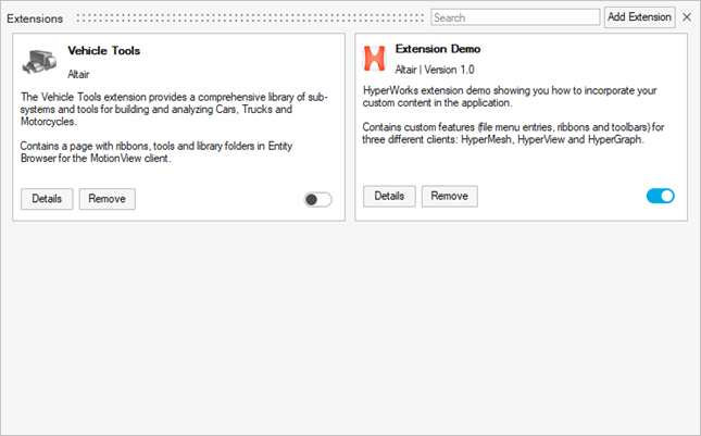

In the Extension Manager dialog, register and load an
extension.
- To unload an extension, disable the slider in the Extension Manager dialog.
- To unregister an extension, select the desired extension and click Remove in the Extension Manager dialog.

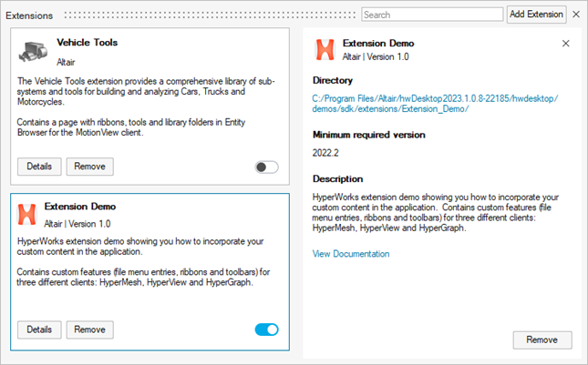

Select the desired extension to see the Extension detailed view containing more
information about the extension.
The detailed view shows the location of the Extension and provides access to additional help in the Description area, if the extension provides it:
Figure 2. Extension Detailed View

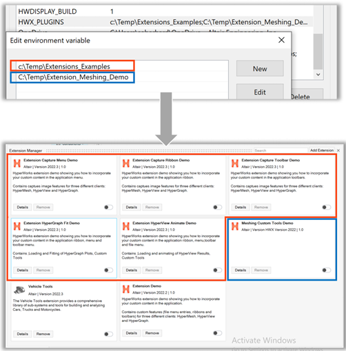

To start with a pre-defined set of extensions, set the environment variable
HWX_PLUGINS to add one or more directories separated
by a comma.
The Remove button for those directories is disabled.
Figure 3.
Disable the Remove button by using the removable keyword in the general section
of the extensions.xml file.
<entry name="removable" value="true"/>
