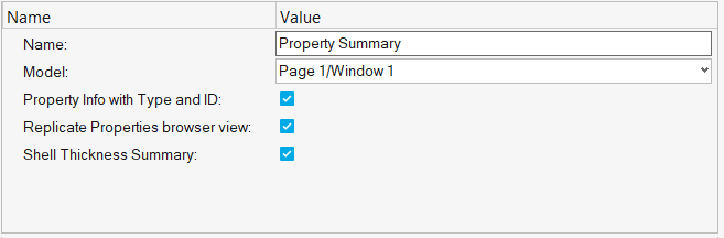

Right-click at the Report or Chapter level and select .- Below are the properties associated with the Property Summary module.
- Name
- The name for the Property Summary.
- Model
- Provide the location of the model in the list of HyperMesh windows in the session.

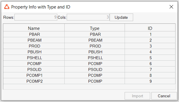

- Property Info with Type and ID
- Table of all properties by its Name, Type and ID.
- Replicate Properties browser view
- The currently displayed tabular data in the Properties browser in HM will be copied into a table.

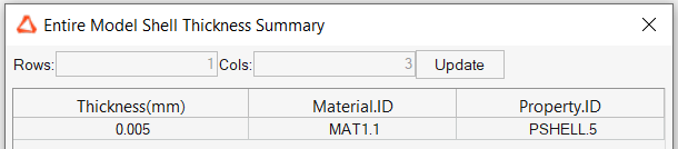

- Shell Thickness Summary

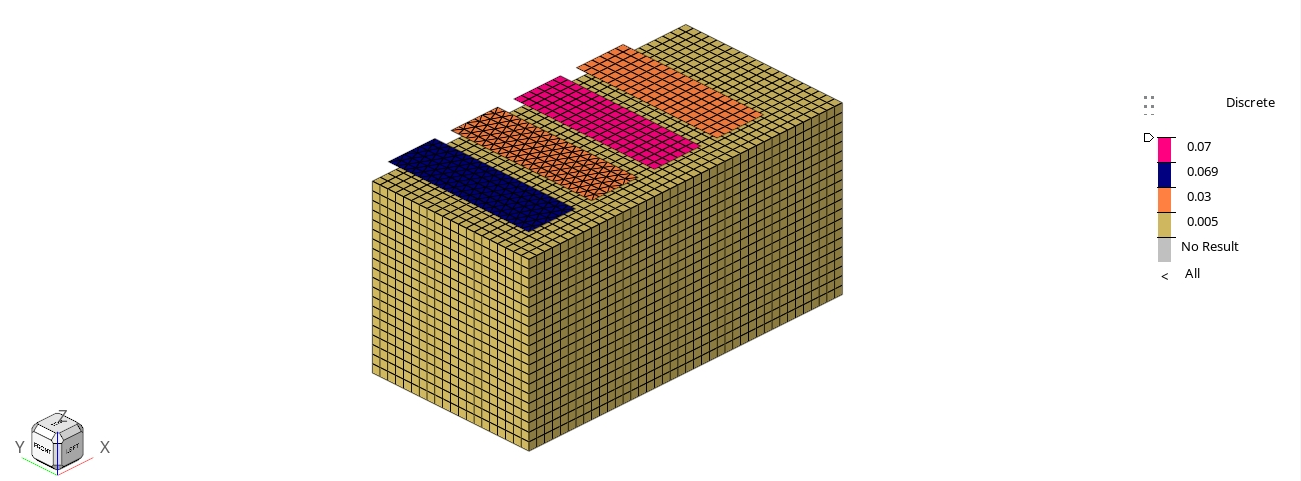

- This option generates the entire model Shell-based property summary based on Shell thickness. It creates a distribution summary as Thickness, Material ID and Property ID.
- Once executed, a table output for Shell Thickness Summary is generated as
follows:Info Model- Text Note. This is created only in Document or HTML reports.
Model Thickness in mm- Image file.Figure 3.
Model Material and Property IDs and plies 0°, 45°, -45°, 90° - Table.Figure 4.
- Once executed, a table output for Property Summary is generated.
Figure 5. Property Info with Type and ID.
