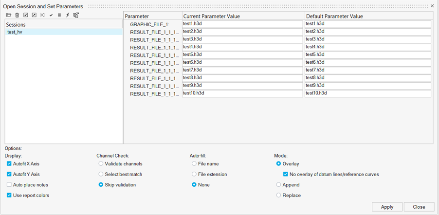

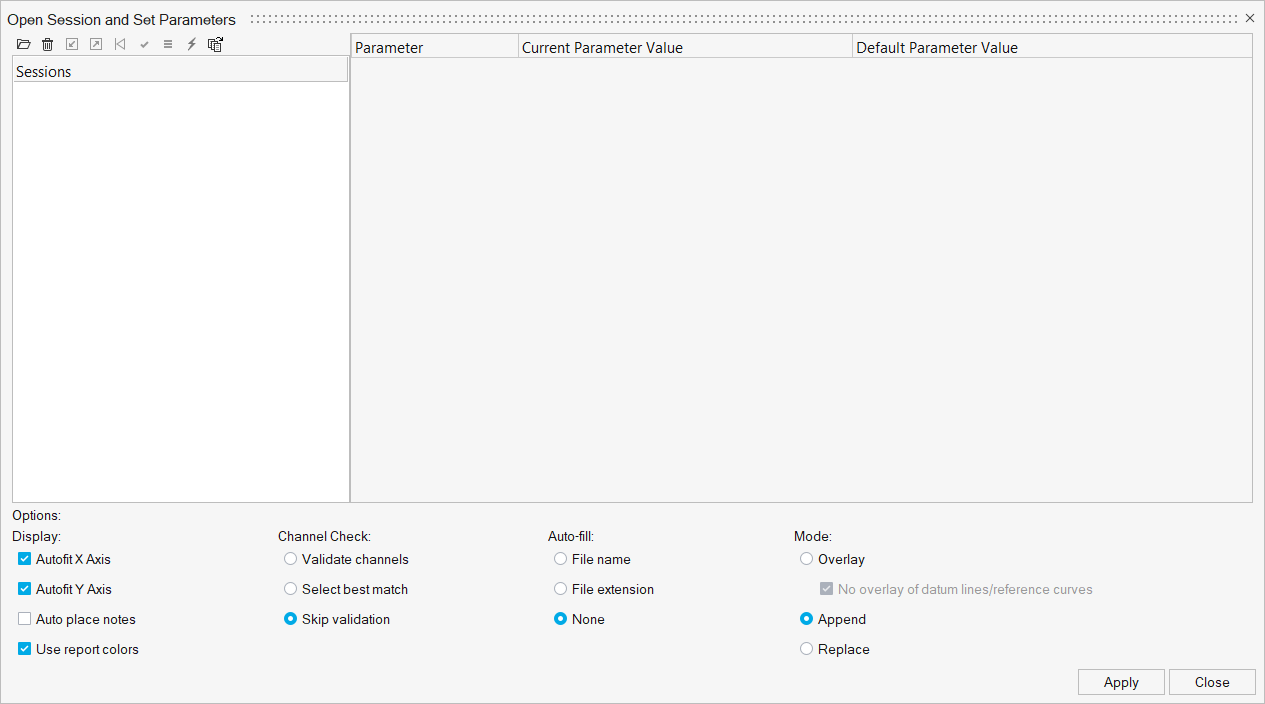

Click Apply to append, replace, or overlay new pages. When using Overlay and Replace in situations where multiple applications of the same report exist, the application prompts you to select the correct report to overlay or replace.
Add a Report Template
- Go to .
- From the Open Session and Set Parameters dialog, click the folder icon to add a report template.
Use the File Browser to select the report template (.tpl file).
The dialog is populated with the file's information.
Delete a Report Template
- Go to .
From the Open Session and Set Parameters dialog, select the report
template you want to delete and click the trash can icon.
The file and its content is removed from the dialog.
Display
- Autofit X Axis/Autofix Y Axis
- Locks the x or y axis of the current plot so that it does not change as new plots are overlaid.
- Auto place notes
- Automatically fits any notes you add to the window.
- Use report colors
- When selected, line colors, line styles, symbol colors, and symbol styles are applied based on the report template. When the Use report colors checkbox is deselected, curve lines and symbols are colored based on the default colors specified in the preferences file. In both cases, the report template controls the display of curve lines and symbols.

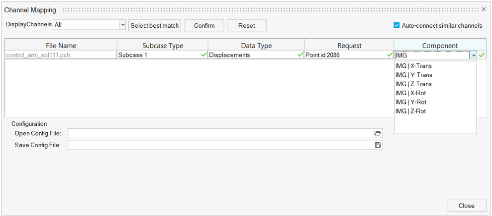

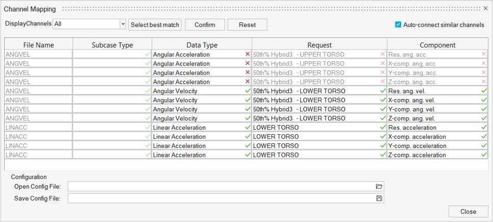

Channel Check
Use Channel Check to add flexibility to HyperGraph by reconciling reports with mismatched channels.

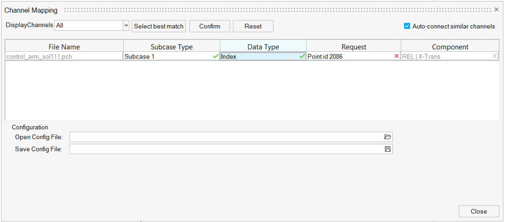

Validate Channels
After loading and selecting a report template from the Report Templates list, select one of the following Channel Check options from the Flexible Reports dialog, and click Apply.
- Validate Channels
- The Channel Mapping dialog is displayed if there is a mismatch among
type/request/components. From the Flexible
Reports dialog, you
can also click the check mark,
, to display the Channel
Mapping dialog. - Select Best Match
- The Channel Mapping dialog is not displayed.
Instead, a best-match algorithm runs in background to match the
type/request/components if there is a mismatch. You can also perform
this operation using Select Best Match icon,
, from the Flexible Reports
dialog. - Skip Validation
- The Channel Mapping dialog is not displayed, nor does it use the best match algorithm in background to match the type/request/components if there is a mismatch; it plots the signals as-is.
Filter and Sort Data Lists
The Channel Mapping dialog contains filtering and sorting functionality to facilitate matching the Subcase Type, Data Type, Request, and Component channels, along with other display and filtering options related to the lists that are displayed in the fields. Wild card support is not available.
- Display Channels
- All displays all channels.

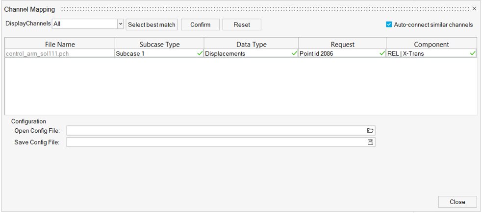

- Select Best Match
- Inserts the best matches into the selected fields, according to the
matching algorithm. The results are sorted using a string match to the
shortest distance. The icon to the right of the field changes from this,
, to a yellow star,
, upon selecting this option. - Confirm
- Click Confirm to approve the current best match
selections. The icon displayed in the the selected fields is updated
from this,
, to this,
. - Reset
- Resets the fields to the default, or previous, selections. The
and
icons return to the
. - Auto-connect similar channels
- This option is on by default. If you want to manually correct one or
more channels without similar channels updating automatically, deselect
the Auto-connect similar channels option.Note: If you reselect Auto-connect similar channels before saving your selections to a config file, and you attempt to a match a channel, all similar channels are mapped, and your previous selections are overridden.
Context Menu and Configuration File
Once the channel mappings are resolved, click Save Config File to save the reconnected channels to configuration file which can be used for future mappings.
Click the File Browser icon in the Open Config File field to load a previously saved configuration file to correct any unmatched channels. Once loaded, click Apply on the main panel to plot your results.

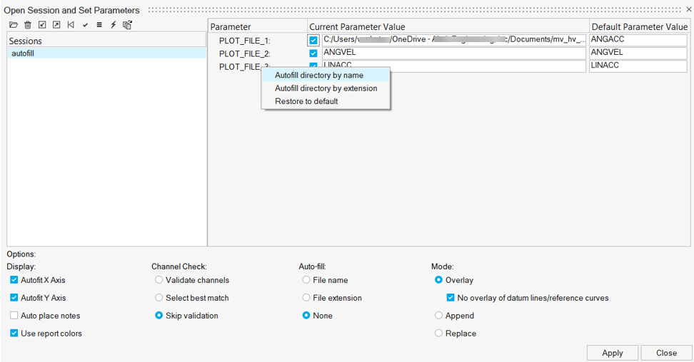

Auto-fill
Autofill
- File name
- Autofills the directory. Other files needed for the report template are updated to use the files in the selected directory based on the file name.
- File extension
- Autofills the directory. Other files needed for the report template are updated to use the files in the selected directory based on the file extension.
- None
- Disables autofill. Select the required file set for each parameter.
Use Autofill Directory
- Go to .
The Parameter column lists the template's data files. The Current Parameter Value column displays the filenames used in the session.
- Click Apply to plot the data.
- Click PLOT_FILE_1 to activate the parameter.
- Click the file folder icon to select a new file.
To autofill the remaining files in the Reports panel, right-click the file path
next to PLOT_FILE_1 and select Autofill directory.
By selecting Autofill directory, the other files needed for the report template are updated to use the files in the selected directory.

Mode
- Overlay
- Overlay mode combines report animations and plots for comparison in the session. Report definitions with different names can be overlaid if they have the same layout, which means the same number of pages, where each page has the same page layout and the same number of applications per window. If the report layout does not match, the report is added to the end of the session.
- Append
- Adds a report to the end of the current report.
- Replace
- Replaces an existing report with a new report. Report definition names must match. If report definition names do not match, the report is added to the end of the session.

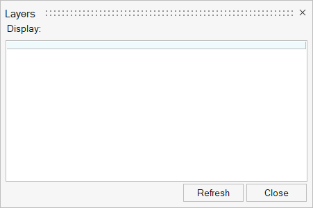

Layers
- Refresh
- If you delete a curve or make other changes within the Flexible Report Templates dialog, such as adding another layer, click Refresh to reflect those changes inside the Layers dialog.
- Rename
- From the Layers dialog context menu, click Rename to rename the selected layer.
- Delete
- From the Layers dialog context menu, click Delete to
delete the selected layer.Note: Curves associated with the layer will be deleted in HyperGraph; models in HyperView or cells in TableView will not be deleted.
