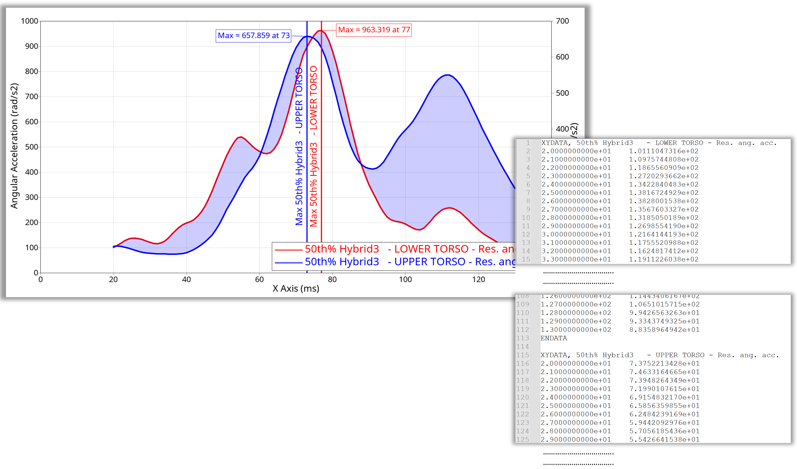

Example 01 - Curves from Files, Datums, Notes, Legends and PNG, XYDATA Export#
Load two curves, shade the area between, add notes and datums and export PNG#

Figure 1. Exported Image of script ‘Curves from Files, Datums, Notes, Legends and PNG, XYDATA Export’

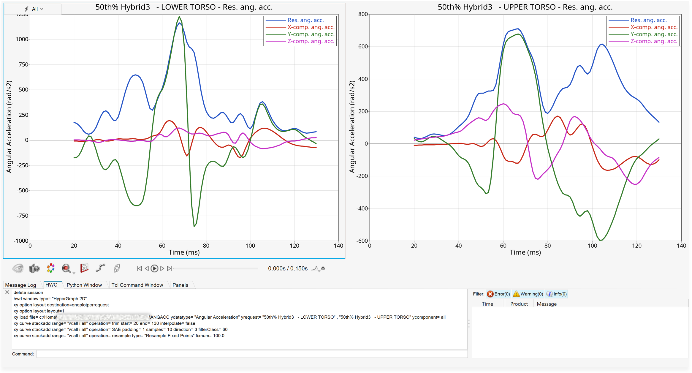

Example 02 - evalHWC() for Curve Import and Math Operations#
evalHWC() - Curve Import and Math Operations#

Figure 2. Output of ‘evalHWC() for Curve Import and Math Operations’
