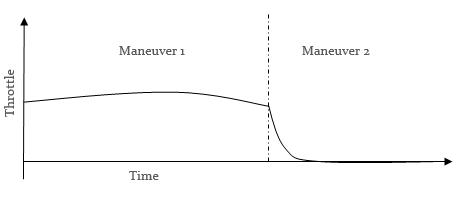

- Parametric Expressions
- In a multi-maneuver event, expressions need to be re-evaluated before
the start of the maneuver in order to maintain the continuity of the signals.
- { Expression in Curly Braces }
- Instruction to driver to evaluate the expression before giving it to MotionSolve
- {SIGNAL}
- Evaluated as VARVAL(signal solver variable id)
- {SIGNAL_0}
- Evaluated as Signal Value at the end of last maneuver
- {%SIGNAL}
- Evaluated as {SIGNAL} – {SIGNAL_0}

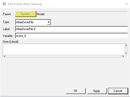

Use the Task Wizard to load the driver analysis.
Select the AltairDriverFile as the Event Type and click
OK.
Figure 3.

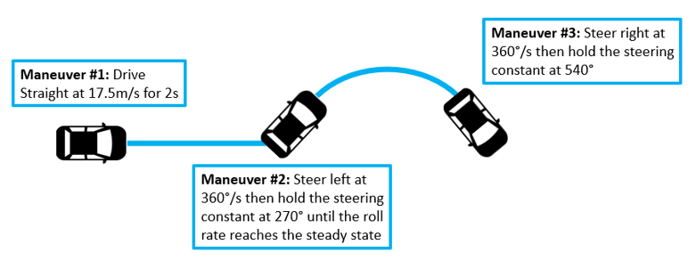

We will model a Fish Hook Event using three sequential maneuvers.

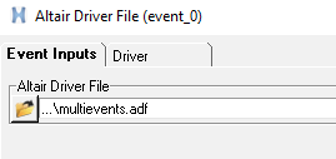

Enter the multievent.adf file and run the simulation.
Figure 6.

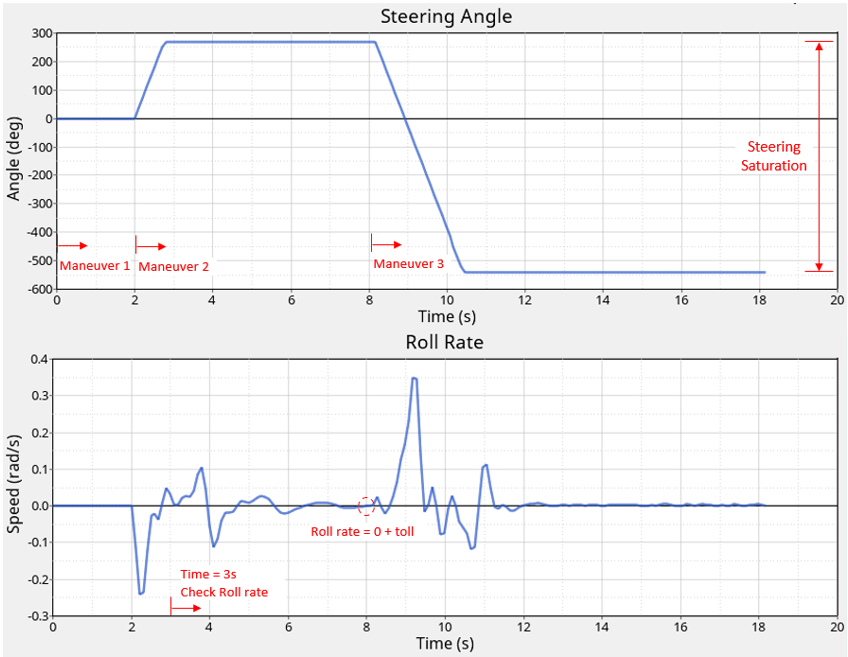

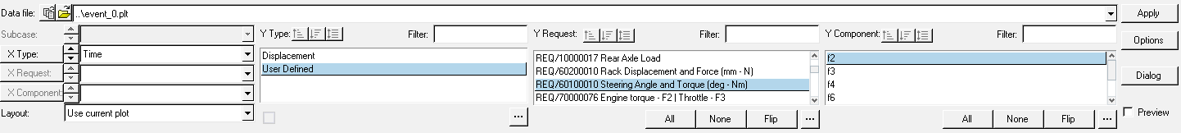

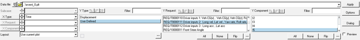

Plot in HyperGraph the Steering Angle and Roll Rate.
Figure 7. Steering Angle
Figure 8. Roll Rate
The plots show the Maneuver 2 stopping when the roll rate is consistently 0 (with mentioned tolerance) for 0.5 seconds after the 3s. The simulation then changes to the Maneuver 3 with the vehicle turning to the right as specified in the multievent.adf.Figure 9.
