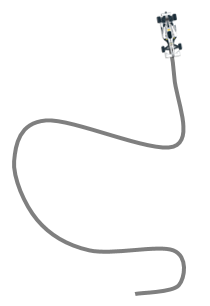

- Defining a path for the driver
- Multiple methods can be used to provide the desired path:
- Table of centerline points
- Path is provided as a table of equally spaced cartesian
coordinates of centerline points. These points are provided
in a separate file, DDF or Driver Demand File.
$Example DDF [ALTAIR_HEADER] FILE_TYPE = 'DDF' FILE_VERSION = 1.0 FILE_FORMAT = 'ASCII' $---------------------------------------------------UNITS [UNITS] (BASE) {length force angle mass time} 'm' 'newton' 'degrees' 'kg' 'sec' $---------------------------------DEMAND_VECTORS [DEMAND_VECTORS] {X Y Z} 0 0 0 -4 0 0 -1 0 0 -2 0 0 -5 0 0 -3 0 0 - Sequence of straights and arcs
- Path is provided as a table of straights and circular section.
- Predefined path
- Path is one of the predefined paths visualization (Constant Radius, Single lane change, Double lane change, and Slalom).

Path as a Table of Cartesian Coordinates of Centerline Points Event
In this step, you will give a path as a table of Cartesian coordinated of centerline points and define the velocity profile along the path.
Open text editor and copy and paste the following text into it.
Important: All blank lines must be removed prior to saving the file.
$-----------------------------------------------------------------ALTAIR_HEADER [ALTAIR_HEADER] FILE_TYPE = 'ADF' FILE_VERSION = 1.0 FILE_FORMAT = 'ASCII' $--------------------------------------------------------------------------UNITS [UNITS] (BASE) {length force angle mass time} 'meter' 'newton' 'radians' 'kg' 'sec' $--------------------------------------------------------------------VEHICLE_IC [VEHICLE_INITIAL_CONDITIONS] VX0 = -20.0 VY0 = 0.0 VZ0 = 0.0 $--------------------------------------------------------------STEERING_STANDARD [STEER_STANDARD] MAX_VALUE = 3.141593 MIN_VALUE = -3.141593 SMOOTHING_FREQUENCY = 10.0 INITIAL_VALUE = 0.0 $--------------------------------------------------------------THROTTLE_STANDARD [THROTTLE_STANDARD] MAX_VALUE = 1.0 MIN_VALUE = 0.00 SMOOTHING_FREQUENCY = 10.0 INITIAL_VALUE = 0.2 $---------------------------------------------------------------BRAKING_STANDARD [BRAKE_STANDARD] MAX_VALUE = 1.0 MIN_VALUE = 0.0 SMOOTHING_FREQUENCY = 10.0 INITIAL_VALUE = 0.0 $-----------------------------------------------------------------MANEUVERS_LIST [MANEUVERS_LIST] { name simulation_time h_max print_interval} 'MANEUVER_1' 10.0 0.01 0.01 $---------------------------------------------------------------------MANEUVER_1 [MANEUVER_1] TASK = 'STANDARD' (CONTROLLERS) {DRIVER_SIGNAL PRIMARY_CONTROLLER ADDITIONAL_CONTROLLER} STEER FEEDFORWARD_STEER NONE THROTTLE FEEDFORWARD_TRACTION NONE BRAKE FEEDFORWARD_TRACTION NONE $---------------------------------------------------------STEER [FEEDFORWARD_STEER] TAG = 'FEEDFORWARD' LOOK_AHEAD_TIME = 0.5 $Instruction to the driver that the path is of type DDF PATH = 'DDF' $Path of the ddf file, data lies in same folder in file named snet.ddf FILE = 'snet.ddf' $--------------------------------------------------THROTTLE & BRAKE [FEEDFORWARD_TRACTION] TAG = 'FEEDFORWARD' TYPE = 'FOLLOW_VELOCITY' LOOK_AHEAD_TIME = 0.5 DEMAND_SIGNAL = 'DEMAND_SPEED' $---------------------------------------------------------DEMAND_SPEED $Block containing all the information about the acceleration profile to be followed [DEMAND_SPEED] TYPE = 'CURVE' $Velocity profile information is in the file snet.ddf in the same folder $Velocity profile is defined under the column name DV in the DDF ${X Y Z DV} FILE = 'snet.ddf' DEMAND_VECTOR = 'DV' - Place snet.adf in the same folder as the ADF.
- Run the simulation and study the results.
Replace the DEMAND_SPEED block in the ADF with the following text.
[DEMAND_SPEED] TYPE = 'CURVE' BLOCK = 'DEMAND_CURVE' $-------------------------DEMAND_CURVE [DEMAND_CURVE] INDEPENDENT_VARIABLE = 'PATH_S' DEPENDENT_VARIABLE = SIGNAL INTERPOLATION = 'LINEAR' {PATH_S SIGNAL} 0 30 250 35 400 10 584 10 680 25 780 10 942 10 1300 40 1695 10 1868 10 1958 10 2040 15 2109 15 2173 15 2300 20 2409 15 2524 15 2647 10 2811 10 3500 50The DEMAND_SPEED block is edited to be a curve as a function of distance traveled along the centerline.
