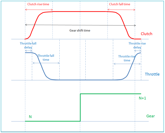

- The Engine speed based shift controller upshifts whenever engine speed goes above the upshift RPM, and it downshifts when the engine speed goes below the downshift RPM. The Gear shift controller also controls the throttle and clutch signal as shown in the figure below.

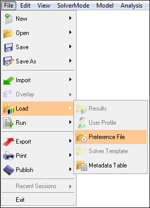

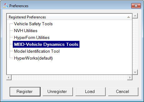

Ensure the MBD-Vehicle Dynamics Tools preference file loaded is for all of the
MotionView functionality of the Advanced Driver
to work properly.
Figure 3.
From the menu bar, select .

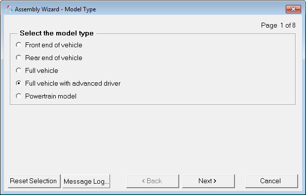

Select the Full vehicle with advanced driver
option.
This takes care of all the dependencies of the advanced driver.
Figure 5.
- Click Next.

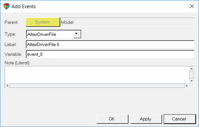

Select AltairDriverFile from the Type drop-down
menu.
Figure 7.

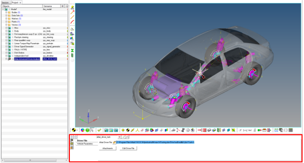

This automatically resolves all of the vehicle attachments for the
Altair Driver.Figure 8.
Selecting the AltairDriverFile 0 will open up the driver event panel. Selecting the Event Editor button will open the Altair Driver File dialog.
