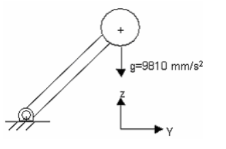

The model will look as shown in Figure 2:Figure 2.

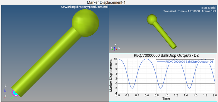

Click the
Animate and Plot the Results
Now you will animate and plot the results of the pendulum MDL model run.
In the Run panel, click Animate.
A window with the pendulum.h3d results file will load next to the modeling window.
- Click in the new window to make it active.
On the Animation toolbar, click the
(Start/Pause Animation) button to view the
animation.
Note: You can click the button again
to pause the
animation. -
On the Standard Views toolbar, click the
(Fit Model/Fit All Frames) icon to fit the
visualization in all frames of the animation.
- Click on the MotionView window to make it active.
On the Run panel, click Plot.
A plot window with the pendulum.abf results file will load next to the modeling window.
- In the panel, set the Y Type to Marker Displacement, the Y Request to REQ/70000000 Disp Output - (On Ball), and the Y Component as DZ.
Click Apply.
The plot shows the displacement of the pendulum in the Z direction.
(Start/Pause Animation) button to view the plot and
animation together.
Note: You can click the button again to pause the animation.Your session should look similar to the example shown in Figure 3:Figure 3.
