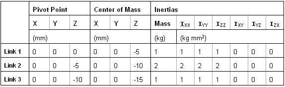

Tx = step(TIME,.3, 0, .31, 10) + step(TIME, .31, 0, .32, -10) - Apply this torque to estimate the natural frequencies of the triple pendulum
model shown in Figure 1:
Figure 1. Schematic representation of a triple pendulum in stable equilibrium

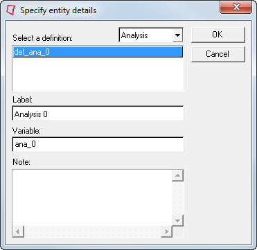

Verify that the Select a definition drop-down menu is set to
Analysis.
Figure 3.
- Click OK.

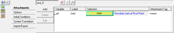

- In the Project Browser, click the newly added Analysis 0.
Resolve the joint attachment.
