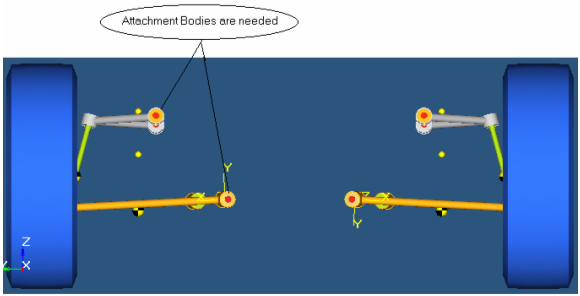

- The picture below shows a system definition of an SLA suspension. It is an
incomplete system which needs information about the attachment bodies and
points to get connected to.
Excluding the *Attachment() statement, other entities in a system definition are similar to an MDL model file.

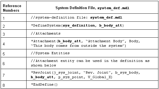

The general structure of a system definition is:- A system receives information about entities external to the system via attachments.
- Any MDL entity can be passed to a system as an attachment.
- The *Attachment() statement inside the system
definition declares the arguments in the
*DefineSystemblock as an attachment, along with assigning what type of entity the attachment is going to be. - The same variable name as the attachment should be referred within the definition when defining an entity that depends on the external entity.
- Refer to the entries in bold in the example below. Reference
line numbers are for reference only and are not part of the MDL
file.
- Line 2 - defines a system with a variable name
sys_definitionand has one argumentb_body_attas an attachment. - Line 4 - declares
b_body_attas an attachment with the entity type as Body. - Line 7 - creates a revolute joint between
b_sys_bodywhich is a body defined within this system (not shown) andb_body_attwhich is a body that is an attachment to this system.
