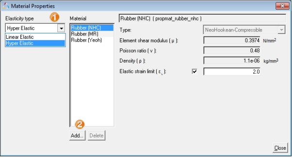

- From the menu bar, click .
- In the Material Properties dialog, for Elasticity type choose Hyper Elastic.
Click the Add button.
Figure 1. Adding new HyperElastic material

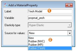

In the Add a Material Property dialog, specify a Label of
Yeoh Modeland a Variable name aspropmat_yeoh. -
For Source for values, select Rubber (Yeoh).
Figure 2. Selecting source values for new material

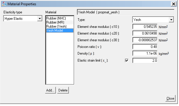

In the Material Properties dialog, specify the material
constant values.
Element shear modulus (c10):
0.545235 -
Element shear modulus (c20):
0.0610498 -
Element shear modulus (c30):
−0.000802537 -
Poisson ratio (
): 0.48 -
Density (
): 1.1e-6 -
Elastic strain limit (εL):
2.0
Figure 3. Specifying material constant values

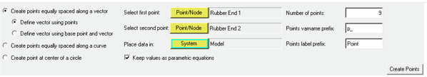

Create two point entities for the rubber strip length profile using the details
in Table 1:
Table 1. S.No Label Variable name x y z 1 Rubber End 1 p_rub_end1 0.0 0.0 0.0 2 Rubber End 2 p_rub_end2 50.0 0.0 0.0 -
Use the
(Create Points Along A Vector) macro to create 9
intermediate points between Rubber End 1 and Rubber end 2.
Figure 4. Creating intermediate points using “Create Points along a Vector” macro

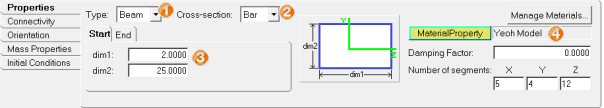

In the dialog, add a new NLFE body with a Label
Rubber Stripand a Variable namenlfeb_rubber_yeoh. -
Configure the Properties tab.
- Specify the Type as Beam.
- Specify the Cross-section as Bar.
For dim1, enter
2. -
For dim2, enter
25. - For the Material Property, select the Yeoh Model that you created previously.
Figure 5. Specifying beam properties

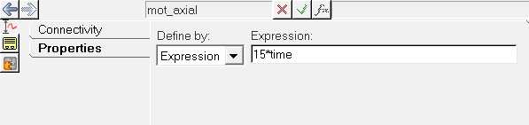

Create a motion on the Translational joint to apply axial pull. Use the
specifics in Table 3:
Table 3. S.No Label Variable Name Define Motion Joint Property 1 Axial Motion mot_axial On Joint Translational Joint Displacement -
In the Properties tab for the motion, for Define by: choose
Expression. In the Expression field, enter
`15*time`.Figure 7. Motion expression

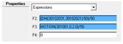

Add Outputs
Now you will create outputs to measure engineering strain and engineering stress values.
Engineering Strain =
Engineering Stress =
Right-click the
(Outputs) icon.
In the dialog, specify a Label of
Eng strain (F2), Eng Stress (F3), and click OK. -
In the panel, for F2 type the expression
`(DM({j_trans.i.idstring},{j_fix.i.idstring})-50)/50`. For F3, type the expression`MOTION({mot_axial.idstring},{0},{2},{0})/50`.Figure 8. Output requests
Note: In the expression F2, the solver function DM() measures the distance magnitude between two markers; the I marker of the Translation Joint and the I marker of the Fix Joint. Expression F3 uses the solver function MOTION() which measures the reaction force due to the imposed motion Axial Motion.

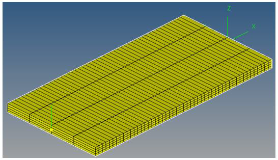

After the simulation is completed, click Animate to view
the animation in HyperView.
You can use the
(Start/Pause Animation) button
to play the animation. -

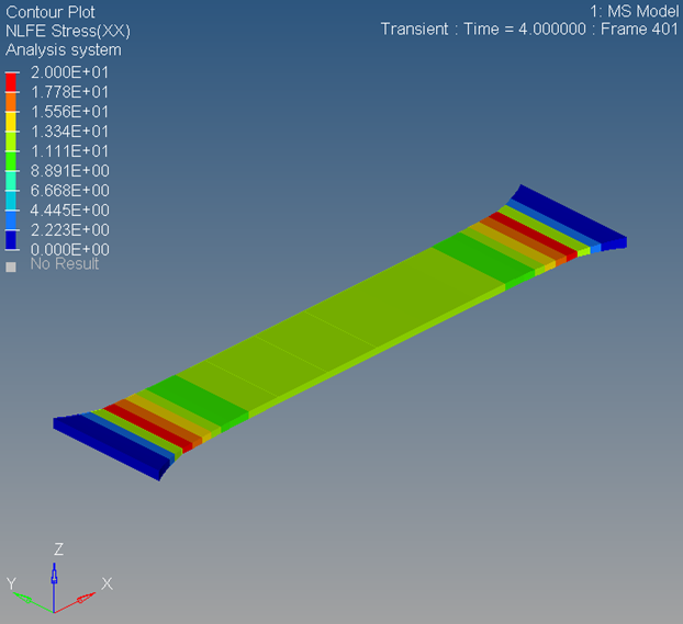

Go to the Contour panel, select NLFE Stress (t), XX and
click Apply.
Figure 9. Stress contour

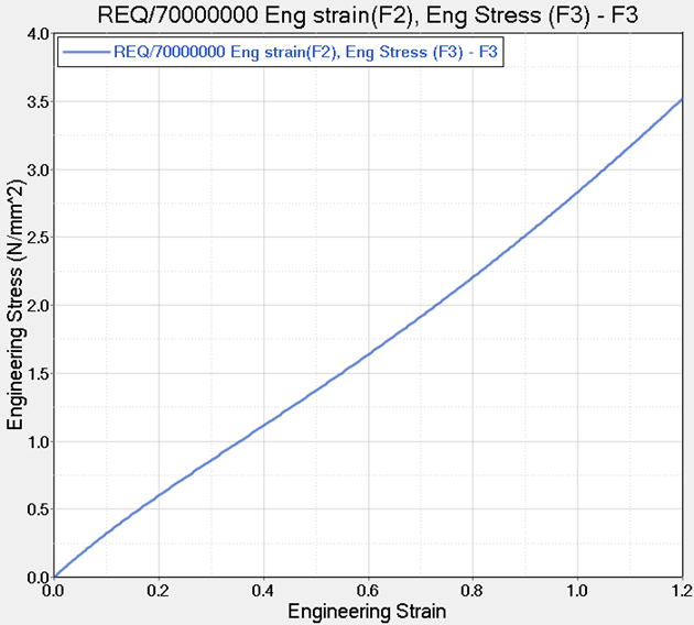

Plot Engineering Stress vs Engineering Strain by selecting the data shown in
Table 4 and Table 5 in HyperGraph.
Table 4. X-Axis Data X Type Expression X Request REQ/70000000 Eng strain(F2), Eng Stress(F3) X Component F2 Table 5. Y-Axis Data Y Type Expression Y Request REQ/70000000 Eng strain(F2), Eng Stress(F3) Y Component F3 Figure 10. Stress versus strain curve
