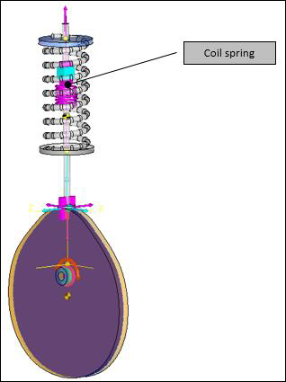

    In the Project Browser, the Model is organized using a CamFollower system, which contains the following:
    • A Cam, Follower, Joints, Graphics, and a Spring which make the complete topology.
    • The spring with a pre-load is acting between the Follower and Ground Body.
    Figure 2. Browser showing the model topology

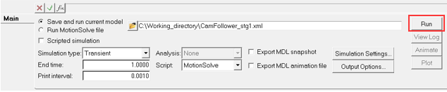

  4. Click the (Run) icon. In the panel, specify the settings shown in Figure 3. Then click Run.
    Figure 3.
    You will use the results from this initial run to compare with the NLFE spring model results.
  5. When the solver is finished, click Animate to visualize the animation.

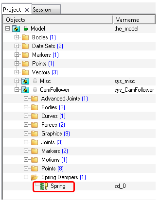

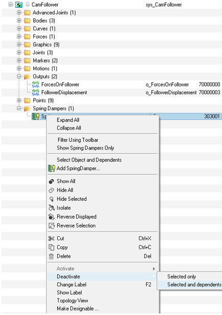

  1. In the Project Browser, right-click on the Spring and select Deactivate > Selected and dependents from the context menu.
    Figure 4.

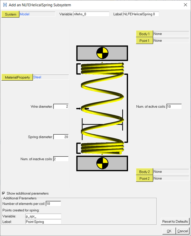

  2. In the Subsystems toolbar, click (NLFE Helical Spring Subsystem).
    Figure 6.
    Tip: This toolbar may not be turned on by default. From the menu bar, click View > Toolbars > MotionView and then click on the toolbar name to turn the display on/off.
  3. In the Add an NLFEHelicalSpring Subsystem dialog, assign an appropriate Label and Variable.
    Figure 7.

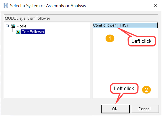

  4. Double-click on the parent System collector to bring up the Model Tree. Select CamFollower as the parent system.
    Figure 8.

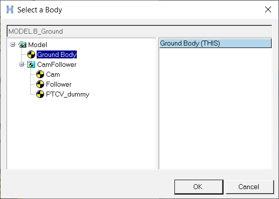

    1. For , select Ground Body.

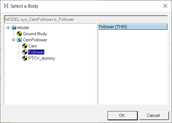

    3. For , select Follower.
      Figure 11.

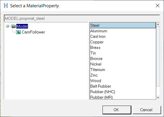

    5. For , select Steel.
      Figure 13.
  6. Fill in the spring parameters and details for label and varnames as shown in Table 1. Then click OK.
    Table 1.
    Spring Parameters
    Wire diameter Specify the coil spring wire diameter. 3
    Spring diameter Specify the coil mean diameter: center-tocenter. 20
    Num. of inactive coils Specify the inactive/dead coils at each end. 1
    Num. of active coils Specify the active coils which contribute to spring stiffness. 7
    Additional Parameters
    Number of elements per coils Specify the element density per coil. 10
    Variable Specify varname prefix for the spring profile points created. p_spr_
    Label Specify label prefix for the spring profile points created. Point Spring

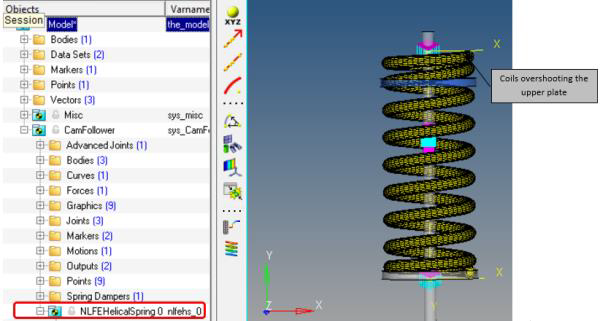

    The spring overshoots the upper plate as shown in Figure 15. This is because the spring has been created with no pre-load on it.

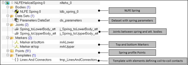

  7. Review the NLFE Spring systems added.
    The following entities are available in the system:
    • An NLFE Spring.
    • DataSet with spring parameters that were used to create the spring.
    • Fixed joints connecting the spring to the suspension.
    • Markers for reference.
    • Points that define the spring profile.
    • Template with unsupported elements. These are automatically created and include elements that define coil-to-coil contacts.
    Figure 16. NLFE spring topology in the browser

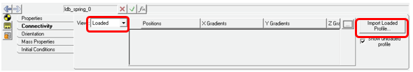

    1. Under the subsystem, select the NLFE Spring 0 body to open the body panel.
    2. From the Connectivity tab, in the View drop-down menu select the Loaded option.

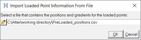

      This will show the Import Loaded Profile button, which you can use to load a .csv file containing the pre-loaded positions and gradients of the spring.
    3. Click the Import Loaded Profile button.
      Figure 17. NLFE Connectivity tab - Loaded View
    4. In the Import Loaded Points Information From File dialog, browse to your <working directory> and select PreLoaded_positions.csv.
      Figure 18.
    5. Click OK to import the loaded positions.

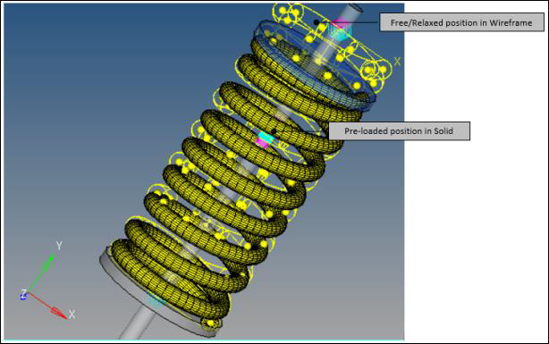

      The spring will be displayed in wireframe and solid. The one in wireframe is the No Load position (free/relaxed configuration) and the solid representation is that of pre-loaded spring.
      Note: Refer to the Appendix in the NLFE Body Panel – Connectivity Tab topic to learn how you can generate a preloaded position CSV file.
      Figure 19. Free/Relaxed and Pre-loaded position of the spring

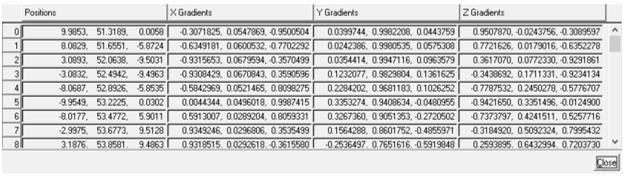

  9. Click the (Expansion) button to view the pre-loaded positions.
    Figure 20. Pre-loaded positions and gradients imported from the .csv file

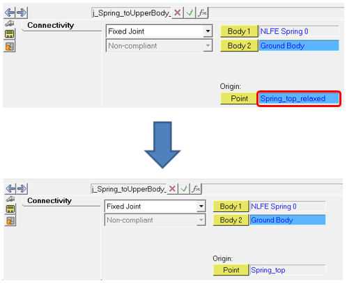

    The fixed joints created by the NLFEHelicalSpring Component utility will be at the free positions. You need to move one of these to the pre-loaded positions. Inspecting the spring positions reveals that the spring is compressed at the top while the bottom position is the same in both the configurations.
  10. Change the origin point of the joint Spring_toUpperBody_att in the NLFE Helical Spring 0 system from Spring_top_relaxed to Spring_top (in the parent CamFollower system).
    1. Under Origin, double-click the Point collector to display the model tree.
    2. Clear the Only show entities within valid scope check box.
    3. Select Spring_top using the model tree or in the graphics area (after closing the model tree).
    Figure 21. Changing the connection to pre-loaded position

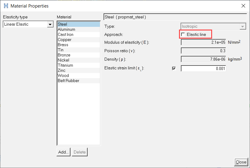

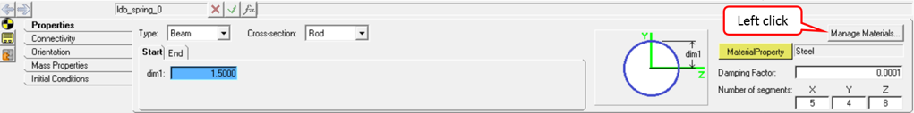

  11. From the Properties tab, click Manage Materials.
    The Material Properties dialog opens.
    Figure 22.
  12. Deselect the Elastic Line check box to capture non-linear effects due to deformation of the spring.
    The Elastic Line check box is selected by default for the Steel material.
    Figure 23.
  13. Click Close to exit the Material Properties dialog.

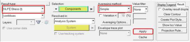

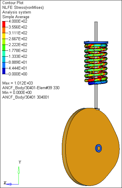

  5. Click the (Contour panel) icon to activate the Contour panel.
  6. In the panel, for Result type select NLFE Stress (t) and for Averaging method select Simple. Then click Apply.
    Figure 25. Viewing results in HyperView
    This will allow you to view the stress contours.
    Figure 26. Contours in HyperView

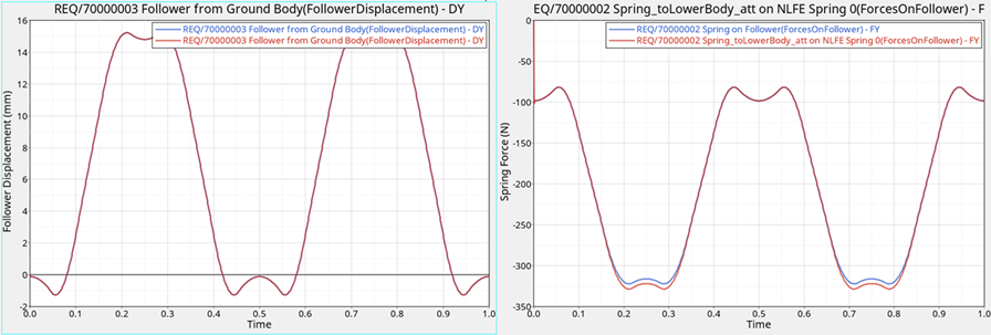

Compare Results
Now you will compare the results from the NLFE spring and the regular spring.
  1. Click to add a new page.
  2. Change the client to HyperGraph 2D .
  3. On the Page Window Layout toolbar, click > to split the window.

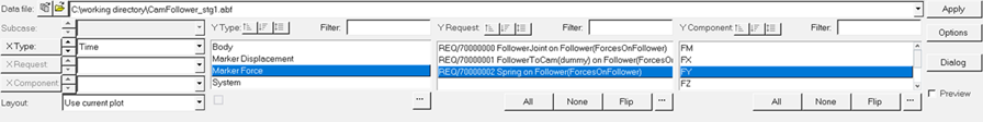

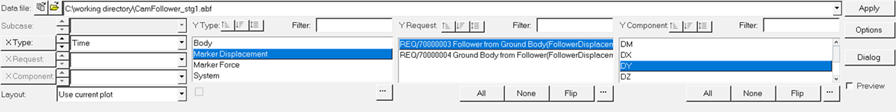

  4. In the left window, click and load the .abf file corresponding to the solver run with the original spring (created in the step Review the Model). Make the selections for the plot shown in Table 2 then click Apply.
    Table 2.
    X Type Time
    Layout Use current plot
    Y Type Marker Displacement
    Y Request REQ/70000003 Follower from Ground Body(FollowerDisplacement)
    Y Component DY
    Figure 27. Plot selections – Follower displacement
  5. In the right window, make the selections in Table 3 and click Apply.
    Table 3.
    X Type Time
    Y Type Marker Force
    Y Request REQ/70000002 Spring on Follower(ForcesOnFollower)
    Y Component FY
    Figure 28. Plot selections – Spring force on follower: regular spring

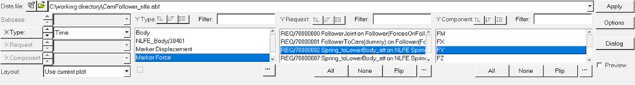

  6. In the left window, browse to the .abf file (created in step 4) to plot the corresponding displacement for the NLFE results.
  7. In the right window, make the selections shown in Table 4 and click Apply.
    Table 4.
    X Type Time
    Y Type Marker Force
    Y Request REQ/70000002 Spring_toLowerBody_att on NLFE Spring0(ForcesOnFollower)
    Y Component FY
    Figure 29. Plot selections – Spring force on follower: NLFE spring
  8. Apply axis labels and formatting as appropriate.
    The comparison is shown in Figure 30:
    Figure 30. Result comparison: Regular spring versus NLFE spring
    Upon closer inspection there are some differences in the results, especially in the Spring Forces. These could be attributed to the following reasons:
    • NLFE spring has mass and inertias associated with it as it is represented as a body. A regular spring is a force entity without any mass/inertias.
    • The difference in force outputs is particularly seen when the spring displacement is high. This is the point where the coil-to-coil contact happens. During this event, the effective number of coils reduces, thus increasing the spring stiffness marginally and hence the force outputs.
