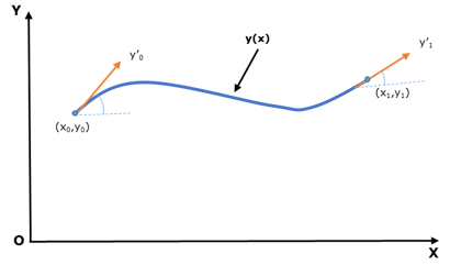

ANCF uses the shape function matrix, together with the nodal coordinates to describe arbitrary rigid body motion. For these reasons, the absolute nodal coordinate formulation leads to a constant mass matrix in two- and three-dimensional cases. The constant mass matrix simplifies the nonlinear equations of motion and, consequently, accelerates the time integration of the nonlinear equations of motion. Figure 1 shows a standard beam model[2] described in 2D plane using ANCF.Figure 1. Euler–Bernoulli beam element
Displacement field, y(x) = s1(x)y0+ s2(x)y’0 +s3(x)y1+ s4(x)y’1
- s1 to s4 are shape functions of beam.
- x0, y0, x1, and y1 are nodal coordinates of 2 grids.
- y’0 and y’1 are slope coordinates (gradients) at 2 grids.
