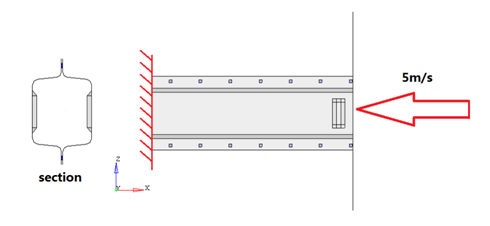

- Rigid body and Boundary conditions
One end of the crash box is modeled using a rigid body and this rigid body is completely fixed using translations and rotations.
- Rigid wall
The impactor is modeled using a moving rigid wall having a fixed velocity (5 m/s) in a X direction and is fixed for other translations and rotations.

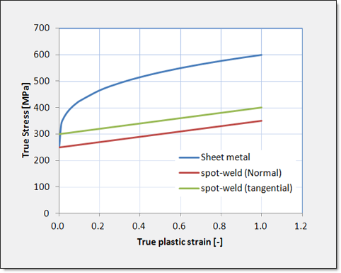

In this connection material (/MAT/LAW59) use stress - plastic strain curve to describe the material characters of spot-weld. With failure model (/FAIL/CONNECT) it is possible to use two different failure criteria to describe the failure of solid spot.
- Material Properties
- Value
- Initial density
- 7.8e-9 [Mg/mm3]
- Young's modulus
- 210000
- Failure relative displacement in normal direction
- 1.0
- Failure relative displacement in tangential plane
- 1.8
In this example a linear behavior of spotweld has just been assumed. For more accurate results, you can also put nonlinear behavior of spotweld through real physic test and CAE validation.

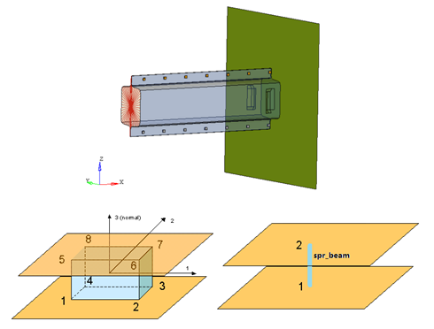

- /MAT/LAW59 to define the material
- /FAIL/CONNECT to define the rupture criteria
- /PROP/TYPE43 to define the spotweld property, which should be only used with /MAT/LAW59
- /INTER/TYPE2 to define the connection between spotweld and sheet metal

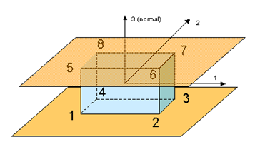

- In this spotweld modeling surface 1 (Node 1, 2, 3, and 4) and surface 2 (Node 5, 6, 7, and 8) are defined. The normal direction has been defined from surface 1 to surface 2.
- Surface 1 and 2 for each solid spotweld should always connect with a shell element. If one surface of one solid spotweld is not connected with a shell element, then the stiffness will not be computed correctly and an error may occur.

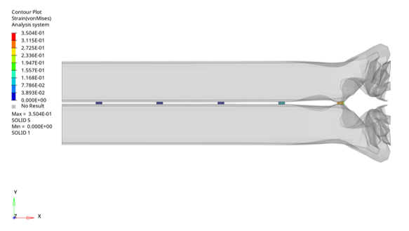

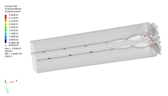

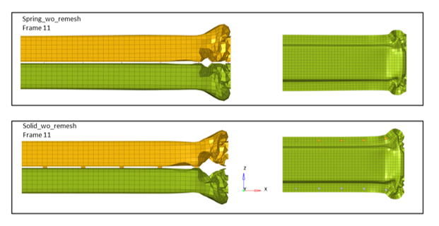

Here in the model you define max. relative displacement in normal direction EPS_N_MAX=1.0 in option /FAIL/CONNECT. Therefore, two solid spotwelds (circled in red) failed after reaching this criterion.

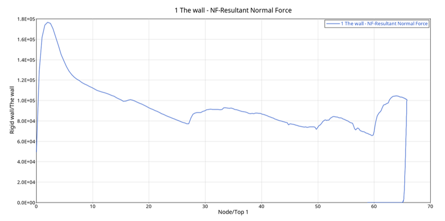

Compared with spring beam spotweld molding, the following performance could be observed:
- With coarse sheet metal mesh size, you got
similar deformation and similar Force versus Displacement curve for solid
spotweld modeling and spring beam spotweld modeling.
Figure 9.

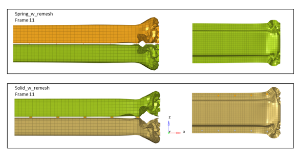

- Once you remesh the sheet metal shell element
with fine mesh size (for example with 2.5mm mesh size here), then you still
get similar deformation and Force versus Displacement curve in solid
spotweld modeling but not in spring beam spotweld modeling. This means less
sheet metal mesh size dependence for this new solid spotweld modeling.
Figure 10.
