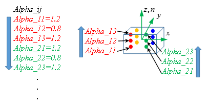

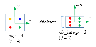

Example
In this example use:
/PROP/SHELL Ishell =12 ≥ must set ngp=4 (then i=4 in Alpha_ij).
/PROP/SHELL N=3 ≥ must set nb_integr=3 (then j=3 in Alpha_ij)
Then the yield stress scale factor Alpha_ij is as below. And there are totally Alpha_ij values.

Comments
  1. The nb_integr must be equal to the number of integration points given in the shell property. For composite property, the number of integration corresponds to the sum of the number of integration (or slices) of each ply or layers.
  2. The npg must be set according to the formulation which is used in the shell property.
  3. The number of values Alpha_ij given must be equal to n p g ⋅ n b _ i n t e g r .
    For i = 1
    • Alpha_11 for integration point = 1
    • Alpha_12 for integration point = 2
    • Alpha_1j for integration point = j
    For i = 2
    • Alpha_21 for integration point = 1
    • Alpha_22 for integration point = 2
    • Alpha_2j for integration point =j
    For i = npg
