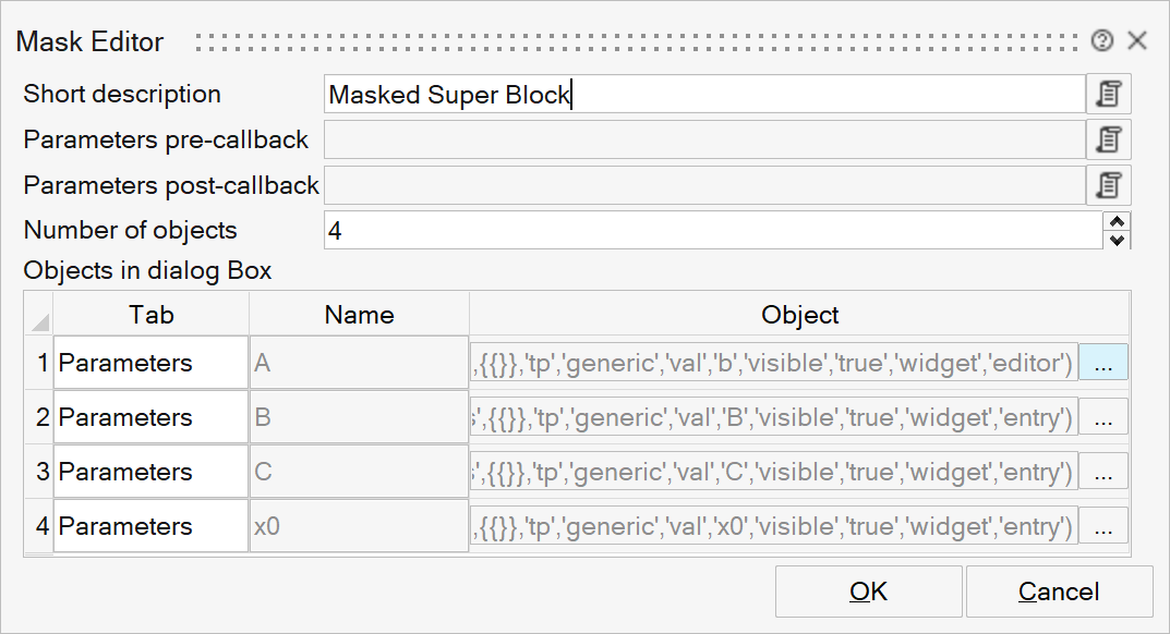

The Mask Editor dialog opens. It contains the following fields:
Short description: Enter a text description.
Parameters pre-callback: Enter an OML script to
update UI content or the block depending on parameters.
Parameters post-callback: Enter an OML script to
Number of objects: Enter a number of objects that
will be shown in the dialog when you open the Parameters of the masked
super block. The objects are shown in a table below this field. These
objects can be parameters, which are defined in the Parameter Creator
detailed below.

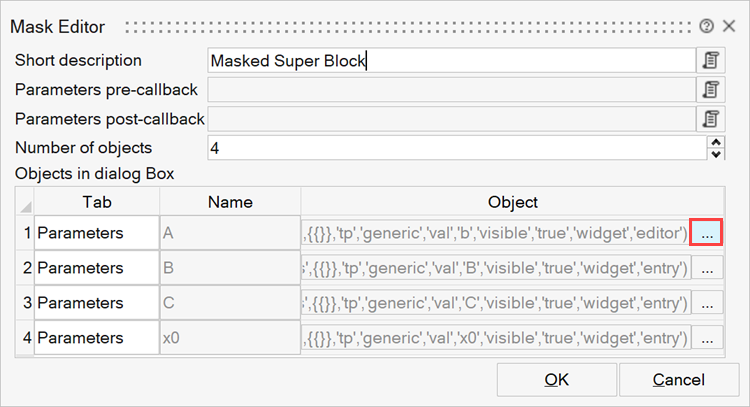

Parameters Creator
Define parameters in a masked super block.
When you edit a masked super block to add objects, you can define those objects as text,
buttons, or parameters.
To open the Parameters Creator, after you enter a value in the Number of
objects field in the Mask Editor dialog, click the
... button to the right of an object in the table.

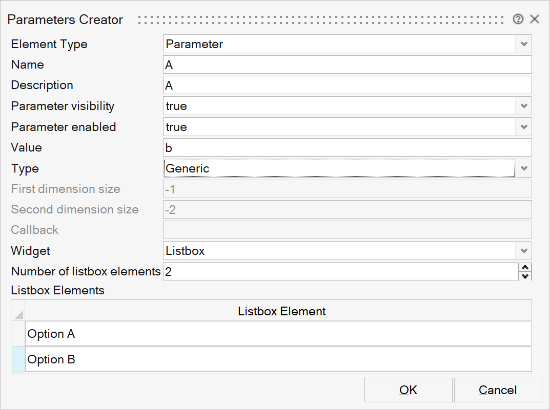

The Parameters Creator dialog contains the following fields:
Note: There are many options in the Parameters Creator, and not all fields are enabled
depending on which options you select. The following list does not necessarily cover
every possible combination of options.
Element Type: Options are Parameter,
Text, or Button. The Text option enables
only the Name and Value fields. The Button option enables the Name, Description,
Value, and Callback fields.
Name
Parameter visibility: Toggle whether the parameter is
visible.
Parameter enabled: Toggle whether the parameter can
used.
Value: The default value of the parameter.
Type: Options are Scalar,
Vector, Matrix, String,
Number, and Generic. Depending on which
type you select, other fields are enabled or disabled.
First dimension size: Defines the size of a vector or
matrix if you select those types.
Second dimension size: Defines the size of a matrix if
you select that type.
Callback: For widgets Editor and Disabled Editor (see
below), define the function called by the additional editor button.
Widget: Select the type of UI element associated with the
parameter. Options include:
Entry: Simple entry field.
Checkbox: Select or deselect the parameter.
Listbox: Select entries in a list. To define the
listbox options, enter a value in Number of listbox
elements and enter the option names in the table.
Combobox: Select entries in a combobox. To define the
combobox options, enter a value in Number of
subparameters and enter Names and Descriptions in the
table.
Radio button: Select radio button options. To define
the radio button options, enter a value in Number of
table.
Table: Table of subparameters. Define the number of
rows in Table row dimension. Define the
Number of table subparameters. Table
subparameters are effectively another layer of parameters. Click the
... button to open the Table Parameters
Creator, which contains a subset of the same fields as the Parameters
Creator dialog.
Editor: Adds a button to the right of the parameter
that opens a script editor.
Disabled Editor: Disables the parameter field and adds
a button to the right of the parameter that opens a script editor.

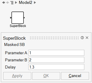

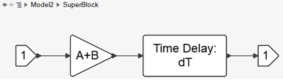

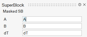

Super Block Diagram
Consider the following diagram, inside a Super Block named SuperBlock:
If the Super Block Context is empty, the parameters of this diagram are A,
B and dT. If the Super Block is masked, then the mask should
define these three parameters. Such a mask may look as follows:
The mask parameter names are not directly visible on the mask GUI; they can be made
visible by placing the cursor on top of the parameter description. In this case the
mask parameters are named A, B and dT. The parameter values are
defined by numerical values 1, 2 and 1.3. At this point the Super Block resembles a
library block; the mask parameters are essentially local, private variables of the
block, transparent to the user.

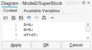

It should be emphasized that this model contains now two parameters named A,
having the same value. The same is true for B and dT. Semantically,
the presence of this mask is equivalent to placing the following instructions in the
Context of the Super Block:

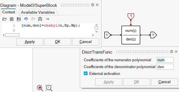

Creating a New Block with a Digital Chebyshev Filter
Consider the creation of a new block that implements a digital Chebyshev filter of
type I, based on the OML function cheby1. This function computes the
numerator and the denominator of the discrete transfer function of the filter based
on the order of the filter, its attenuation factor, and its cut-off frequency. The
Chebyshev block does not exist in Twin Activate but the discrete transfer function does.
So, a Chebyshev block can be constructed as a masked Super Block as follows:

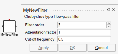

The new block can now be created by auto-masking this Super Block, and editing the
mask to provide a description for the block, and, descriptions and default values
for the parameters:
This block can now be used as such in the model or be placed in a library for wider
usage.
