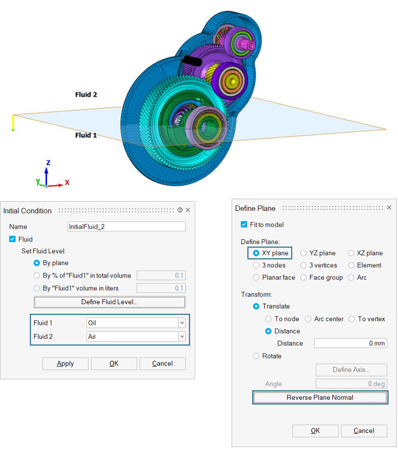

Boundary Conditions
Initial Condition
Analysis ribbon > Boundary Conditions > Initial Condition
Initial Condition is used to define and create the fluid (liquid and gas) regions inside the container. This is useful when the CAD or FE model does not have a separate body for the fluids. The fluid option will be displayed based on single-phase (one fluid) and multiphase (two fluids) options in the Solution panel.
The fluids can be generated using By plane, By percentage of "Fluid1" in total volume or By "Fluid1" volume in liters.
Figure 1. Initial Condition definition in SimLab

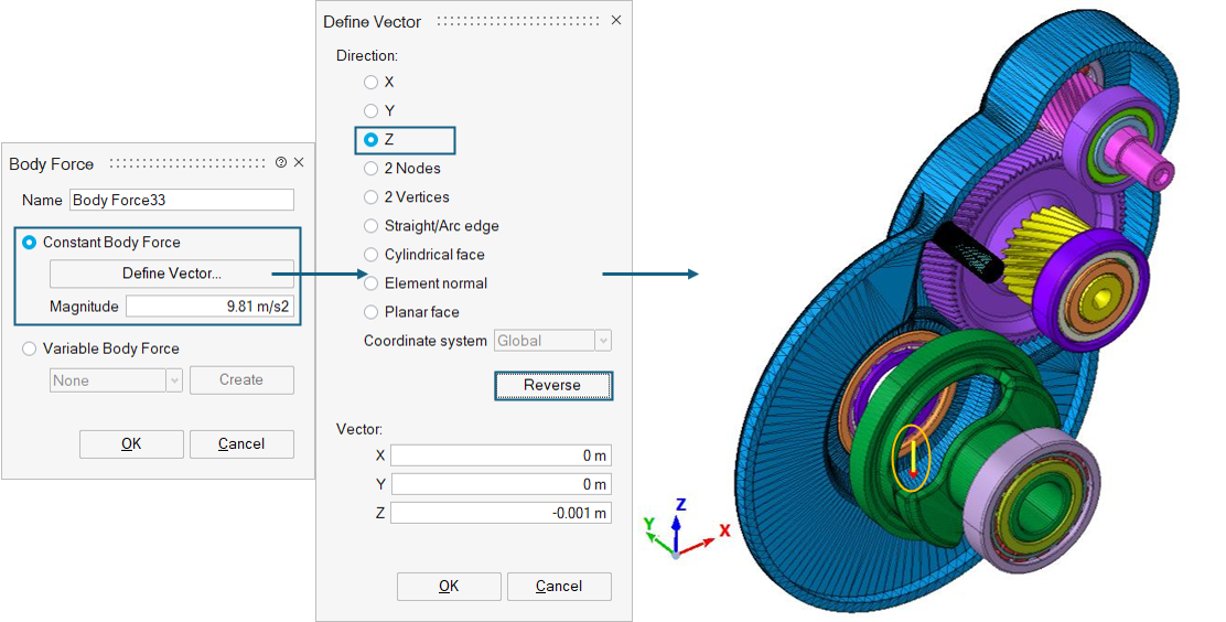

Analysis ribbon > Boundary Conditions > Body Force
This option is used to define body force for simulation. For Constant Body Force, the vector and magnitude must be specified. By default, the magnitude is 9.81 m/s2. It can be specified in the desired direction using a vector.
Figure 2. Constant Body Force definition in SimLab

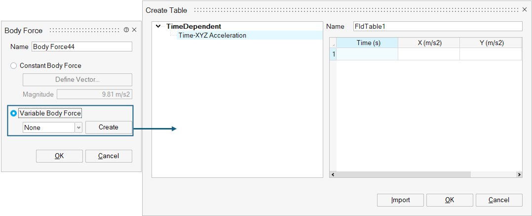

For Variable Body Force a time versus acceleration table will be defined. Define the table in the Create Table window or import a predefined table (*.txt-file).
Figure 3. Variable Body Force definition in SimLab

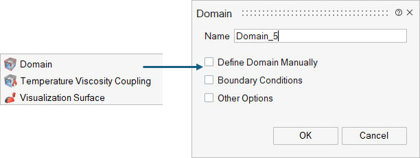

Analysis ribbon > Boundary Conditions > Domain
This tool is used to define the domain and global parameters of the nanoFluidX case for a typical drivetrain simulation. If the simulation is of a closed geometry (such as a gearbox) nanoFluidX will automatically calculate the domain dimensions, so it does not need to be specified.
Figure 4. Domain definition SimLab menu
Define Domain Manually
If the simulation has an open boundary, or if there are periodic boundary conditions associated with the domain, it is necessary to manually prescribe the size of the domain (bounding box). In this case the padding around the particles should be set to 3*dx.
Boundary Conditions
These domain parameters are used to define the boundary conditions at minimum and maximum boundary. Boundary options supported are Periodic and Simple Outlet (default).

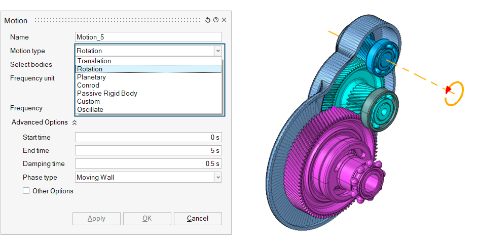

Analysis ribbon > Boundary Conditions > Motion
Wall boundary particles can be moved during a simulation with a prescribed motion, where in principal a motion for a specific phase/ body is defined and applied within a given time frame.
Motion types that can be specified are Translation, Rotation, Planetary, Conrod, Passive Rigid Body, Custom, and Oscillate motion.
Figure 5. Motion definition in SimLab

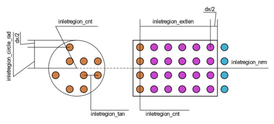

Inlet Stencil
Inlet stencil is created for the inlet region which behaves as a source of particles and will be exported as a .txt file for the inlet region containing the x-, y-, and z- coordinates of the particles which are to be inserted into the domain.
The spacing of the stencil must match the dx value used for the rest of the simulation.
Figure 7.
Important: When the stencil is generated, it will be placed in a model named InletRegionsProbes.gda. The stencils must remain in the model. Otherwise, they will not be exported correctly. This model is always exported to the .cfg, regardless of whether it is displayed during export.
Check the stencil against the wall particles to ensure there are no overlaps or penetrations. The figure below shows an example of a misaligned stencil and conduit.
Figure 8.
As the fluid particles leave the extension, the distance between fluid-fluid particles and fluid-wall particles are not similar. This results in a pressure rise on the side where fluid particles are closer to the wall. Depending on the severity of the misalignment, this may result in undesired secondary flows.
Inlet Extension
The extension imposes the inlet velocity and ensures the distance between different spawn layers remaining at dx. As a result, extension is an important component of the Inlet region.
The extension covers up to half dx, further in each direction than the definitions given in the *.cfg to ensure all spawned Inlet region particles are covered. The fluid particles within the extension have the same velocity as the inlet region. It is important that the spawn area is not disturbed by other fluid particles. The extension only applies to the fluid phase specified for that specific inlet region.

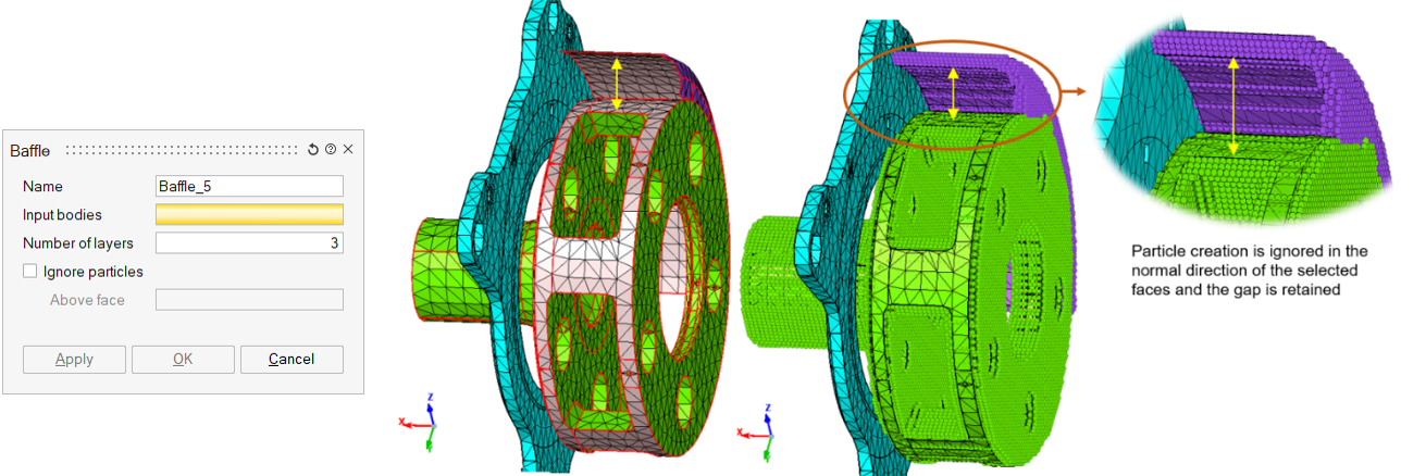

Baffle
Analysis > Boundary conditions > Baffle
This tool is used to create baffles (thin sections/ sheet bodies) as boundary conditions. While creating particles, these baffle bodies will be automatically created as particles. A number of layers of particles (default = 3) are created inside the volume. The option Ignore Particles is used to ignore the particle creation in the normal direction of the selected faces.
