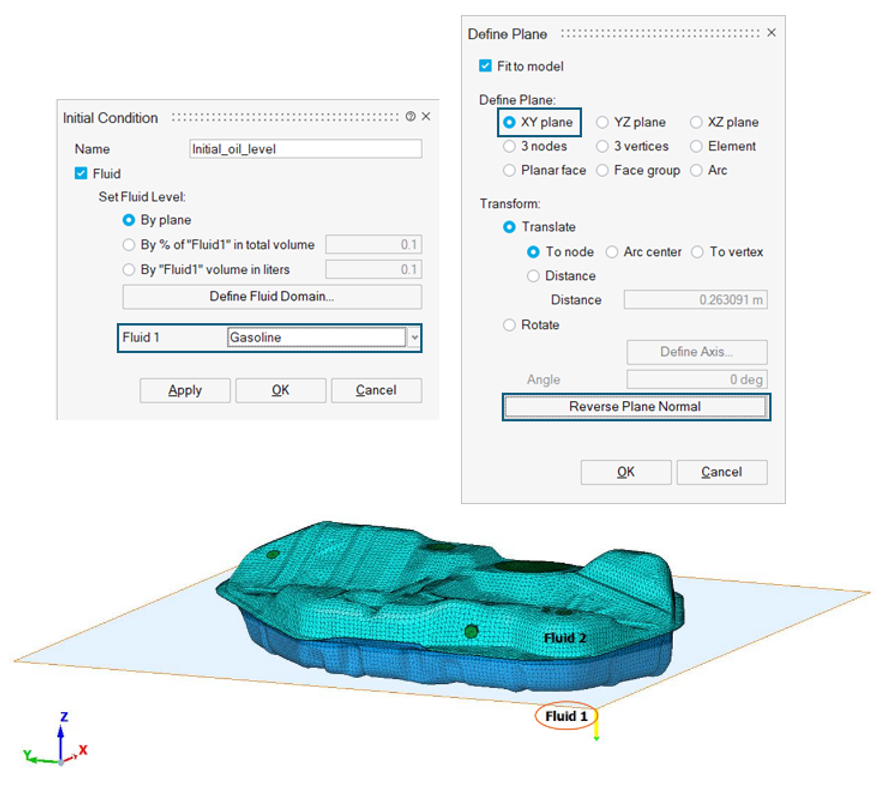

Initial condition is used to define and create the fluid (liquid and gas) regions inside the container. This is useful when the CAD or FE model does not have a separate body for the fluids. The fluid option will be displayed based on single-phase (one fluid) and multiphase (two fluids) options in the Solution panel.
The fluids can be generated using By plane, By % of "Fluid1" in total volume, or By "Fluid1" volume in liters.
Figure 1. Initial condition definition

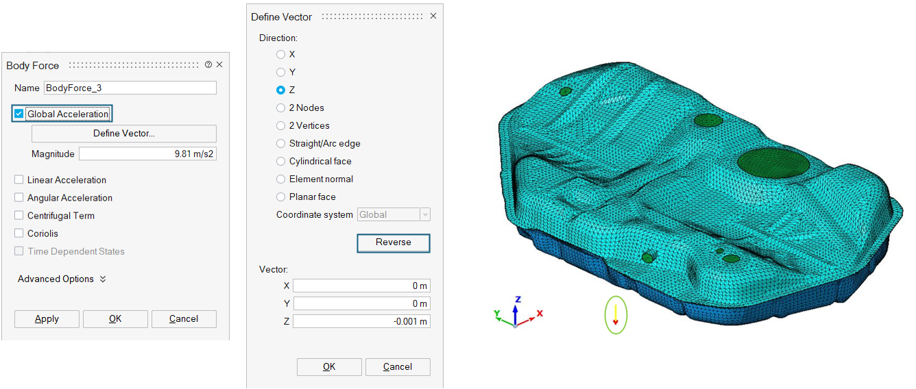

This option is used to define body force for a simulation. For Global Acceleration, the vector and magnitude must be specified. By default, the magnitude is 9.81 m/s2. It can be specified in the desired direction using a vector.
Figure 2. Global acceleration definition

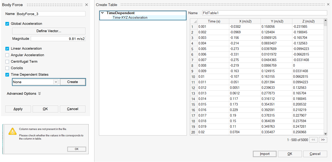

For the Time Dependent body force with different acceleration terms, a time versus acceleration table must be established. This table can be defined within the Create Table window or imported from an external source in the form of a predefined *.txt file.
Figure 3. Definition of Time Dependent body force with different acceleration terms
