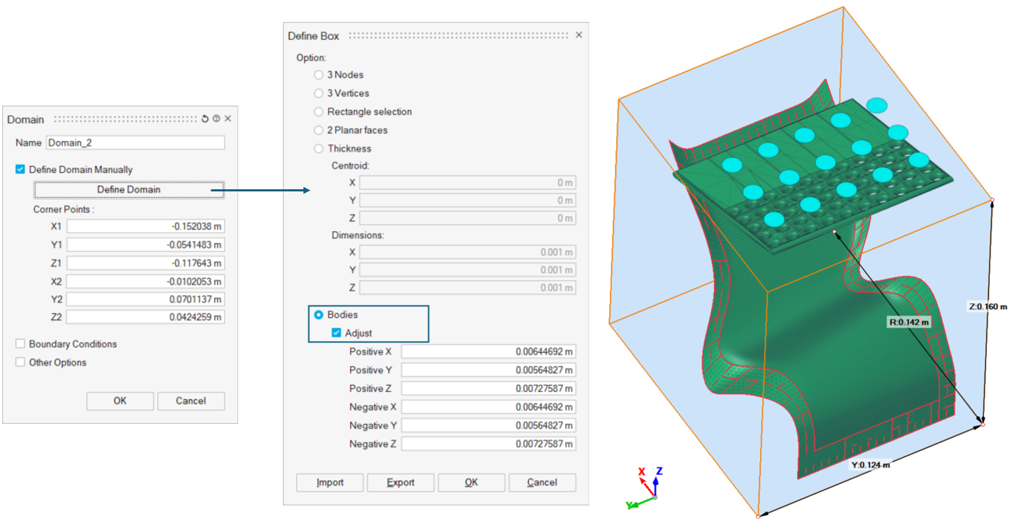

This tool is used to define the domain and global parameters of the nanoFluidX case. For a typical drivetrain simulation. If the simulation is of a closed geometry (such as a gearbox) nanoFluidX will automatically calculate the domain dimensions, so it does not need to be specified.
For other cases, especially those with open boundaries, the domain size and/or reference values should be specified.
Define Domain Manually
If the simulation has an open boundary, or if there are periodic boundary conditions associated with the domain, it is necessary to manually prescribe the size of the domain (bounding box). In this case the padding around the particles should be set to 3*dx.
  • Boundary Conditions: These domain parameters are used to define the boundary conditions at minimum and maximum boundary. Boundary options supported are Periodic and Simple Outlet (default).

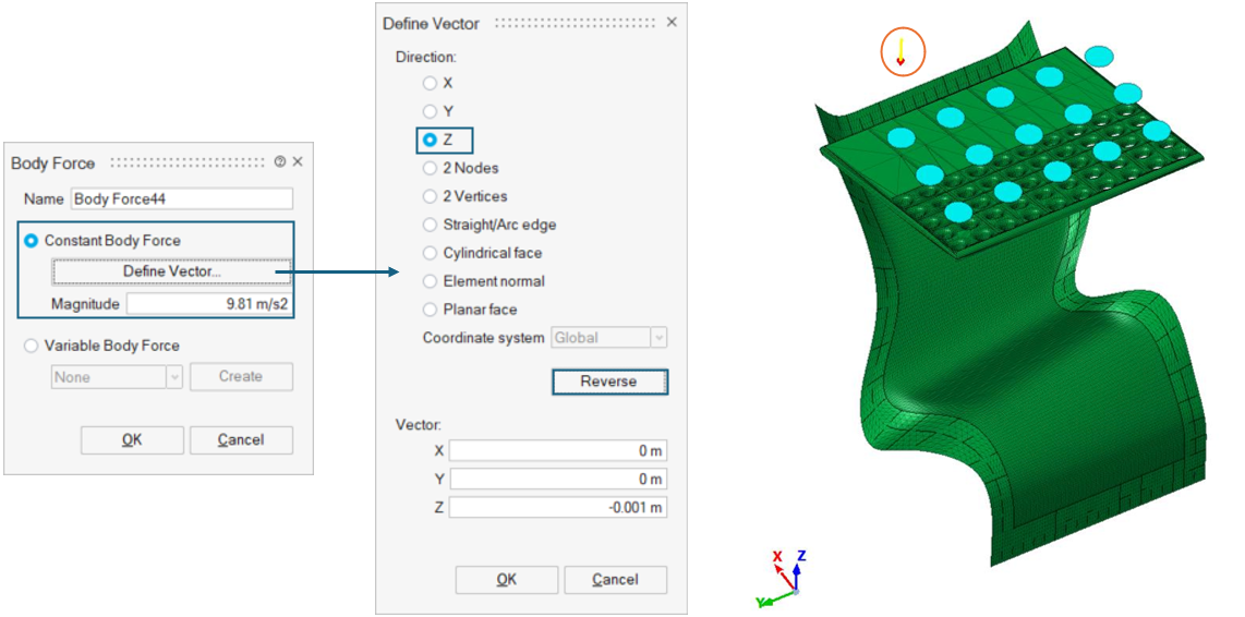

This option is used to define body force for simulation. For Constant Body Force, the vector and magnitude must be specified. By default, the magnitude is 9.81 m/s2. It can be specified in the desired direction using a vector.
Figure 2. Define Constant Body Force in SimLab
For Variable Body Force a time versus acceleration table will be defined. Define the table in the Create Table window or import a predefined table (*.txt-file).

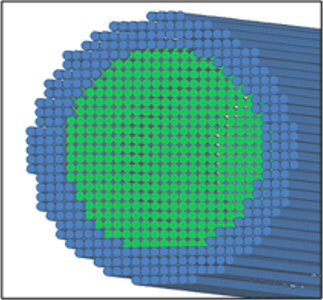

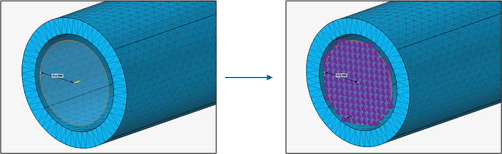

Inlet stencil is created for the inlet region which behaves as a source of particles and will be exported as a .txt file for the inlet region containing the x-, y-, and z- coordinates of the particles which are to be inserted into the domain.
The spacing of the stencil must match the dx value used for the rest of the simulation.
Figure 4.
Important: When the stencil is generated, it will be placed in a model named InletRegionsProbes.gda. The stencils must remain in the model. Otherwise, they will not be exported correctly. This model is always exported to the .cfg, regardless of whether it is displayed during export.
Check the stencil against the wall particles to ensure there are no overlaps or penetrations. The figure below shows an example of a misaligned stencil and conduit.
Figure 5.
As the fluid particles leave the extension, the distance between fluid-fluid particles and fluid-wall particles are not similar. This results in a pressure rise on the side where fluid particles are closer to the wall. Depending on the severity of the misalignment, this may result in undesired secondary flows.
