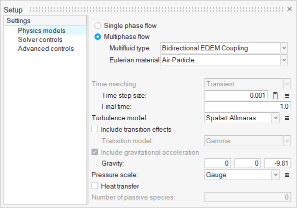

  1. From the Flow ribbon, click the Physics tool.
    Figure 6.
    The Setup dialog opens.
  2. Under the Physics models setting, select the Multiphase flow radio button.
  3. Change the Multifluid type to Bidirectional EDEM Coupling.
  4. Click the Eulerian material drop-down menu and select Material Library from the list.
    You can create new material models in the Material Library.
  5. In the Material Library dialog, select EDEM 2 Way Multiphase, switch to the My Material tab, then click to add a new material model.
  6. In the microdialog, click EDEM Bidirectional Material in the top-left corner and change the name to Air-Particle.
  7. Set the Carrier field to Air (if not set already).
  8. Set the drag model and the drag coefficients as shown in the figure below.
    Figure 7.
  9. Close the material model microdialog and then close the Material Library dialog.
  10. In the Setup dialog, set the Eulerian Material to Air-Particle.
  11. Set Time step size and Final time to 0.001 and 1, respectively. Select Spalart-Allmaras for the Turbulence model. Verify that Gravity is set to 0, 0, -9.81, as shown below.
    Figure 8.

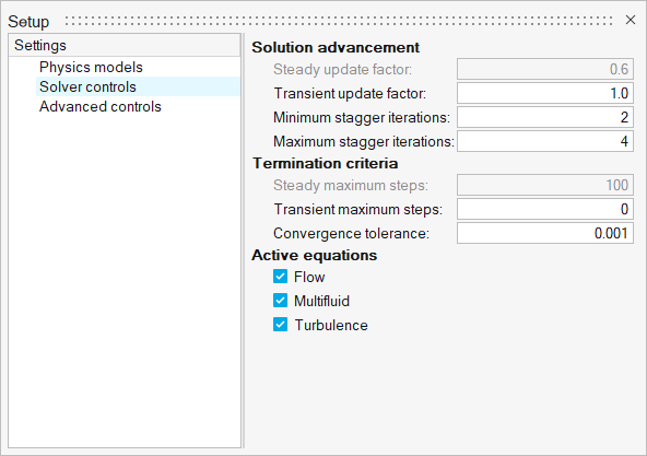

  12. Click the Solver controls setting and set the Minimum and Maximum stagger iterations to 2 and 4, respectively.
    Figure 9.
  13. Close the dialog and save the model.

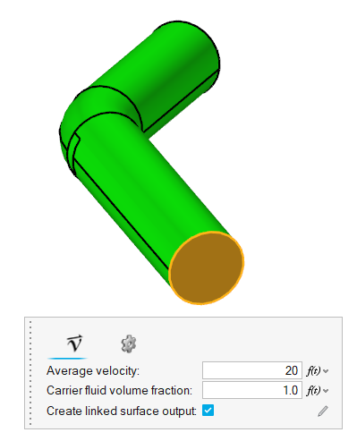

  1. From the Flow ribbon, Profiled tool group, click the Profiled Inlet tool.
    Figure 11.
  2. Click on the inlet face highlighted in the figure below. In the microdialog, enter a value of 20 m/s for the Average velocity and set the Carrier fluid volume fraction to 1.0.
    Figure 12.
  3. On the guide bar, click to execute the command and exit the tool.

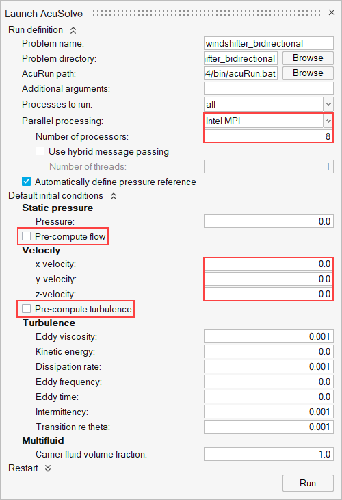

  2. Return to HyperMesh CFD.
  3. From the Solution ribbon, click the Run tool.
    Figure 35.
    The Launch AcuSolve dialog opens.
  4. Set the Parallel processing option to Intel MPI.
  5. Optional: Set the number of processors to 4 or 8 based on availability.
  6. Expand Default initial conditions, uncheck Pre-compute flow and set the velocity values to 0. Uncheck Pre-compute Turbulence.
  7. Click Run to launch AcuSolve.
    Figure 36.

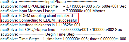

    If the coupling between AcuSolve and EDEM is successful, a message will be printed in the AcuSolve Log file before the first time step.
    Figure 37.

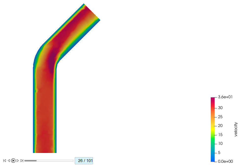

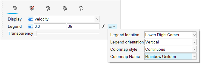

  9. In the display properties microdialog, set the display to velocity and activate the Legend toggle.
  10. Change the upper bound of the legend to 36.
  11. Click and set the Colormap name to Rainbow Uniform.

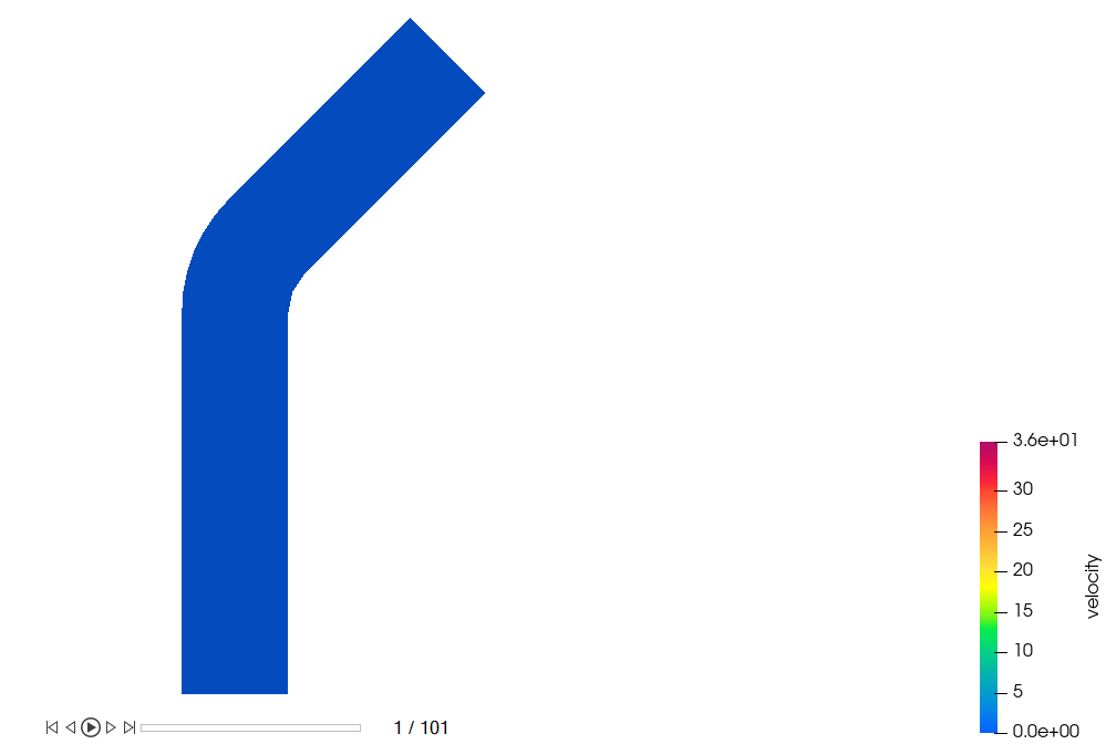

    Figure 41.
  12. Click on the guide bar.
    The velocity contour should look like the one shown below at the beginning of the simulation.
    Figure 42.

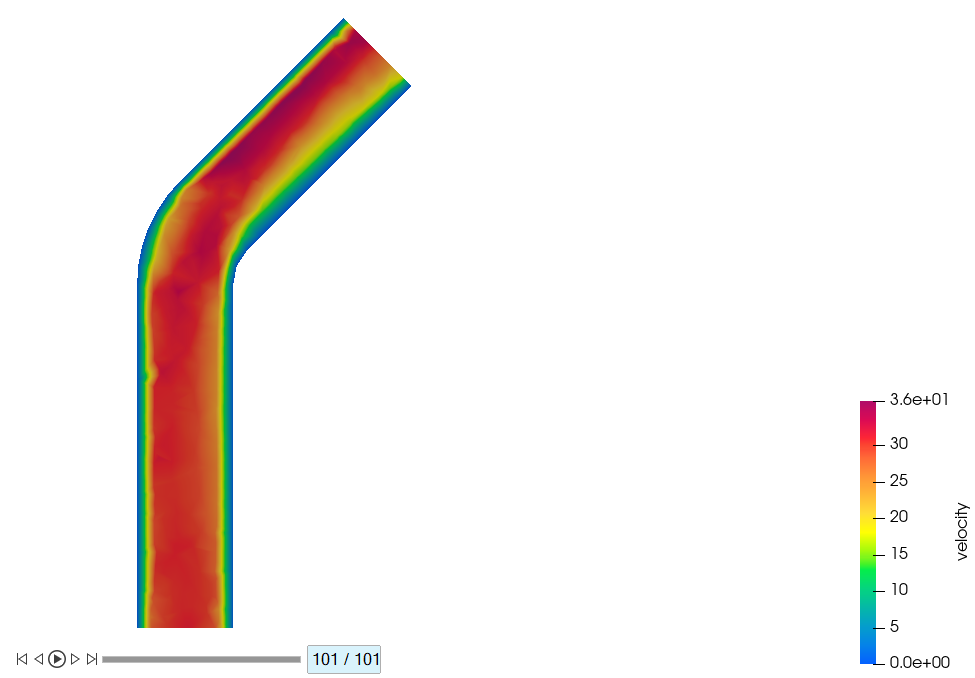

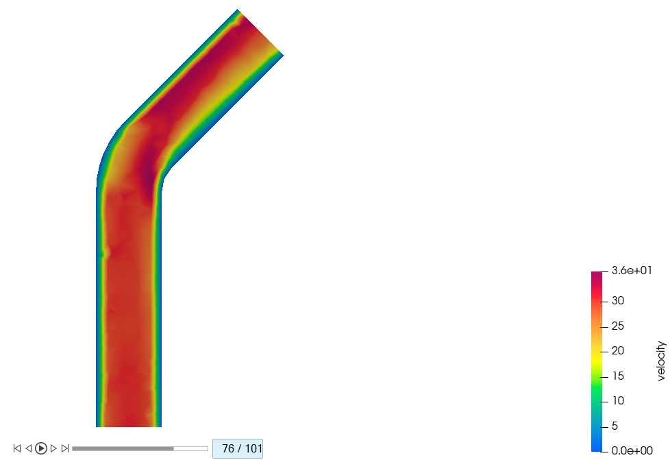

  13. Plot the contours at 0.25s, 0.5s, 0.75s, and 1.0s by dragging the slider on the bottom to the 26th, 51th, 76th, and 101st frames.
    Figure 43.
    Figure 44.
    Figure 45.
    Figure 46.

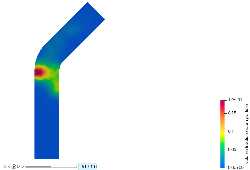

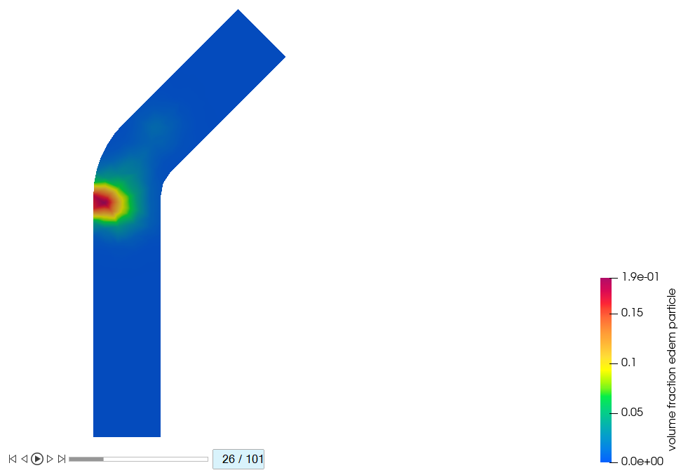

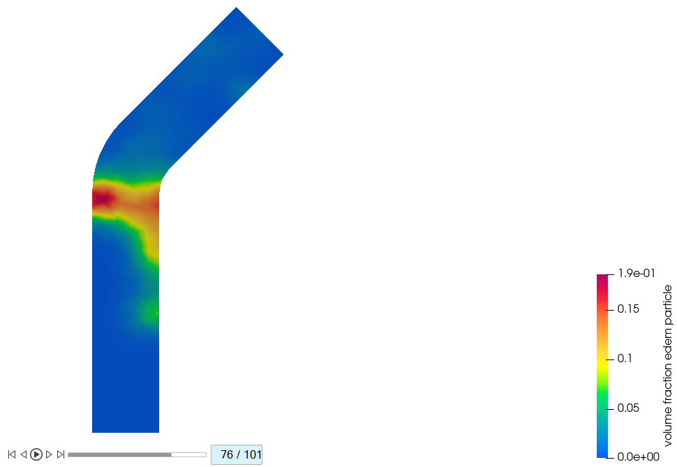

  15. In the microdialog, change the Display variable from velocity to volume fraction edem particle and set the upper bound of the legend to 0.186.
  16. Click on the guide bar.
    Figure 47.
  17. Plot the contours at 0.5s (step=51/101), 0.75s (step=76/101), and 1.0s (step = 101/101) to see the volume fraction edem particle distribution inside the fluid domain.
    Figure 48.
    Figure 49.
    Figure 50.

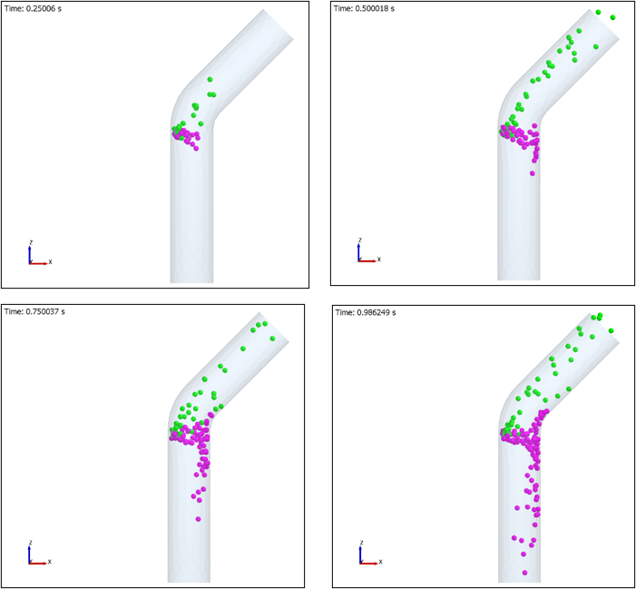

  10. You can also plot the results at different timesteps by clicking the drop-down menu.
    Figure 57.
    For the current case, the results are plotted at 0.25s, 0.5s, 0.75s, and 0.98s to see the particle distribution inside the fluid domain at both inlet and outlet.
    Figure 58.
    Observe that the lighter particles (green) get carried by the fluid and escape the domain through the outlet at the top and the heavier particles (magenta) stay inside the domain for a longer time while some of them fall through the bottom of the pipe.

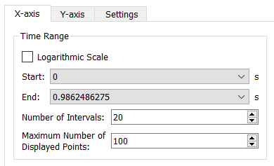

  13. Click the X-axis tab and verify that the values are set as shown in the figure below.
    Figure 59.

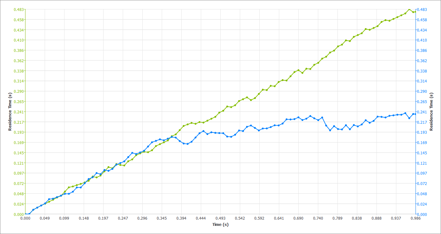

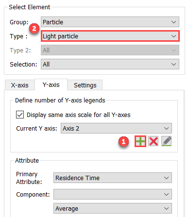

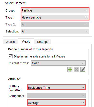

  14. Click the Y-axis tab. Create a plot of average residence time of the heavy particle over the simulation time by setting the values as shown in the figure below.
    Figure 60.
  15. Click to add another Y-axis and set the Type to Light particle.
    Figure 61.
  16. Leave all the other options unchanged and then click Create Graph to create a plot of average residence time of both the particles.
    Figure 62.
    The plot in green is for the heavier particles and it can be observed that the average residence time is higher for the heavier particles compared to the lighter particles (blue).
