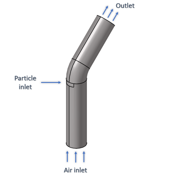

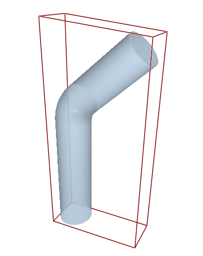

The problem to be solved is shown schematically in Figure 1. It is a windshifter model in which air enters the domain from the inlet at the bottom at a velocity of 20 m/sec and exits through the outlet. The temperature of the incoming fluid is 293 K. Particles at a temperature of 363 K are introduced into the fluid domain. As the particles move through the fluid domain, they exchange energy with the surrounding fluid and as a result their temperature drops down before they exit the fluid domain. The walls of the pipe are maintained at a constant temperature of 293 K.
The model consists of a cylindrical pipe with a 45-degree bend. The radius of the pipe is 0.25 m and the particle inlet is located midway through the length of the pipe.

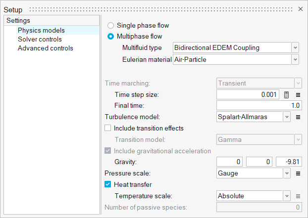

  2. Under the Physics models setting, select the Multiphase flow radio button.
  3. Change the Multifluid type to Bidirectional EDEM Coupling.
  4. Click the Eulerian material drop-down menu and select Material Library from the list.
    You can create new material models in the Material Library.
  5. In the Material Library dialog, select EDEM 2 Way Multiphase, switch to the My Material tab, then click to add a new material model.
  6. In the microdialog, click EDEM Bidirectional Material in the top-left corner and change the name to Air-Particle.
  7. Set the Carrier field to Air (if not set already).

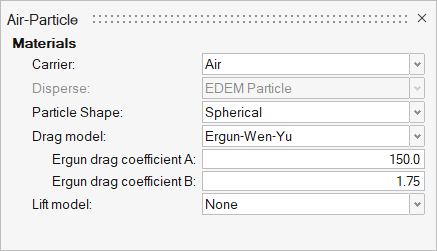

  8. Set the drag model and the drag coefficients as shown in the figure below.
    Figure 6.
  9. Close the material model microdialog and then close the Material Library dialog.
  10. In the Setup dialog, set the Eulerian Material to Air-Particle.
  11. Set Time step size and Final time to 0.001 and 1, respectively. Select Spalart-Allmaras for the Turbulence model.
  12. Verify that Gravity is set to 0, 0, -9.81.
  13. Activate the Heat transfer checkbox.

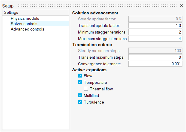

  14. Click the Solver controls setting and set the Minimum and Maximum stagger iterations to 2 and 4, respectively.
    Figure 8.
  15. Close the dialog and save the model.

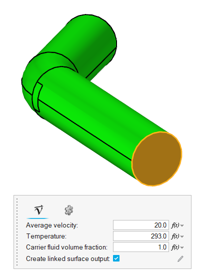

  1. From the Flow ribbon, Profiled tool group, click the Profiled Inlet tool.
    Figure 10.
  2. Click on the inlet face highlighted in the figure below. In the microdialog, enter a value of 20 m/s for the Average velocity, 293 K for Temperature, and 1.0 for the Carrier fluid volume fraction.
    Figure 11.
  3. On the guide bar, click to execute the command and exit the tool.

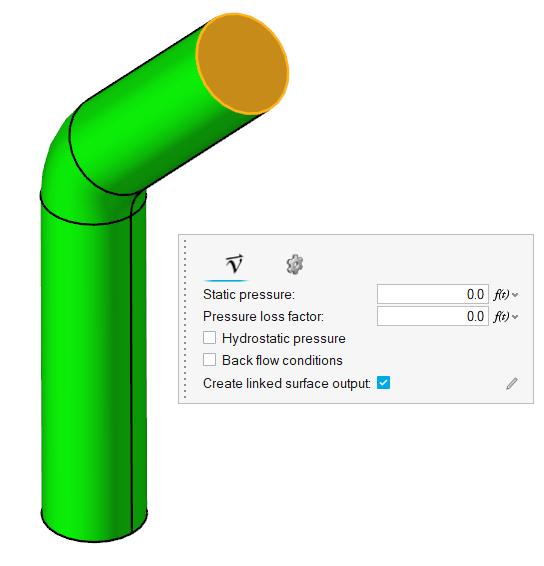

  4. Click the Outlet tool.
    Figure 12.
  5. Select the face highlighted in the figure below and then click on the guide bar.

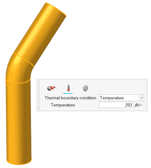

  8. In the microdialog, click the Temperature tab and set the parameters as shown in the figure below.
    Figure 15.

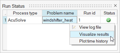

    The Run Status dialog opens. Once the run is complete, the status is updated and you can close the dialog.
    Tip: Right-click the mesh job and select View log file to view a summary of the meshing process.

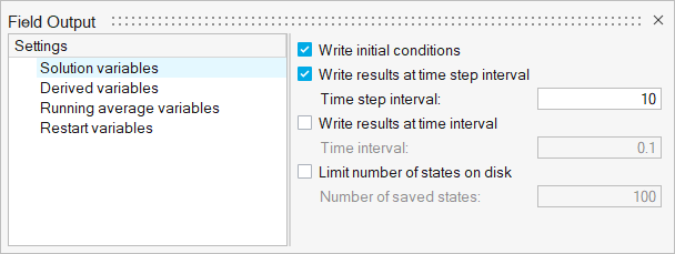

  1. From the Solution ribbon, click the Field tool.
    Figure 19.
    The Field Output dialog opens.
  2. Check the box for Write Initial Conditions.
  3. Set the Time step interval to 10.
    Figure 20.

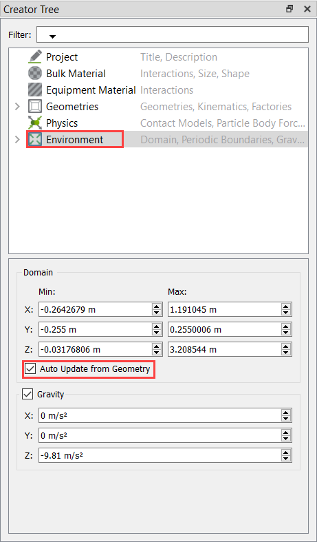

  3. Click the Environment tab under the Creator Tree, uncheck Auto Update from Geometry, and then check the box again to fit the geometry within the boundary.
    Figure 21.
    Figure 22.

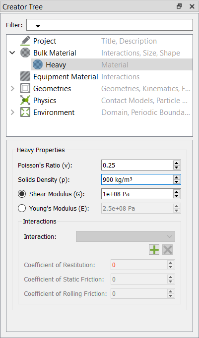

  1. In the Creator Tree, right-click Bulk Material and select Add Bulk Material.
  2. Rename the material to Heavy.
  3. In the Creator Tree, set the Solids Density property to 900 kg/m3.
    You will use the default values for other properties for this tutorial.
    Figure 23.

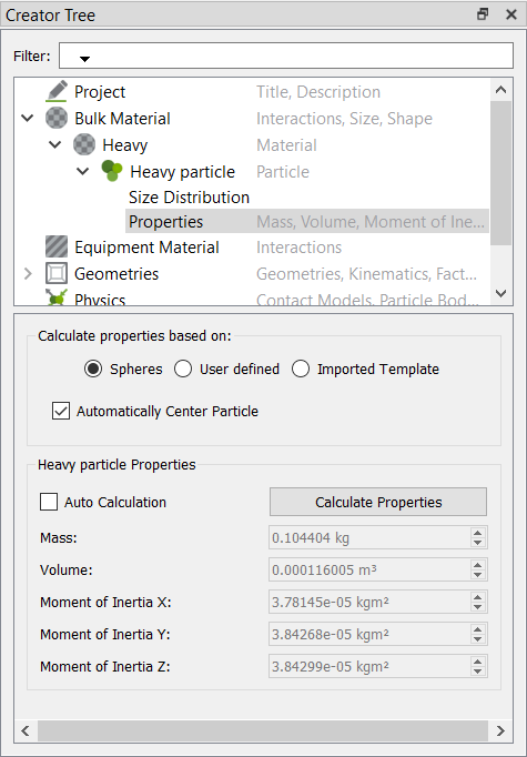

  4. Click below Interaction to define the interaction properties for collisions among the heavy particles. In the dialog, click OK.
  5. In the Creator Tree, right-click Heavy and select Add Shape from Library > Dual Sphere Shape.
  6. Rename the particle to Heavy particle.

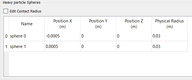

  7. Under Heavy particle, click Properties.
  8. In the Heavy particle Spheres panel, set the Physical Radius of both the spheres to 0.03 m and press Enter.
    Figure 24.
  9. In the Creator Tree, click Calculate Properties.
    Figure 25.

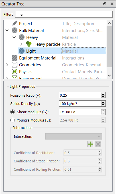

  10. In the Creator Tree, right-click Bulk Material and select Add Bulk Material.
  11. Rename the material to Light.
  12. In the Creator Tree, set the Solids Density property to 100 kg/m3.
    Figure 26.

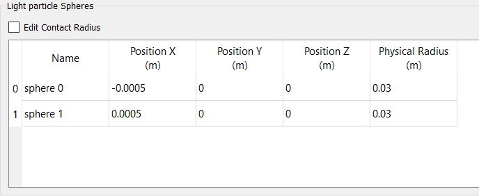

  15. In the Creator Tree, right-click Light and select Add Shape from Library > Dual Sphere Shape.
  16. Rename the particle to Light particle.
  17. Under Light particle, click Properties.
  18. In the Light particle Spheres panel, set the Physical Radius of both the spheres to 0.03 m and press Enter.
    Figure 27.

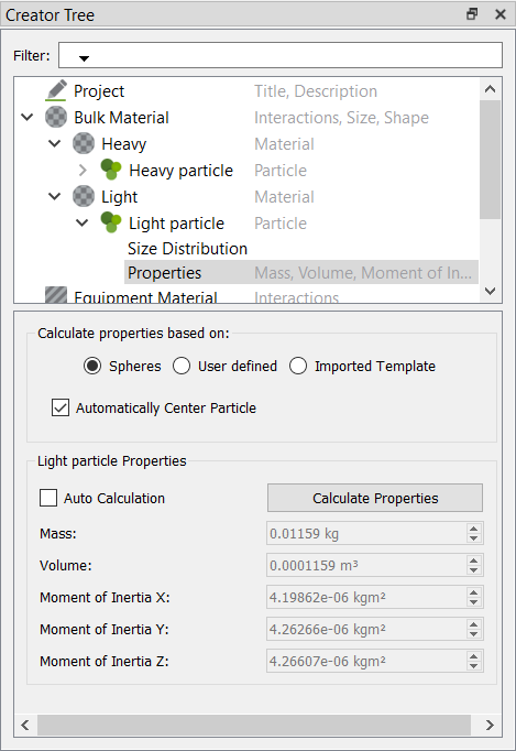

  19. In the Creator Tree, click Calculate Properties.
    Figure 28.

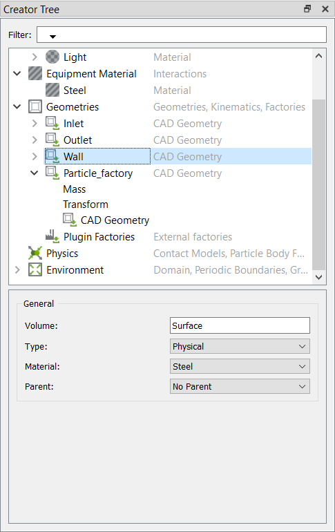

  5. Click the Wall geometry section, set the Type to Physical, and the Material to Steel (if not set already).

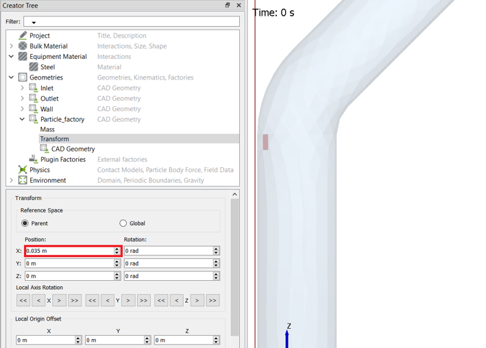

  8. Under Particle_factory, click Transform. Set the X-Position to 0.035 m.
    Figure 30.
    Note: Set the Opacity value to 0.2 to see the transformed surface location inside the pipe geometry.
    This is done to make sure that the particles are generated inside the fluid domain.

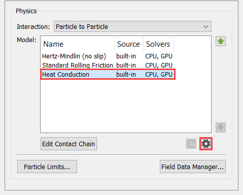

  1. In the Creator Tree, click Physics.

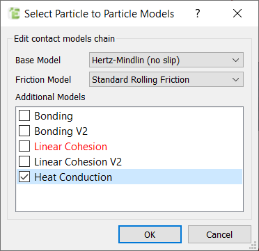

  2. Set the Interaction drop-down to Particle to Particle and click Edit Contact Chain.
  3. In the dialog, activate Heat Conduction and click OK.
    Figure 31.
  4. In the Physics tab, click Heat Conduction and then click .

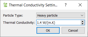

  5. In the dialog, set the Thermal conductivity of both Heavy and Light particles to 1.4 W/mK and then click OK.
    Figure 33.

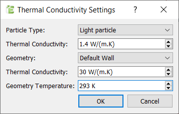

  9. In the dialog, set the thermal conductivity of the particles to 1.4 W/mK and the conductivity and temperature of the wall to 30 W/mK and 293 K, respectively. Click OK.

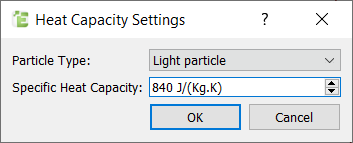

  14. In the dialog, set the specific heat capacity for both the particle types to 840 J/kgK and then click OK.

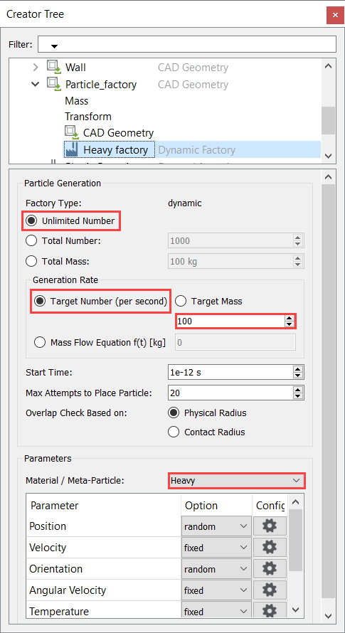

  1. In the Creator Tree, right-click Particle_factory and select Add Factory.
  2. Rename the new factory to Heavy factory.
  3. Set the particle generation parameters as shown in the figure below.
    Figure 36.
  4. Click besides Velocity, set the X-velocity to 1 m/s, and then click OK.
  5. Click besides Temperature, set the value to 363 K, and then click OK.
    Note: The fields for Temperature and Heat Flux will not be visible unless heat transfer properties are defined.

  2. Activate the checkbox for Auto Update from Geometry (if not already selected).
    When a moving particle touches the bounding faces of the domain (environment), it will be removed from the simulation.
  3. Activate Gravity and set the z-value to -9.81 m/s2.
  4. Save the EDEM deck.

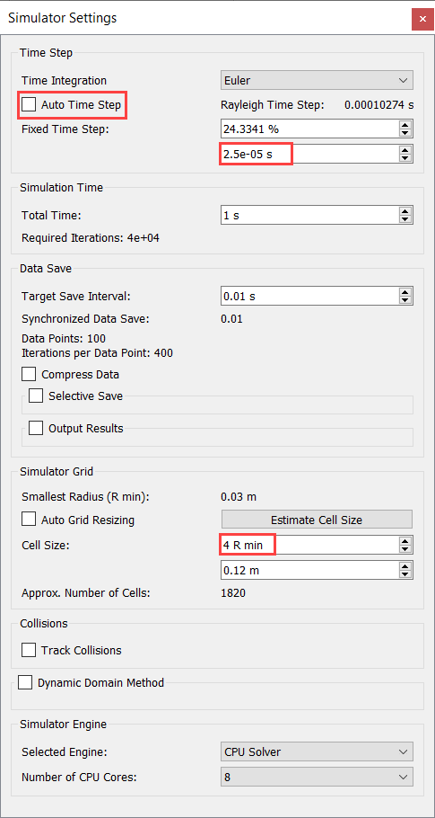

  1. Click in the top-left corner to go to the EDEM Simulator tab.
  2. In the Simulator Settings tab, set the Time Integration scheme to Euler and de-activate the Auto Time Step checkbox.
  3. Set the Fixed Time Step to 2.5e-5 s.
    Note: Generally, a value of 20-40% of the Rayleigh Time Step is recommended as the time step size to ensure stability of the DEM simulation.
  4. Set the Total Time to 1 s and the Target Save Interval to 0.01 s.
  5. Set the Cell Size to 4 R min.
    Generally, a value in the range of 3-6 Rmin is recommended as the optimum cell size.
  6. Set the Selected Engine to CPU Solver and set the Number of CPU Cores based on availability.
    Figure 37.
  7. Once the simulation settings have been defined, save the model.

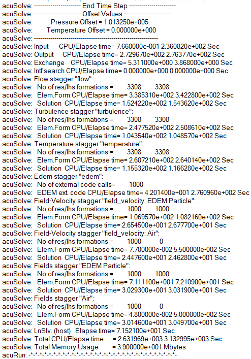

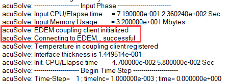

  9. In the dialog, right-click the AcuSolve run and select View log file.
    If the coupling with EDEM is successful, that information is printed in the .log file.
    Figure 42.
    Once the simulation is complete, the summary of the run time is printed at the end of the .log file.
    Figure 43.

  1. In HyperMesh CFD, right-click the AcuSolve run in the Run Status dialog and select Visualize results.
    Figure 44.

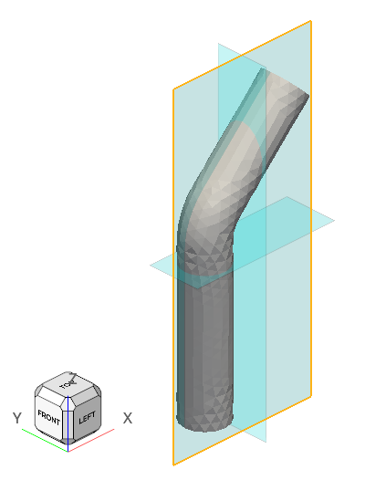

  2. Click the Slice Planes tool.
    Figure 45.
  3. Select the x-z plane as highlighted in the figure below.
    Figure 46.

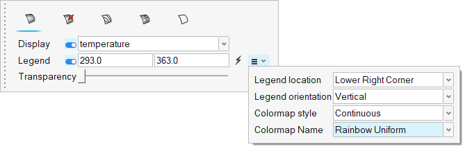

  5. In the display properties microdialog, set the display to temperature and activate the Legend toggle.
  6. Change the bounds of the legend to 293 and 363.
  7. Click and set the Colormap name to Rainbow Uniform.

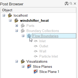

  9. In the Post Browser, turn off the visibility of Flow Boundaries by clicking its icon.
    Figure 48.

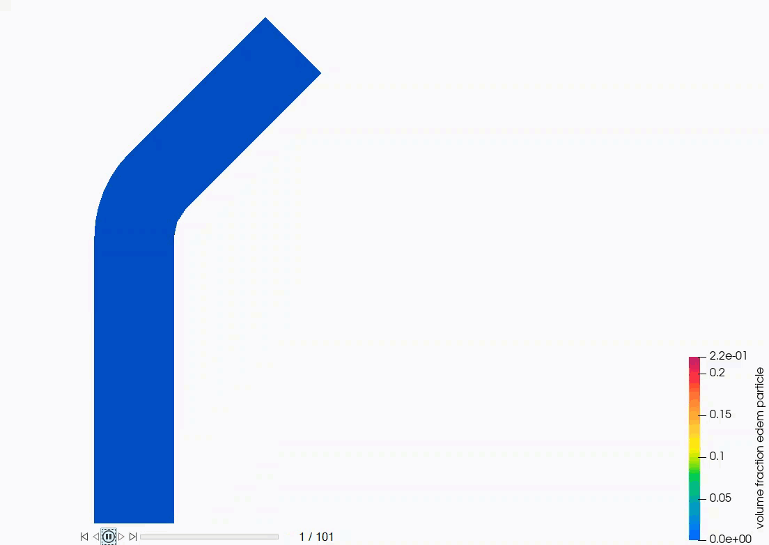

  12. To plot the volume fraction edem particle variable, right-click Slice Plane 1 in the Post Browser and select Edit.
  13. In the display properties microdialog, change the display variable from temperature to volume fraction edem particle and the legend bounds to 0 and 0.2190.
  14. Click on the guide bar.
  15. Click to start the animation.
    Figure 51.

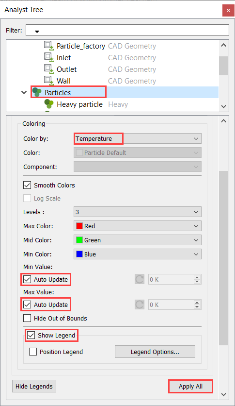

  4. In the Analyst Tree, click Particles.
  5. Set the coloring to Temperature.

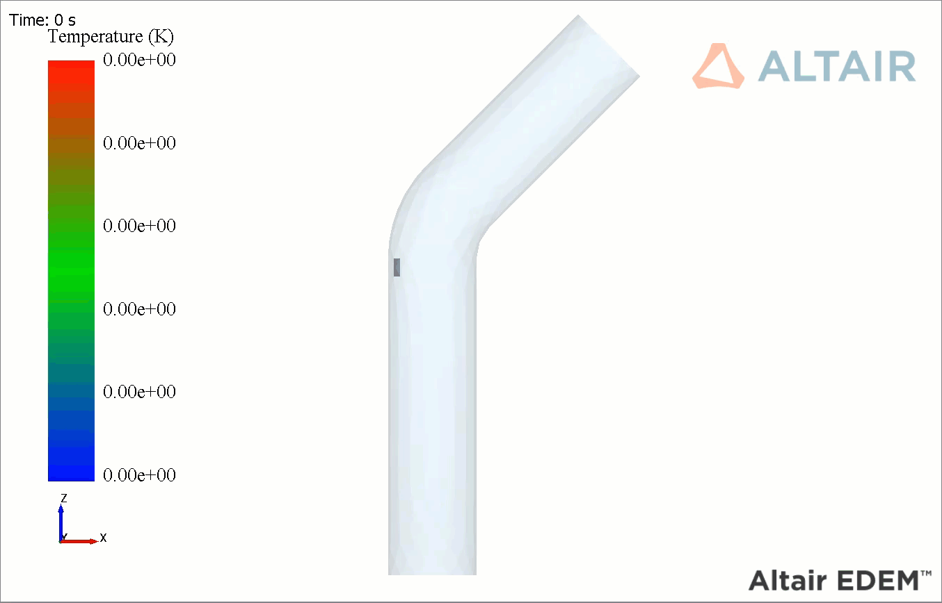

  6. Activate the Auto Update checkboxes for both the Min and Max Value.
  7. Activate the Show Legend checkbox.
  8. Click Apply All.
    Figure 53.
  9. On the menu bar, set the time to 0 by clicking:
    Figure 54.
  10. Set the View plane to + Y.
    Figure 55.
  11. In the Viewer window, set the Playback Speed to 0.1x and then click to play the particle flow animation.
    Figure 56.
    Observe that particles which are at a higher temperature at the time generation become colder as they exchange energy with the fluid phase.
