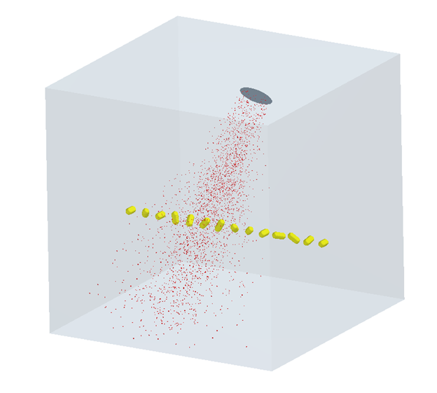

The spray coating update physics models allows you to simulate the coating process in which the volume of a ‘spray’ particle is transferred to a target particle upon contact. In this tutorial, a tablet coating process is simulated, in which spray particles are sprayed onto a row of tablets. The spray particles are modeled as solid particles in EDEM, and their properties are set to that of water. When a spray particle touches the tablet, the volume of spray particle is transferred to the tablet and the amount of coating is registered as a custom property called ‘Volume Added’.
In a typical tablet coater, hot air is injected during the coating process. This allows for the solvent to be evaporated and the solid content of the coating gets deposited on the surface of the tablet. By coupling the spray coating model with the heat and mass transfer models in AcuSolve, you can simulate the drying process as well. In this tutorial, the initial temperature of the air is set to 363 K and the walls are considered as adiabatic. The tablet particles are created with an initial temperature of 350 K. The spray particles are injected for the first 0.25 s of the simulation and then the coating is left to evaporate. In addition to the Volume Added (coating volume), the evaporation rate on each particle can also be monitored.
Some assumptions of the spray coating model:
  • There is no momentum exchange between the spray material and the target material or the geometry. Although, there is momentum exchange between the spray particles and the carrier gas.
  • The spray particles do not exchange thermal energy with the carrier gas or other particles/geometries.
  • The coating on a target particle is assumed to be transferred instantaneously and uniformly across the surface of the particle.
  • The spray particles do not interact with each other. Hence, there is no coalescence or breakup of spray droplets.

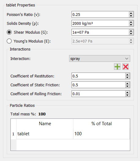

  4. Click the tablet bulk material and verify that the properties are set as shown below.
    Figure 5.

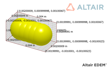

  5. Click Properties under tablet and review the tablet shape.
    Figure 6.
    The coordinate digit in the figure might be slightly different from those in the database.

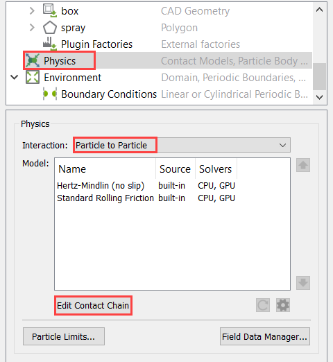

Set the Physics Models
  1. In the Creator Tree, click Physics.
  2. Set the Interaction to Particle to Particle and then click Edit Contact Chain.
    Figure 7.

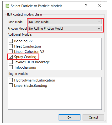

  3. In the dialog, activate the checkbox for the Spray Coating model. Set the Base and Friction models as shown in the figure below and click OK.
    The tutorial is set up in such a way that the tablet particles do not interact with each other. Hence, the base contact models can be turned off for a faster turnaround time.
    Figure 8.

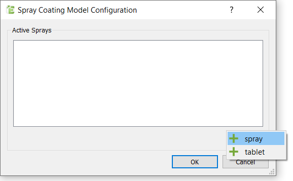

  5. In the Spray Coating Model Configuration dialog, click , select spray from the list of materials, and then click OK.
    Figure 10.

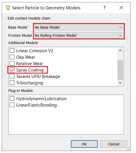

  6. In the Creator Tree, change the interaction to Particle to Geometry and then click Edit Contact Chain.
  7. In the dialog, set the same parameters as above and then click OK.

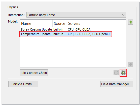

  10. In the Creator Tree, change the interaction to Particle Body Force and then click Edit Contact Chain.
    Note: In this simple example, the tablet particles are created such that there are no tablet-tablet and tablet-geometry contacts. Hence the contact models are turned off to save computational time. The spray-tablet contacts are still active and are handled by the spray coating physics model.

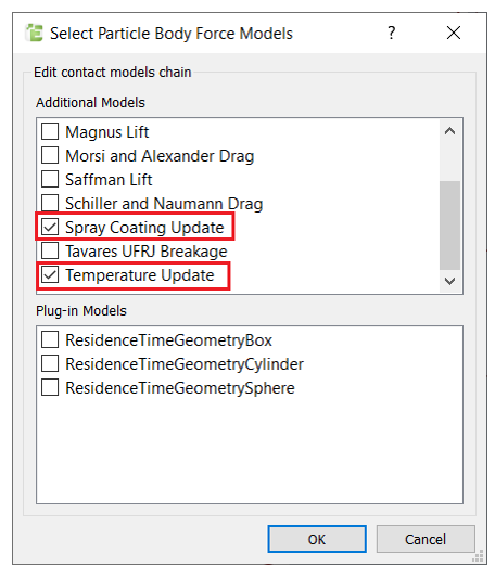

  11. In the dialog, activate the checkboxes for Temperature Update and Spray Coating Update and then click OK.
    Figure 12.
    By including the spray coating model in the particle body force, the target material’s volume is updated. Without this, only the target material’s Volume Added property will increase.
  12. In the Creator Tree, select Temperature Update and then click .
    Figure 13.

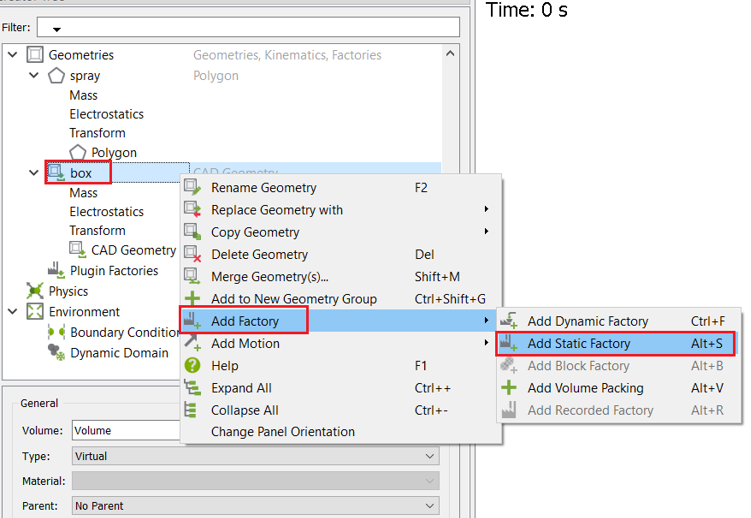

Define Geometries and Factories
  1. Under Geometries, click box and verify that the type is set to Virtual.
  2. Right-click box and select Add Factory > Add Static Factory.
    Figure 14.

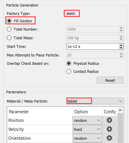

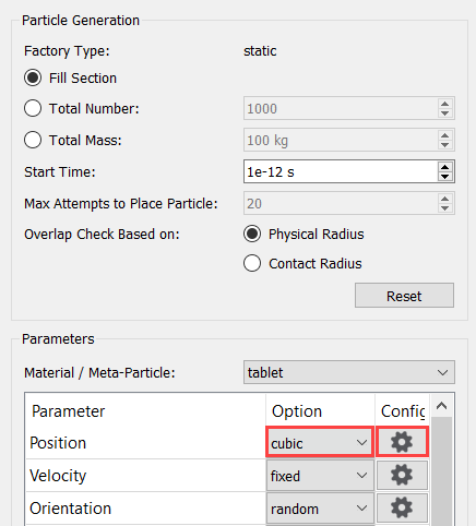

  3. Set the particle generation parameters as shown in the figure below. Make sure that the Material/Meta-Particle is set to tablet.
    Figure 15.
  4. Under Parameters, set the Position option to cubic and then click .
    Figure 16.
  5. In the dialog, enter the position parameters as shown in the figure below and then click OK.

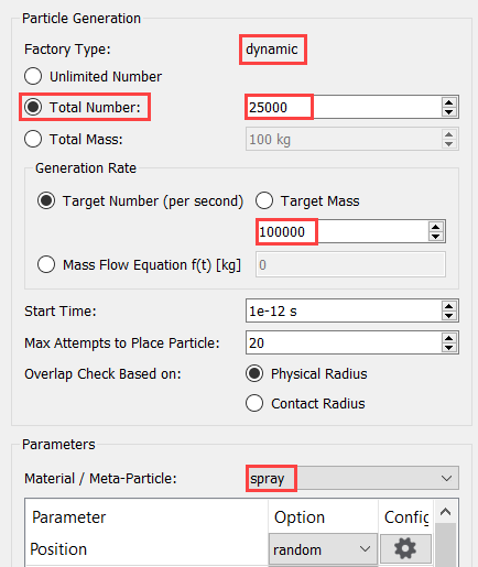

  8. Right-click spray and select Add Factory > Add Dynamic Factory.
  9. Set the particle generation parameters as shown in the figure below. Set the Material to spray.
    Figure 18.

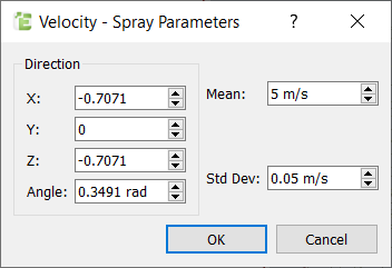

  10. Under Parameters, set the Velocity option to spray and then click .
  11. In the dialog, set the spray velocity parameters as shown in the figure below and then click OK.
    Figure 19.

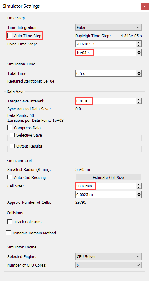

Define the Simulation Settings
  1. Click in the top-left corner to go to the EDEM Simulator tab.
  2. In the Simulator Settings tab, set the Time Integration scheme to Euler and de-activate the Auto Time Step checkbox.
  3. Set the Fixed Time Step to 1e-5 s.
    Note: Generally, a value of 20-40% of the Rayleigh Time Step is recommended as the time step size to ensure stability of the DEM simulation. Spray particles do not impart force on either geometry or any other particles. This means you can run the simulation with the appropriate time step for the target material.
  4. Set the Total Time to 0.5 s and the Target Save Interval to 0.01 s.
  5. Set the Cell Size to 50 R min.
  6. Set the Selected Engine to CPU Solver and set the Number of CPU Cores based on availability.
    Figure 20.
  7. Once the simulation settings have been defined, save the model.

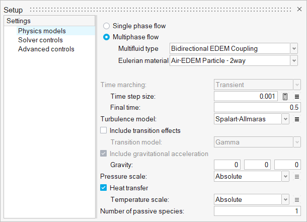

  2. Under the Physics models setting, select the Multiphase flow radio button.
  3. Change the Multifluid type to Bidirectional EDEM Coupling.
  4. Set Time step size and Final time to 0.001 and 0.5, respectively. Select Spalart-Allmaras for the Turbulence model.
  5. Set the Pressure scale to Absolute.
  6. Activate Heat transfer and set the Temperature scale to Absolute.
  7. Set the Number of passive species to 1.
    This setting is necessary for the mass transfer feature to be active. The evaporated moisture is tracked using the species transport equation.
    Figure 24.

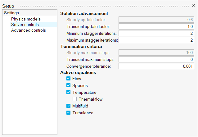

  8. Click the Solver controls setting. Set the Minimum and Maximum stagger iterations to 2 and 2, respectively.
    Figure 25.
  9. Close the dialog and save the model.

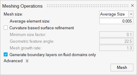

Generate the Mesh
  1. From the Mesh ribbon, click the Volume tool.
    Figure 27.
    The Meshing Operations dialog opens.
  2. Set the Mesh size to Average size and change the Maximum element size to 0.005.
  3. Deactivate Curvature-based surface refinement and then click Mesh.
    Figure 28.
  4. Once the meshing process is complete, save the model.

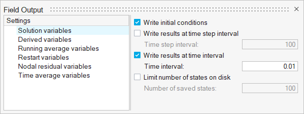

  2. Check the box for Write initial conditions.
  3. Uncheck the box for Write results at time step interval
  4. Check the box for Write results at time interval.
  5. Set the Time step interval to 0.01.
    Figure 30.

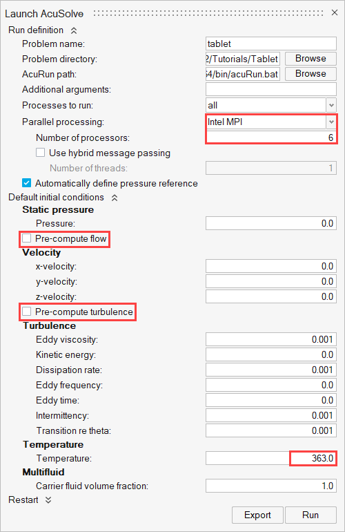

    The Launch AcuSolve dialog opens.
  4. Set the Parallel processing option to Intel MPI.
  5. Set the Number of processors to 6.
  6. Expand Default initial conditions, uncheck Pre-compute flow and set the velocity values to 0. Uncheck Pre-compute Turbulence.
  7. Set the Temperature to 363 K.
  8. Click Run to launch AcuSolve.

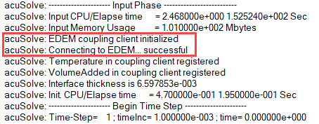

    Once the AcuSolve simulation is launched, it connects with the EDEM coupling server. A warning message is displayed indicating that the base contact models have not been set. Click Ignore. Since the tablet particles are not in contact with each other or with the geometry, you do not need any contact models. The spray-tablet contacts are handled by the spray coating model.
  9. In the dialog, right-click the AcuSolve run and select View log file.
    If the coupling with EDEM is successful, that information is printed in the .log file.
    Figure 35.

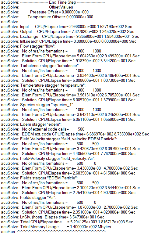

    Once the simulation is complete, the summary of the run time is printed at the end of the .log file.
    Figure 36.

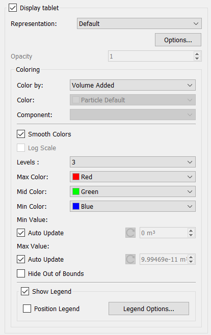

  4. In the Analyst Tree, expand Particles and then click tablet.
  5. Set the coloring to Volume Added.
  6. Activate the Auto Update checkbox for both Min and Max Value.
  7. Activate the Show Legend checkbox.
    Figure 38.

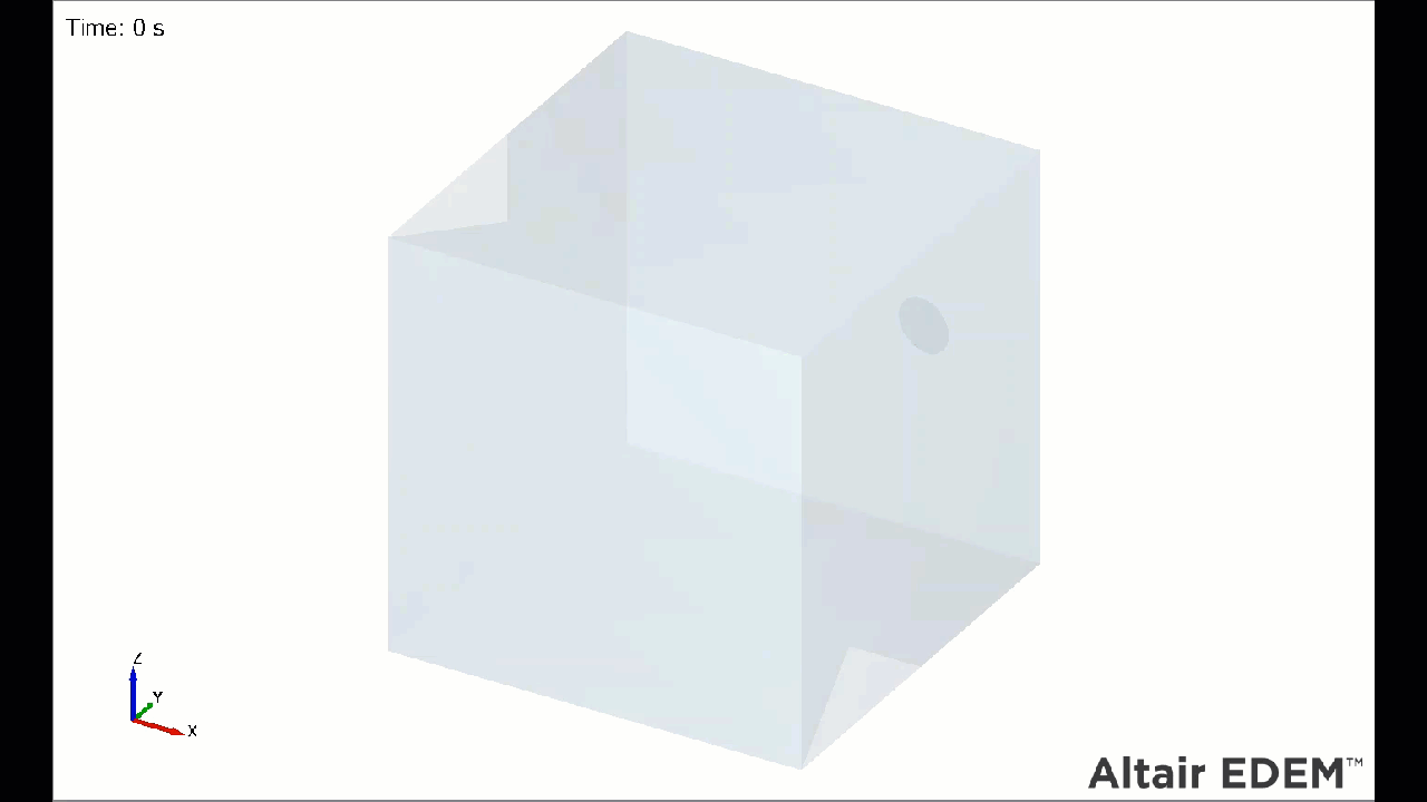

  8. On the menu bar, set the time to 0 by clicking:
    Figure 39.
  9. Set the View plane to Default.
    Figure 40.
  10. In the Viewer window, set the Playback Speed to 0.1x and then click to play the particle flow animation.
    Figure 41.
    Observe that the added volume increases in the beginning as the tablets receive the spray coating. Once the spray injection is stopped, the coating starts to dry up and the added volume decreases gradually.
