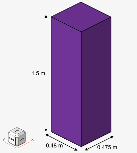

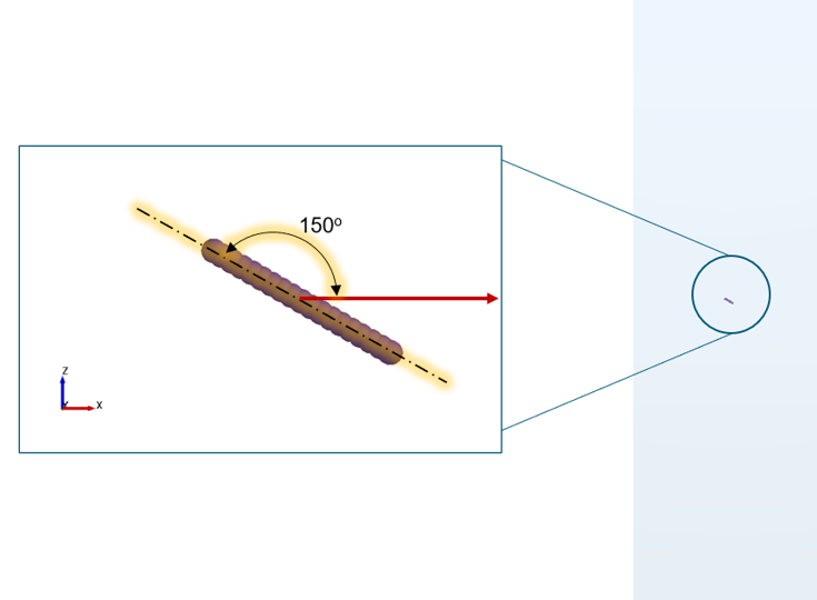

The problem to be solved is shown schematically in the figures below. The model consists of simple tank filled with water. A cylindrical particle is introduced at the center of the tank and allowed to fall freely through the water column. The particle will be introduced at an orientation such that its principal axis is at 150° to the horizontal axis. As the particle travels in the downward direction, a non-uniform flow field is developed due to the fluid-particle interaction. As a result the hydrodynamic forces on the particles introduce a torque on the particle as the center of pressure does not coincide with the center of mass. In addition, because of the orientation and the non-spherical shape, an additional lift force makes the particle to steer away from the central line of path.
AcuSolve-EDEM bidirectional coupling is used to model the interaction between the fluid and particle. In this tutorial, the Rong drag model in conjunction with the Ganser non-spherical drag-coefficient model is used such that the effect of non-spherical shape is considered. The length scale used for factoring in the shape of the particles is the aspect ratio. A cylindrical particle with an aspect ratio of 9.242 (L/D = 0.05 m/0.00541 m) is used for this simulation.
This tutorial also introduces you to the concept of generating particles in EDEM at a specific location and with a specific orientation. When defining the particle factory, you have the option to define certain properties of particles such as velocity, angular velocity, position, orientation, temperature, and so on. Properties such as orientation and position can be defined by you or set to random. The steps listed below illustrate the general process for calculating the orientation matrix required in EDEM for creating particles with a specific orientation.
  1. Generating particles at a certain orientation requires an orientation matrix that transforms the particle relative to the initial orientation specified during the particle shape definition. For rotation about an axis ( n ) by an angle ( α MathType@MTEF@5@5@+= feaahqart1ev3aqatCvAUfeBSjuyZL2yd9gzLbvyNv2CaerbuLwBLn hiov2DGi1BTfMBaeXatLxBI9gBaerbd9wDYLwzYbItLDharqqtubsr 4rNCHbGeaGqiVCI8FfYJH8YrFfeuY=Hhbbf9v8qqaqFr0xc9pk0xbb a9q8WqFfeaY=biLkVcLq=JHqpepeea0=as0Fb9pgeaYRXxe9vr0=vr 0=vqpWqaaeaabiGaciaacaqabeaadaqaaqaaaOqaaabaaaaaaaaape GaeqySdegaaa@37A8@ ), the orientation matrix ( R α , n ^ MathType@MTEF@5@5@+= feaahqart1ev3aqatCvAUfeBSjuyZL2yd9gzLbvyNv2CaerbuLwBLn hiov2DGi1BTfMBaeXatLxBI9gBaerbd9wDYLwzYbItLDharqqtubsr 4rNCHbGeaGqiVCI8FfYJH8YrFfeuY=Hhbbf9v8qqaqFr0xc9pk0xbb a9q8WqFfeaY=biLkVcLq=JHqpepeea0=as0Fb9pgeaYRXxe9vr0=vr 0=vqpWqaaeaabiGaciaacaqabeaadaqaaqaaaOqaaabaaaaaaaaape GaamOua8aadaWgaaWcbaWdbiabeg7aHjaacYcaceWGUbWdayaajaaa beaaaaa@3A8C@ ) is given by
  2. R α, n ^ =  a 2 K+cosα abK−c sinα acK+b sinα abK+c sinα b 2 K+cosα bcK−a sinα acK−b sinα bcK+a sinα c 2 K+cosα MathType@MTEF@5@5@+= feaahqart1ev3aqatCvAUfeBSjuyZL2yd9gzLbvyNv2CaerbuLwBLn hiov2DGi1BTfMBaeXatLxBI9gBaerbd9wDYLwzYbItLDharqqtubsr 4rNCHbGeaGqiVCI8FfYJH8YrFfeuY=Hhbbf9v8qqaqFr0xc9pk0xbb a9q8WqFfeaY=biLkVcLq=JHqpepeea0=as0Fb9pgeaYRXxe9vr0=vr 0=vqpWqaaeaabiGaciaacaqabeaadaqaaqaaaOqaaabaaaaaaaaape GaamOua8aadaWgaaWcbaWdbiabeg7aHjaacYcaceWGUbWdayaajaaa beaak8qacqGH9aqpcaGGGcWaamWaa8aabaqbaeqabmWaaaqaa8qaca WGHbWdamaaCaaaleqabaWdbiaaikdaaaGccaWGlbGaey4kaSIaam4y aiaad+gacaWGZbGaeqySdegapaqaa8qacaWGHbGaamOyaiaadUeacq GHsislcaWGJbGaaiiOaiaadohacaWGPbGaamOBaiabeg7aHbWdaeaa peGaamyyaiaadogacaWGlbGaey4kaSIaamOyaiaacckacaWGZbGaam yAaiaad6gacqaHXoqya8aabaWdbiaadggacaWGIbGaam4saiabgUca RiaadogacaGGGcGaam4CaiaadMgacaWGUbGaeqySdegapaqaa8qaca WGIbWdamaaCaaaleqabaWdbiaaikdaaaGccaWGlbGaey4kaSIaam4y aiaad+gacaWGZbGaeqySdegapaqaa8qacaWGIbGaam4yaiaadUeacq GHsislcaWGHbGaaiiOaiaadohacaWGPbGaamOBaiabeg7aHbWdaeaa peGaamyyaiaadogacaWGlbGaeyOeI0IaamOyaiaacckacaWGZbGaam yAaiaad6gacqaHXoqya8aabaWdbiaadkgacaWGJbGaam4saiabgUca RiaadggacaGGGcGaam4CaiaadMgacaWGUbGaeqySdegapaqaa8qaca WGJbWdamaaCaaaleqabaWdbiaaikdaaaGccaWGlbGaey4kaSIaam4y aiaad+gacaWGZbGaeqySdegaaaGaay5waiaaw2faaaaa@947D@
  3. Where, K   = 1 − c o s α MathType@MTEF@5@5@+= feaahqart1ev3aqatCvAUfeBSjuyZL2yd9gzLbvyNv2CaerbuLwBLn hiov2DGi1BTfMBaeXatLxBI9gBaerbd9wDYLwzYbItLDharqqtubsr 4rNCHbGeaGqiVCI8FfYJH8YrFfeuY=Hhbbf9v8qqaqFr0xc9pk0xbb a9q8WqFfeaY=biLkVcLq=JHqpepeea0=as0Fb9pgeaYRXxe9vr0=vr 0=vqpWqaaeaabiGaciaacaqabeaadaqaaqaaaOqaaabaaaaaaaaape Gaam4saiaacckacqGH9aqpdaqadaWdaeaapeGaaGymaiabgkHiTiaa dogacaWGVbGaam4Caiabeg7aHbGaayjkaiaawMcaaaaa@40C6@ and a, b, c are the components of the unit vector of the axis of rotation, n ^ = a i + b j + c k MathType@MTEF@5@5@+= feaahqart1ev3aqatCvAUfeBSjuyZL2yd9gzLbvyNv2CaerbuLwBLn hiov2DGi1BTfMBaeXatLxBI9gBaerbd9wDYLwzYbItLDharqqtubsr 4rNCHbGeaGqiVCI8FfYJH8YrFfeuY=Hhbbf9v8qqaqFr0xc9pk0xbb a9q8WqFfeaY=biLkVcLq=JHqpepeea0=as0Fb9pgeaYRXxe9vr0=vr 0=vqpWqaaeaabiGaciaacaqabeaadaqaaqaaaOqaaabaaaaaaaaape GabmOBa8aagaqca8qacqGH9aqpcaWGHbacbmGaa8xAaiabgUcaRiaa dkgacaWFQbGaey4kaSIaam4yaiaa=Tgaaaa@3F77@ .
    Note: The right-hand thumb rule is used for determining the sign of the angle of rotation where the thumb points towards the axis of rotation and the curl of the fingers points towards the positive direction of the angle of rotation.

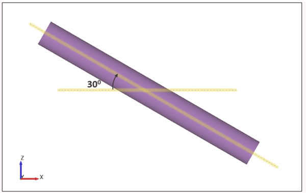

  4. In the current example, the particle should be rotated by an angle of 30o about the y-axis. Therefore, α MathType@MTEF@5@5@+= feaahqart1ev3aqatCvAUfeBSjuyZL2yd9gzLbvyNv2CaerbuLwBLn hiov2DGi1BTfMBaeXatLxBI9gBaerbd9wDYLwzYbItLDharqqtubsr 4rNCHbGeaGqiVCI8FfYJH8YrFfeuY=Hhbbf9v8qqaqFr0xc9pk0xbb a9q8WqFfeaY=biLkVcLq=JHqpepeea0=as0Fb9pgeaYRXxe9vr0=vr 0=vqpWqaaeaabiGaciaacaqabeaadaqaaqaaaOqaaabaaaaaaaaape GaeqySdegaaa@37A8@ =30o, K MathType@MTEF@5@5@+= feaahqart1ev3aqatCvAUfeBSjuyZL2yd9gzLbvyNv2CaerbuLwBLn hiov2DGi1BTfMBaeXatLxBI9gBaerbd9wDYLwzYbItLDharqqtubsr 4rNCHbGeaGqiVCI8FfYJH8YrFfeuY=Hhbbf9v8qqaqFr0xc9pk0xbb a9q8WqFfeaY=biLkVcLq=JHqpepeea0=as0Fb9pgeaYRXxe9vr0=vr 0=vqpWqaaeaabiGaciaacaqabeaadaqaaqaaaOqaaabaaaaaaaaape Gaam4saaaa@36D9@ =0.133974596, a=0, b=1 and c=0. By substituting these values, you get the following orientation matrix:
  5. R α, n ^ =  0.8660254 0 0.5 0 1 0 −0.5 0 0.8660254 MathType@MTEF@5@5@+= feaahqart1ev3aqatCvAUfeBSjuyZL2yd9gzLbvyNv2CaerbuLwBLn hiov2DGi1BTfMBaeXatLxBI9gBaerbd9wDYLwzYbItLDharqqtubsr 4rNCHbGeaGqiVCI8FfYJH8YrFfeuY=Hhbbf9v8qqaqFr0xc9pk0xbb a9q8WqFfeaY=biLkVcLq=JHqpepeea0=as0Fb9pgeaYRXxe9vr0=vr 0=vqpWqaaeaabiGaciaacaqabeaadaqaaqaaaOqaaabaaaaaaaaape GaamOua8aadaWgaaWcbaWdbiabeg7aHjaacYcaceWGUbWdayaajaaa beaak8qacqGH9aqpcaGGGcWaamWaa8aabaqbaeqabmWaaaqaa8qaca aIWaGaaiOlaiaaiIdacaaI2aGaaGOnaiaaicdacaaIYaGaaGynaiaa isdaa8aabaWdbiaaicdaa8aabaWdbiaaicdacaGGUaGaaGynaaWdae aapeGaaGimaaWdaeaapeGaaGymaaWdaeaapeGaaGimaaWdaeaapeGa eyOeI0IaaGimaiaac6cacaaI1aaapaqaa8qacaaIWaaapaqaa8qaca aIWaGaaiOlaiaaiIdacaaI2aGaaGOnaiaaicdacaaIYaGaaGynaiaa isdaaaaacaGLBbGaayzxaaaaaa@5618@
  6. Figure 3.

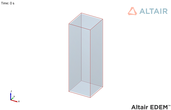

Part 1 - EDEM Simulation
Start Altair EDEM from the Windows start menu by clicking Start > Altair 2025.1 > EDEM 2025.1 .
Open the EDEM Input Deck
  1. From the menu bar, click File > Open.
  2. In the dialog, browse to your problem directory and open the cylinder.dem file.
    The geometry and the materials are loaded.
    Figure 4.

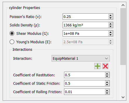

  1. In the Creator Tree, expand Bulk Material > cylinder > New particle 1.
  2. Click cylinder and verify that the properties are set as shown below.
    Figure 5.

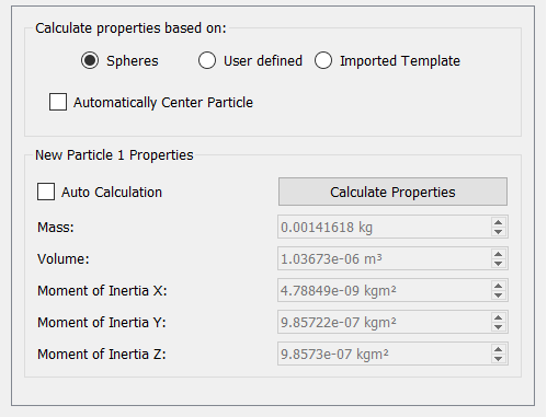

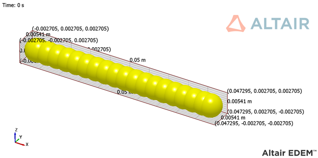

    Observe that the particle shape is created using multiple spheres aligned along the x-axis.
    Note: When defining non-spherical shapes, you need to make sure that the principal axis of the particle is aligned with the x-axis, as shown in the figure below.
    Figure 6.
    The length (L) and diameter (D) of the particle are 0.05 m and 0.00541 m respectively. Therefore, the aspect ratio (= L/D) of the particle is 9.242.
  4. Observe the mass and volume of the particle in the Creator Tree.

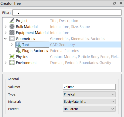

  1. In the Creator Tree, expand Geometries.
  2. Click Tank and verify that the type is set to Physical.
    Figure 8.

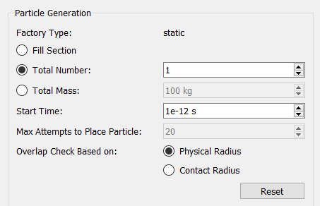

  4. Right-click New Factory 1 and select Change Factory Type.
  5. Verify that the Factory Type is set to static and set the particle generation parameters as shown in the figure below.

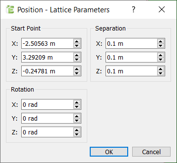

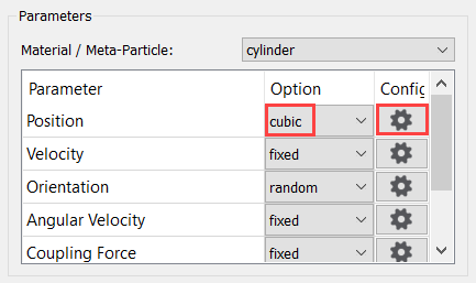

  6. Under Parameters, set the Position option to cubic and then click .
    Figure 10.
  7. In the dialog, enter the position parameters as shown in the figure below and then click OK.
    Figure 11.

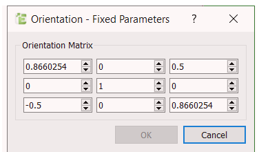

  8. Under Parameters, set the Orientation option to fixed and then click .
  9. Enter the values for the orientation matrix as shown in the figure below.
    Figure 12.
  10. Click OK.

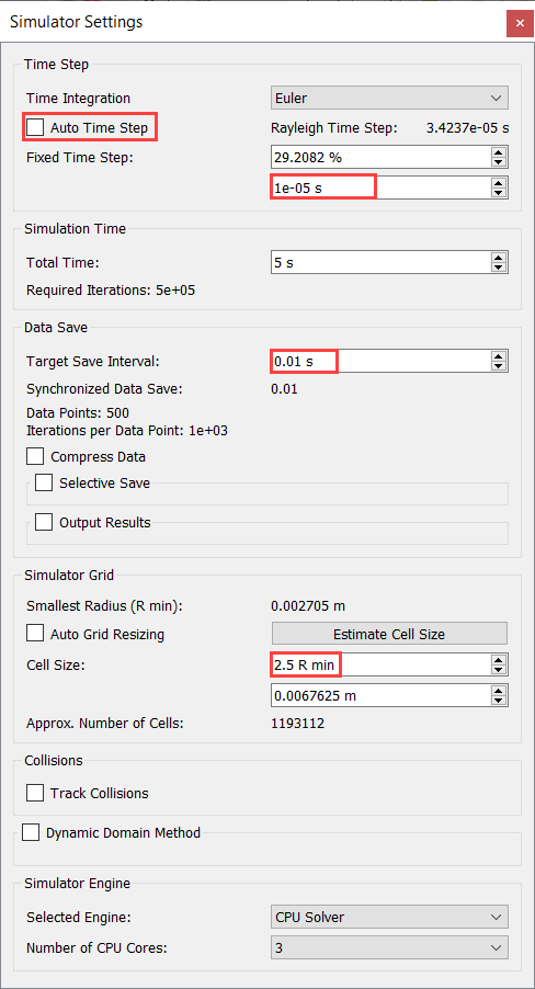

  2. In the Simulator Settings tab, set the Time Integration scheme to Euler and de-activate the Auto Time Step checkbox.
  3. Set the Fixed Time Step to 1e-5 s.
    Note: Generally, a value of 20-40% of the Rayleigh Time Step is recommended as the time step size to ensure stability of the DEM simulation.
  4. Set the Total Time to 5 s and the Target Save Interval to 0.01 s.
  5. Set the Cell Size to 2.5 R min.
    Generally, a value in the range of 2-6 Rmin is recommended as the optimum cell size.
  6. Set the Selected Engine to CPU Solver and set the Number of CPU Cores based on availability.
    Figure 13.

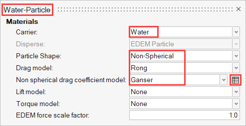

  5. In the Material Library dialog, select EDEM 2 Way Multiphase, switch to the My Materials tab, and then click to add a new material model.
  6. In the microdialog, click EDEM Bidirectional Material in the top-left corner and change the name to Water-Particle.
  7. Set the Carrier field to Water.
  8. Set the Particle Shape to Non-Spherical.
  9. Set the Drag model to Rong.
  10. Set the Non spherical drag coefficient model to Ganser.
  11. Click the table icon beside the drag coefficient model drop-down.
    Figure 17.

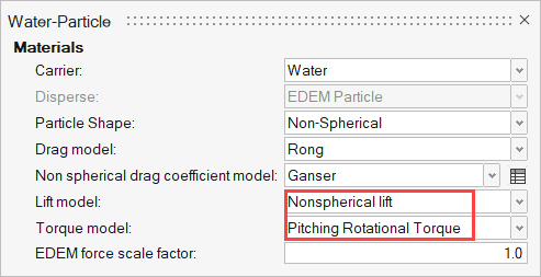

  14. Set the Lift model to Nonspherical lift.
  15. Set the Torque model to Pitching Rotational Torque.
    Figure 19.

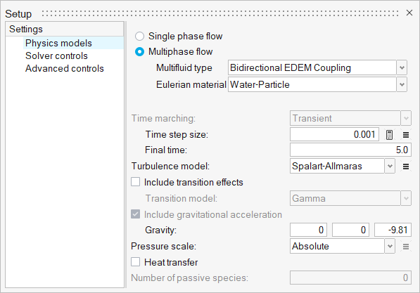

  17. In the Setup dialog, set the Eulerian Material to Water-Particle.
  18. Set Time step size and Final time to 0.001 and 5, respectively. Select Spalart-Allmaras for the Turbulence model.
  19. Verify that Gravity is set to 0, 0, -9.81.
  20. Set the Pressure scale to Absolute.

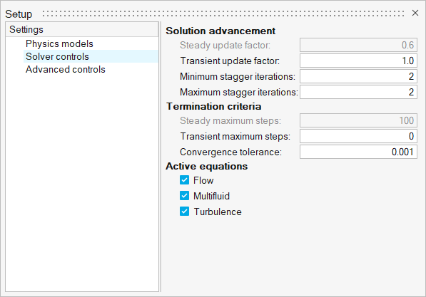

  21. Click the Solver controls setting and set the Maximum stagger iterations to 2.
    Figure 21.

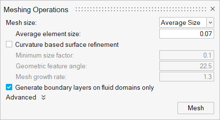

  2. Set the Mesh size to Average size and change the Maximum element size to 0.07.
  3. Deactivate Curvature-based surface refinement and then click Mesh.
    Figure 24.

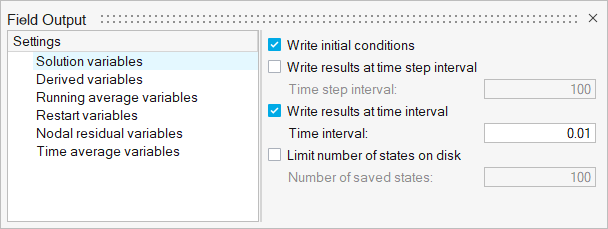

  1. From the Solution ribbon, click the Field tool.
    Figure 25.
    The Field Output dialog opens.
  2. Check the box for Write initial conditions.
  3. Uncheck the box for Write results at time step interval
  4. Check the box for Write results at time interval.
  5. Set the Time step interval to 0.01.
    Figure 26.
  6. Close the dialog and save the model.

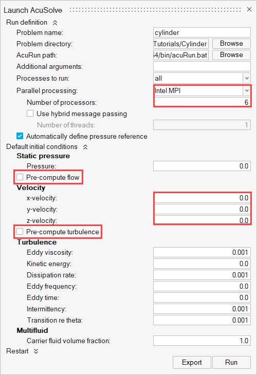

    The Launch AcuSolve dialog opens.
  4. Set the Parallel processing option to Intel MPI.
  5. Set the Number of processors to 6.
  6. Expand Default initial conditions, uncheck Pre-compute flow and set the velocity values to 0. Uncheck Pre-compute Turbulence.
  7. Click Run to launch AcuSolve.

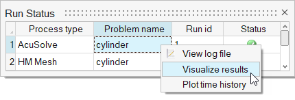

    Once the AcuSolve run is launched, the Run Status dialog opens.

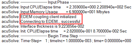

  8. In the dialog, right-click the AcuSolve run and select View log file.
    If the coupling with EDEM is successful, that information is printed in the .log file.

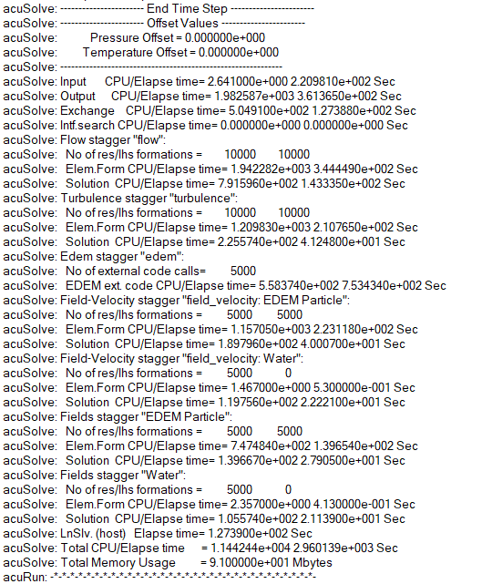

    Figure 31.
    Once the simulation is complete, the summary of the run time is printed at the end of the .log file.
    Figure 32.
Analyze the Results
AcuSolve Post-Processing
  1. In HyperMesh CFD, right-click the AcuSolve run in the Run Status dialog and select Visualize results.

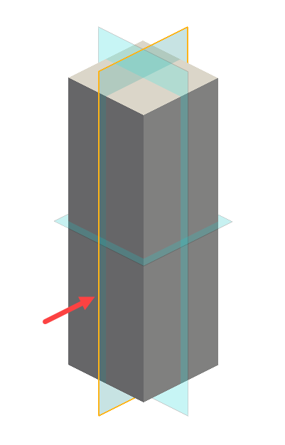

    Figure 34.
  3. Select the x-z plane as highlighted in the figure below.
    Figure 35.
  4. In the slice plane microdialog, click to create the slice plane.

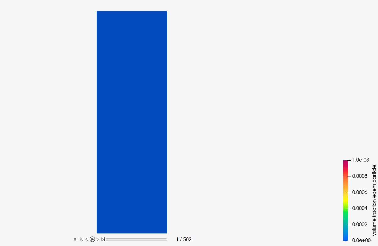

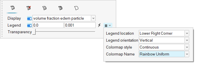

  5. In the display properties microdialog, set the display to volume fraction edem particle and activate the Legend toggle.
  6. Change the bounds of the legend to 0 and 0.001.
  7. Click and set the Colormap name to Rainbow Uniform.

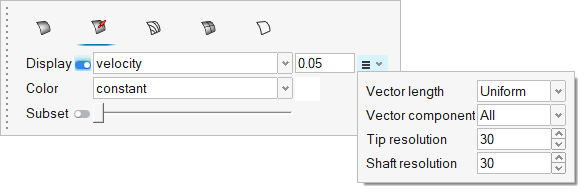

  8. Click the Vector Display tab.
  9. Activate the Display toggle and set the variable to velocity.
  10. Set the size to 0.05 and the Color to Constant.
  11. Click and set the Vector length to Uniform.
    Figure 37.

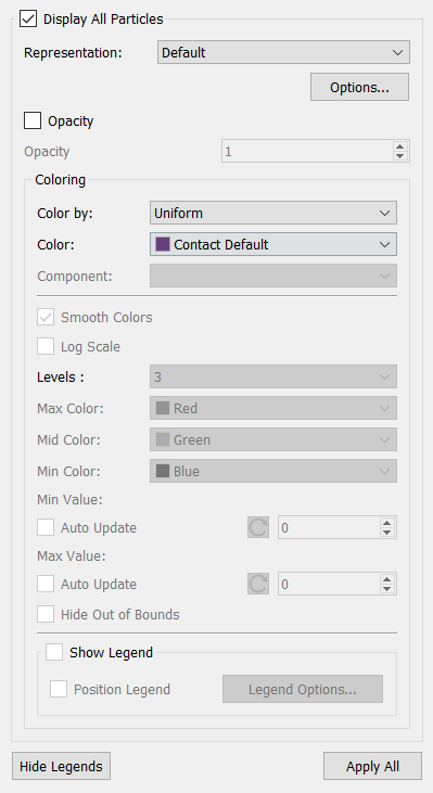

  4. In the Analyst Tree, click Particles.
  5. Set the coloring to Contact Default.
  6. Click Apply All.
    Figure 42.

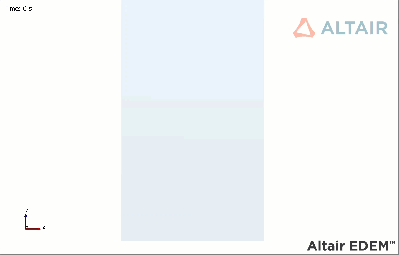

  7. On the menu bar, set the time to 0 by clicking:
    Figure 43.
  8. Set the View plane to + Y.
    Figure 44.
  9. In the Viewer window, set the Playback Speed to 0.2x and then click to play the particle flow animation.
    Figure 45.
    Observe that the particle rotates and translates as it falls down. Without lift and torque, you will not see this phenomenon.
