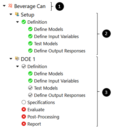

The Study Explorer displays a hierarchical view of your study setup and approaches, and can be used to guide you through the study setup process.
When you create a study or open an existing study, it will appear in the Study Explorer. Clicking the different items in the Study Explorer guides you to the various parts of your study.
Figure 1. Study Explorer View
  1. Study name; clicking this item guides you to study details and approach details, and enables you to identify batch commands.
  2. Steps to setup your study, such as define your model, input variables, and output responses.
  3. Steps to define approaches in your study.
    Once the study Setup is complete, an unlimited combination of approaches (DOE, Fit, Optimization and Stochastic) can be added.

The steps you must complete while setting up your study and defining approaches display in a hierarchical order. Throughout the study, each steps corresponding checkbox will indicate a status.
The next step that needs to be completed.
Proceed to the next step. This step may have an optional work button to perform tasks such as, Evaluate Expressions, Launch Post Processing and Create Report.
Step has been completed.
An action in this step is not yet allowed.
A warning of possible changes in the step since it was first performed.
