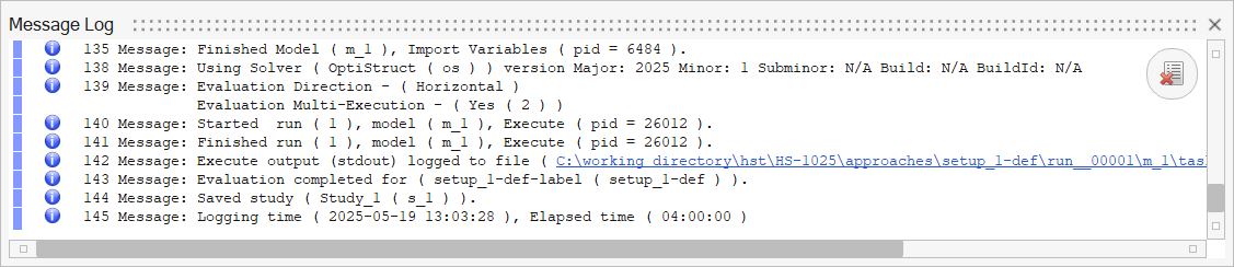

Message Log Window
The Message Log window, located at the bottom of HyperStudy, logs warnings and errors encountered while you are conducting your investigation.
Note: Messages which are of type Error are always enabled and displayed in the Message Log window. If the Message Log window has been minimized and HyperStudy an error, it will be maximized to alert you of the condition.

Log to File
Display messages in the Message Log window, and log messages in a separate file.
Details
Open the log file or change the file path of the log file.
Info
Display summary information about the current session and message log status.
For example:
  • Time current
  • Time elapsed
  • Location of log files in the current HyperStudy session

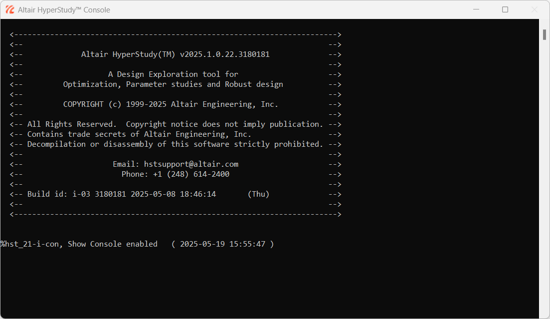

Show Console
Displays the HyperStudy console.
