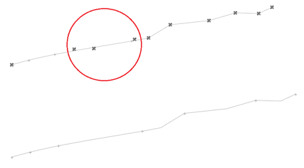

Break Angle
Specify the minimum angle allowed between three points in a line. If the angle between a point and the two adjacent points is less than the angle specified, this point is considered to be a point of discontinuity in the line and a joint is placed at that point.
In the image below, a break angle is set to 150 degrees. The highlighted point angle is closed to 135 degrees. Therefore, a joint is created.

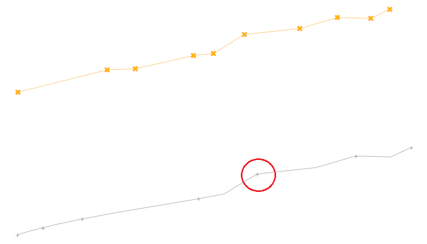

Aspect Ratio
Specify the maximum ratio allowed for the distance between a point and the previous point on the line, and the distance between the same point and the next point on the line. If the ratio of the distance between the two adjacent segments exceeds the defined aspect ratio, a joint is placed between the segments.
In the image below, the aspect is set to 5. The large gap (top line) results in a joint (bottom line) because it is more than 5 times the length of its neighbors.

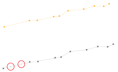

Linear Angle
Defines the angle at which a line is considered a straight line. If the line angle between three consecutive points along the line is greater than the angle specified, the center point is removed from the line.
In the image below, three points (top line) are removed because they form lines with their neighbors that are greater than the linear angle setting.
