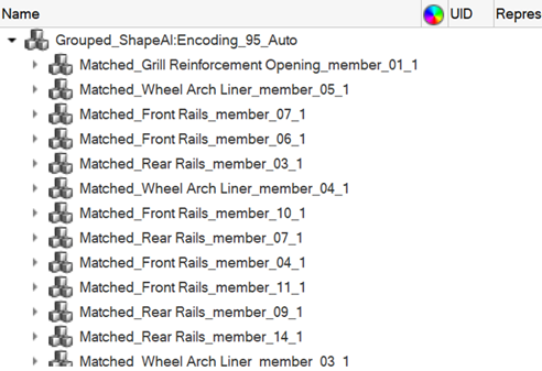

    A progress bar initializes in the status bar. A part set is created for each group of parts that match each other. The top level part set is created using a combination of comparison method and criteria, and is prefixed with "Grouped_." Nested part sets are created for each part having similar or matching parts, with a prefix of "Matched_."
