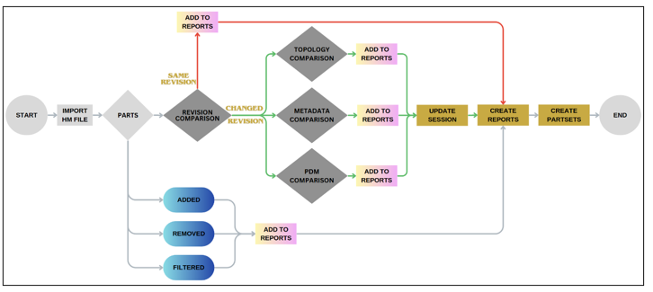

Update Process
Model Update is a process to compare and review changes between two models.
This functionality compares parts by Revision (Revised or Carryover) and detects differences and changes in the following categories: Topology, PDM data and Metadata. After the comparison, the session’s model is updated to match exactly the imported model. The report provides additional information on filtered, new and removed parts between the two models.
Model Update is based on four basic steps:
  1. Compare revision for all of the parts.
  2. Compare the revised parts for topology changes.
  3. Compare the revised parts for metadata changes.
  4. Compare the revised parts for PDM changes.
After the Model Update process, report file and part sets are created to review the changes.

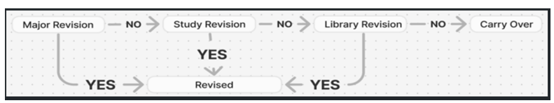

Revision Comparison Rules
There are three rules for revision comparison. By selecting one of these rules, you define how comparison will be done and which parts will be marked as Revised or Carryover.
Figure 3. Revision Comparison Rules
Major revision (default option)
Only the Major revision will be compared. Parts that have different Major revision will be marked as Revised and will be compared.
Major and Study revision
Major and Study revision will be compared. Parts that have different Major or Study revision will be marked as Revised and will be compared.
Major, Study and Library revision
All three revisions will be checked (Major, Study and Library revision). Parts that have different Major, Study or Library revision will be marked as Revised and will be compared.
Note: Based on the selected rule, all of the parts that have the same revision will be marked as Carryover and will be skipped from comparison. Only parts with changed revision (Revised) will be compared.
Topology, Metadata and PDM Comparison
After the revision comparison finishes, all of the parts are organized in two major categories, Revised and Carryover. All of the revised parts will be compared for Topology, Metadata and PDM data changes.

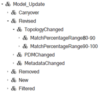

Update Session
After the completion of all of the above, the session will be updated to match the incoming model. Based on the results, part sets will be created for each category to review the changes.
Figure 4. Model Update Part Sets

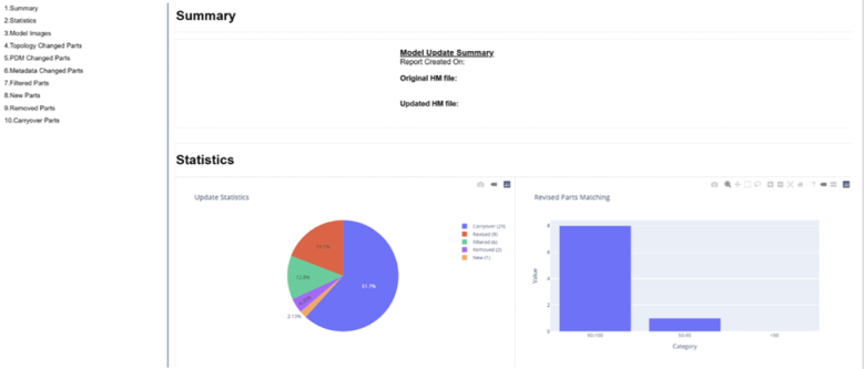

Reports
When Model Update finishes, HTML reports will be created. These reports will help you to track and review all of the changes made in the model in an organized way. Reports present a comprehensive summary of comparison results on a structured page, where you can navigate through categories and find useful information about the model.
Figure 5. Model Update Reports
