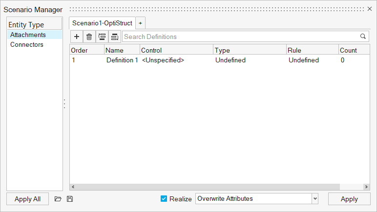

  1. From the Assembly ribbon, click the Scenario tool.
    Upon opening the Scenario Manager, an initial scenario is already available.

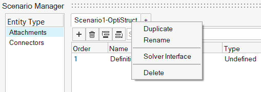

  2. Optional: Right-click on a scenario to duplicate, rename, change the solver interface, or delete.
    The solver interface filters the available controls. This ensures that the scenario is in a single solver.

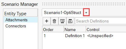

    Click to create additional scenarios.
    Figure 4.

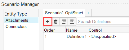

  3. Click in the active scenario tab to create new definitions.
    Figure 5.
    Similar to scenarios, right-click on a definition to rename, review, control the display, and delete.

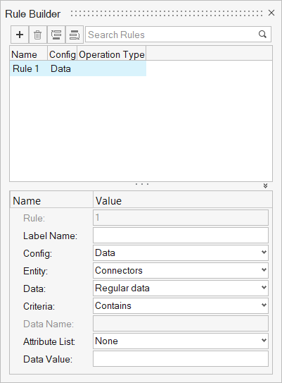

  5. Right-click on Rule column and select Edit. Use the Rule Builder to dynamically determine which engineering entities that a given control is applied to.
    The rule can be created based on Data on the engineering entity, by Shapes, by Selection, or All.
    Figure 6.
