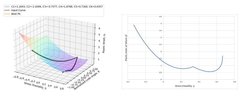

    Figure 1 shows the example of curve fit of plane stress failure curve into failure surface criteria.
    Figure 1. Example of Syazwan failure criterion fit

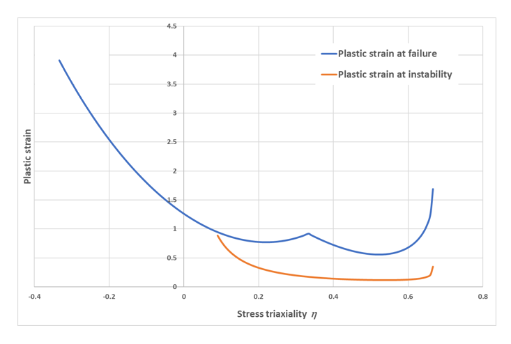

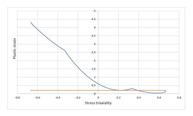

  4. In some cases, the criterion may have negative or very low values for some loading conditions. In that case, it will be bounded by the minimum plastic strain at failure parameter ε p f M I N MathType@MTEF@5@5@+= feaahqart1ev3aqatCvAUfeBSjuyZL2yd9gzLbvyNv2CaerbuLwBLn hiov2DGi1BTfMBaeXatLxBI9gBaerbd9wDYLwzYbItLDharqqtubsr 4rNCHbGeaGqiVu0Je9sqqrpepC0xbbL8F4rqqrFfpeea0xe9Lq=Jc9 vqaqpepm0xbba9pwe9Q8fs0=yqaqpepae9pg0FirpepeKkFr0xfr=x fr=xb9adbaqaaeGaciGaaiaabeqaamaabaabaaGcbaGaeqyTdu2aa0 baaSqaaiaadchaaeaacaWGMbaaaOWaaSbaaSqaaiaad2eacaWGjbGa amOtaaqabaaaaa@3C51@ that must be positive or null (by default = 0.0). All values under ε p f M I N MathType@MTEF@5@5@+= feaahqart1ev3aqatCvAUfeBSjuyZL2yd9gzLbvyNv2CaerbuLwBLn hiov2DGi1BTfMBaeXatLxBI9gBaerbd9wDYLwzYbItLDharqqtubsr 4rNCHbGeaGqiVu0Je9sqqrpepC0xbbL8F4rqqrFfpeea0xe9Lq=Jc9 vqaqpepm0xbba9pwe9Q8fs0=yqaqpepae9pg0FirpepeKkFr0xfr=x fr=xb9adbaqaaeGaciGaaiaabeqaamaabaabaaGcbaGaeqyTdu2aa0 baaSqaaiaadchaaeaacaWGMbaaaOWaaSbaaSqaaiaad2eacaWGjbGa amOtaaqabaaaaa@3C51@ are then ignored.
    Figure 2 shows an example with a minimum value (orange curve) of 0.2.
    Figure 2. Failure criterion (blue curve) bounded by plastic strain at failure minimum value. ε p f M I N MathType@MTEF@5@5@+= feaahqart1ev3aqatCvAUfeBSjuyZL2yd9gzLbvyNv2CaerbuLwBLn hiov2DGi1BTfMBaeXatLxBI9gBaerbd9wDYLwzYbItLDharqqtubsr 4rNCHbGeaGqiVu0Je9sqqrpepC0xbbL8F4rqqrFfpeea0xe9Lq=Jc9 vqaqpepm0xbba9pwe9Q8fs0=yqaqpepae9pg0FirpepeKkFr0xfr=x fr=xb9adbaqaaeGaciGaaiaabeqaamaabaabaaGcbaGaeqyTdu2aa0 baaSqaaiaadchaaeaacaWGMbaaaOWaaSbaaSqaaiaad2eacaWGjbGa amOtaaqabaaaaa@3C51@ (orange curve) of 0.2

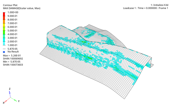

  6. You may want to realize a simulation starting from existing total and plastic strains fields (after a previous forming simulation for instance). In the case where the failure criterion is not computed during the first simulation, it is possible to estimate a damage field from the total strain tensor and the plastic strain values obtained at the end of the first simulation (using .sta files) for shell elements only. If the Dinit flag is set to 1, the damage field will be computed if the plastic strain ≠ 0. /INISHE/STRA_F, /INISHE/STRA_F, /INISHE/EPSP_F and /INISH3/EPSP_F must be present in the keywords of the status file. The initial stress tensors are not incorporated into the simulation model; thus, the stress triaxiality is derived using:
    η = 1 3 1 + β 1 + β + β 2 MathType@MTEF@5@5@+= feaahqart1ev3aqatCvAUfeBSjuyZL2yd9gzLbvyNv2CaerbuLwBLn hiov2DGi1BTfMBaeXatLxBI9gBaerbd9wDYLwzYbItLDharqqtubsr 4rNCHbGeaGqiVu0Je9sqqrpepC0xbbL8F4rqqrFfpeea0xe9Lq=Jc9 vqaqpepm0xbba9pwe9Q8fs0=yqaqpepae9pg0FirpepeKkFr0xfr=x fr=xb9adbaqaaeGaciGaaiaabeqaamaabaabaaGcbaGaeq4TdGMaey ypa0ZaaSaaaeaacaaIXaaabaWaaOaaaeaacaaIZaaaleqaaaaakmaa laaabaGaaGymaiabgUcaRiabek7aIbqaamaakaaabaGaaGymaiabgU caRiabek7aIjabgUcaRiabek7aInaaCaaaleqabaGaaGOmaaaaaeqa aaaaaaa@445B@
    The β value can be recovered from the stress triaxiality value using the first root of Equation 4:
    β = ( 2 3 η 2 ) 3 η 2 4 9 η 2 2 3 η 2 1 MathType@MTEF@5@5@+= feaahqart1ev3aqatCvAUfeBSjuyZL2yd9gzLbvyNv2CaerbuLwBLn hiov2DGi1BTfMBaeXatLxBI9gBaerbd9wDYLwzYbItLDharqqtubsr 4rNCHbGeaGqiVu0Je9sqqrpepC0xbbL8F4rqqrFfpeea0xe9Lq=Jc9 vqaqpepm0xbba9pwe9Q8fs0=yqaqpepae9pg0FirpepeKkFr0xfr=x fr=xb9adbaqaaeGaciGaaiaabeqaamaabaabaaGcbaGaeqOSdiMaey ypa0ZaaSaaaeaacaGGOaGaaGOmaiabgkHiTiaaiodacqaH3oaAdaah aaWcbeqaaiaaikdaaaGccaGGPaGaeyOeI0YaaOaaaeaacaaIZaGaeq 4TdG2aaWbaaSqabeaacaaIYaaaaOWaaeWaaeaacaaI0aGaeyOeI0Ia aGyoaiabeE7aOnaaCaaaleqabaGaaGOmaaaaaOGaayjkaiaawMcaaa WcbeaaaOqaaiaaikdadaqadaqaaiaaiodacqaH3oaAdaahaaWcbeqa aiaaikdaaaGccqGHsislcaaIXaaacaGLOaGaayzkaaaaaaaa@5156@
    Then, an initial damage value can be estimated as:
    D t = 0 = ε p t = 0 ε p f MathType@MTEF@5@5@+= feaahqart1ev3aqatCvAUfeBSjuyZL2yd9gzLbvyNv2CaerbuLwBLn hiov2DGi1BTfMBaeXatLxBI9gBaerbd9wDYLwzYbItLDharqqtubsr 4rNCHbGeaGqiVu0Je9sqqrpepC0xbbL8F4rqqrFfpeea0xe9Lq=Jc9 vqaqpepm0xbba9pwe9Q8fs0=yqaqpepae9pg0FirpepeKkFr0xfr=x fr=xb9adbaqaaeGaciGaaiaabeqaamaabaabaaGcbaGaamiramaaBa aaleaacaWG0bGaeyypa0JaaGimaaqabaGccqGH9aqpdaWcaaqaaiab ew7aLnaaDaaaleaacaWGWbaabaGaamiDaiabg2da9iaaicdaaaaake aacqaH1oqzdaqhaaWcbaGaamiCaaqaaiaadAgaaaaaaaaa@4402@
    Figure 3 shows an example of initialized damage field in one-step after a forming simulation performed without failure criterion computation. Damage field is then deduced using the plastic strain and the strain tensor as presented above.
    Figure 3. Example of damage field “one-step” initialization after a forming simulation

    For visualization purposes, the instability curve ( ε p i n s t MathType@MTEF@5@5@+= feaahqart1ev3aaatCvAUfeBSjuyZL2yd9gzLbvyNv2CaerbuLwBLn hiov2DGi1BTfMBaeXatLxBI9gBaerbd9wDYLwzYbItLDharqqtubsr 4rNCHbGeaGqiVu0Je9sqqrpepC0xbbL8F4rqqrFfpeea0xe9Lq=Jc9 vqaqpepm0xbba9pwe9Q8fs0=yqaqpepae9pg0FirpepeKkFr0xfr=x fr=xb9adbaqaaeGaciGaaiaabeqaamaabaabaaGcbaGaeqyTdu2aa0 baaSqaaiaadchaaeaacaWGPbGaamOBaiaadohacaWG0baaaaaa@3C8E@ versus η ) can be obtained from all the equations above. For instance, if the Nvalue is set to 0.175, the following curve (Figure 4) is obtained.
    Figure 4. Example of instability curve (orange) and its position with respect to failure criterion (blue)

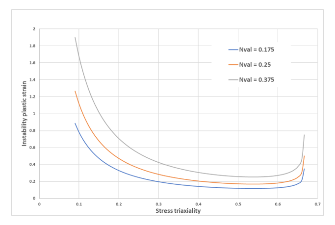

    The effect of instability curve is restricted to positive stress triaxiality (as necking only occurs in tension) and only has an effect when it is under the failure criterion curve.
    Figure 5 shows several instability curves obtained with different Nvalue parameter values.
    Figure 5. Instability curves obtained with different Nvalue parameters

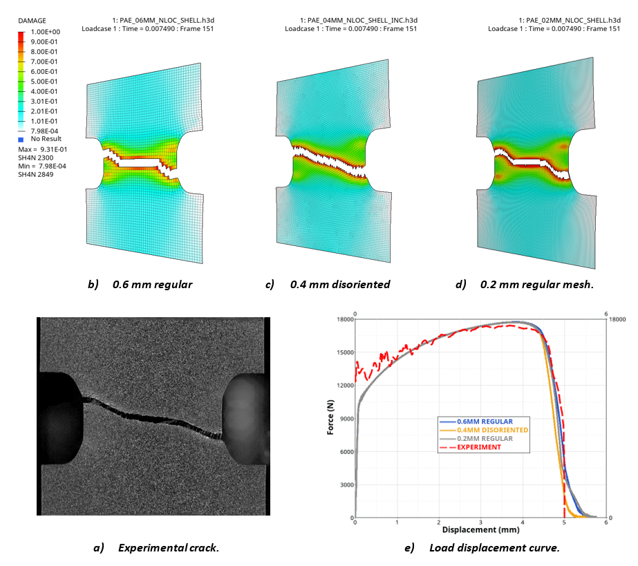

  9. Alternatively, the /NONLOCAL/MAT option which is compatible with Syazwan failure criterion (Figure 6) can be used to regularize the solution according to mesh size and orientation. If the non-local regularization is used, the non-local plastic strain is used to compute the damage evolution (and the instability variable, if used). In that case, the maximum non-local length parameter LE_MAX is used instead of the initial element size if an element size scaling is defined through fct_IDEl. Also, the non-local regularization is also available with the “one-step” damage field initialization.
    Figure 6. Example of /NONLOCAL/MAT option cumulated with /FAIL/SYAZWAN on automotive DP450 steel
