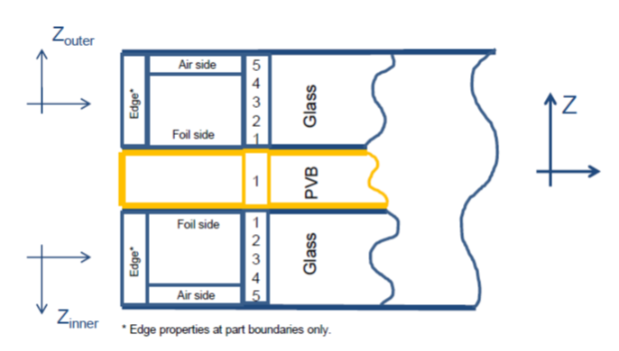

Cr_foil Crack depth at bottom surface.
Default = 0.0 (Real)
[ m ]
Cr_air Crack depth at top surface.
Default = 1.0 (Real)
[ m ]
Cr_core Crack depth in between bottom and surface integration points.
[ m ]
Cr_edge Crack depth at the edge elements of windshield.
[ m ]

  5. This failure model is applied to shell elements that sandwich a polyvinyl butyral (PVB) solid element layer using coincident nodes. The entire assembly models a windshield.
    Figure 1. Windshield finite element model
    Figure 2. Windshield model - entire assembly
  6. The shell elements using this failure model should be oriented so that their normals point away the from the middle PVB.
  7. The shell elements should have an offset applied to correctly model bending. This can be done using /PROP/TYPE51 Ipos=4.

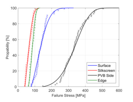

  10. Ch. Brokmann extension 2 defines additional fracture criteria for external glass surfaces only. It introduces initial stress on the glass surface, due to mechanical or chemical treatment. Statistical evaluation of micro flaws in the glass surface allows to define a probability of fracture using left-truncated Weibull stochastic distribution:
    with i MathType@MTEF@5@5@+= feaagKart1ev2aaatCvAUfeBSjuyZL2yd9gzLbvyNv2CaerbuLwBLn hiov2DGi1BTfMBaeXatLxBI9gBaerbd9wDYLwzYbItLDharqqtubsr 4rNCHbGeaGqipu0Je9sqqrpepC0xbbL8F4rqqrFfpeea0xe9Lq=Jc9 vqaqpepm0xbba9pwe9Q8fs0=yqaqpepae9pg0FirpepeKkFr0xfr=x fr=xb9adbaqaaeGaciGaaiaabeqaamaabaabaaGcbaGaamyAaaaa@36C4@ = 1,2 for bottom and top surface
    P ( σ ) = 1 − exp [ ( τ i η i ) β i − ( σ η i ) β i ] MathType@MTEF@5@5@+= feaagKart1ev2aaatCvAUfeBSjuyZL2yd9gzLbvyNv2CaerbuLwBLn hiov2DGi1BTfMBaeXatLxBI9gBaerbd9wDYLwzYbItLDharqqtubsr 4rNCHbGeaGqiVu0Je9sqqrpepC0xbbL8F4rqqrFfpeea0xe9Lq=Jc9 vqaqpepm0xbba9pwe9Q8fs0=yqaqpepae9pg0FirpepeKkFr0xfr=x fr=xb9adbaqaaeGaciGaaiaabeqaamaabaabaaGcbaGaamiuaiaacI cacqaHdpWCcaGGPaGaeyypa0JaaGymaiabgkHiTiGacwgacaGG4bGa aiiCamaadmaabaWaaubiaeqaleqabaGaeqOSdi2aaSbaaWqaaiaadM gaaeqaaaqdbaWaaeWaaeaadaWcaaqaaiabes8a0naaBaaaoeaacaWG Pbaabeaaa0qaaiabeE7aOnaaBaaaoeaacaWGPbaabeaaaaaaniaawI cacaGLPaaaaaGccqGHsisldaqfGaqabSqabeaacqaHYoGydaWgaaad baGaamyAaaqabaaaneaadaqadaqaamaalaaabaGaeq4WdmhabaGaeq 4TdG2aaSbaa4qaaiaadMgaaeqaaaaaa0GaayjkaiaawMcaaaaaaOGa ay5waiaaw2faaaaa@5617@
    Truncation point τ = 0 MathType@MTEF@5@5@+= feaagKart1ev2aqatCvAUfeBSjuyZL2yd9gzLbvyNv2CaerbuLwBLn hiov2DGi1BTfMBaeXatLxBI9gBaerbd9wDYLwzYbItLDharqqtubsr 4rNCHbGeaGqiVu0Je9sqqrpepC0xbbL8F4rqqrFfpeea0xe9Lq=Jc9 vqaqpepm0xbba9pwe9Q8fs0=yqaqpepae9pg0FirpepeKkFr0xfr=x fr=xb9adbaqaaeGaciGaaiaabeqaamaabaabaaGcbaGaeqiXdqNaey ypa0JaaGimaaaa@397C@ yields the well-known two-parameter Weibull distribution. The Brokmann model calculates the randomly oriented initial flaws in the glass and distributes them over all finite elements with different lengths and geometry. Crack growth may be expressed by the following differential equation:

    Integral of Equation 3 will yield actual crack size, strongly dependent on stress rate. Actual stress intensity factors can be calculated and used in the fracture criteria.
    The interest of Brokmann’s model is that depending on the distribution parameters and failure stress value, it is possible to estimate the stochastic probability of failure.

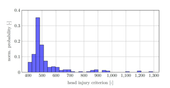

    After running a sufficient number of simulations with random initialization of glass flaws return a possibility to estimate a probability to reach a given value of the head injury criterion (HIC).
    Figure 4.
