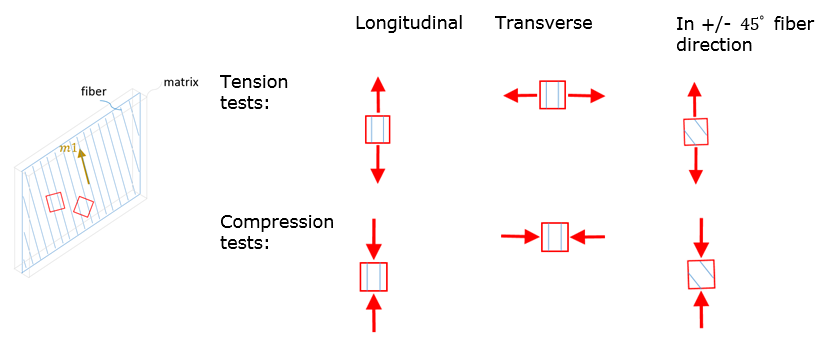

Example (Composite)
With tension and compression tests (see Figure 1) of single composite layer and pure matrix test to determine the strength and yield stress, which are used in material LAW25 and in failure model Hashin. Delamination is not considered in this example.
Figure 1. Fabric Lamina Model (Iform =2)
fail_hashin_example
