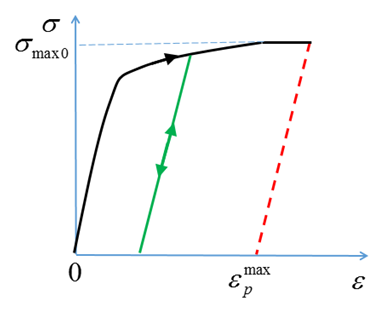

LAW2: Use Plastic Strain for Failure
In LAW2, the maximum plastic strain ε p m a x used for element failure. This means the shell element is deleted once it reaches the maximum plastic strain defined in the model. Unlike LAW27, there is no damage before failure and the failure can occur in both tension and compression.

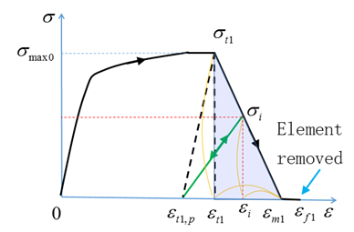

LAW27: Use a Damage Model
LAW27 is used to simulate material damage using a Johnson-Cook plasticity law. A damage model is incorporated into the material law to take into account the damage evolution where stress decreases up to element rupture. When using the material failure included in LAW27, the failure and damage occur only in tension and not compression.
The damage parameters in the principal direction i = 1 , 2 MathType@MTEF@5@5@+= feaagKart1ev2aqatCvAUfeBSjuyZL2yd9gzLbvyNv2CaerbuLwBLn hiov2DGi1BTfMBaeXatLxBI9gBaerbd9wDYLwzYbItLDharqqtubsr 4rNCHbGeaGqiVu0Je9qqqrpepC0xbbL8F4rqGqFfpeea0xe9vq=Jb9 vqpeea0xd9q8qiYRWxGi6xij=hbba9q8aq0=yq=He9q8qiLsFr0=vr 0=vr0db8meaabaqaciGacaGaaeqabaWaaeaaeaaakeaacaWGPbGaey ypa0JaaGymaiaacYcacaaIYaaaaa@3B63@ are ε t i , ε f i , ε m i MathType@MTEF@5@5@+= feaagKart1ev2aqatCvAUfeBSjuyZL2yd9gzLbvyNv2CaerbuLwBLn hiov2DGi1BTfMBaeXatLxBI9gBaerbd9wDYLwzYbItLDharqqtubsr 4rNCHbGeaGqiVu0Je9qqqrpepC0xbbL8F4rqGqFfpeea0xe9vq=Jb9 vqpeea0xd9q8qiYRWxGi6xij=hbba9q8aq0=yq=He9q8qiLsFr0=vr 0=vr0db8meaabaqaciGacaGaaeqabaWaaeaaeaaakeaacqaH1oqzda WgaaWcbaGaamiDaiaadMgaaeqaaOGaaiilaiabew7aLnaaBaaaleaa caWGMbGaamyAaaqabaGccaGGSaGaeqyTdu2aaSbaaSqaaiaad2gaca WGPbaabeaaaaa@43D5@ .
ε t i = 0.14 MathType@MTEF@5@5@+= feaagKart1ev2aqatCvAUfeBSjuyZL2yd9gzLbvyNv2CaerbuLwBLn hiov2DGi1BTfMBaeXatLxBI9gBaerbd9wDYLwzYbItLDharqqtubsr 4rNCHbGeaGqiVu0Je9qqqrpepC0xbbL8F4rqGqFfpeea0xe9vq=Jb9 vqpeea0xd9q8qiYRWxGi6xij=hbba9q8aq0=yq=He9q8qiLsFr0=vr 0=vr0db8meaabaqaciGacaGaaeqabaWaaeaaeaaakeaacqaH1oqzda WgaaWcbaGaamiDaiaadMgaaeqaaOGaeyypa0JaaGimaiaac6cacaaI XaGaaGinaaaa@3EF7@ ; ε m i = 0.15 MathType@MTEF@5@5@+= feaagKart1ev2aqatCvAUfeBSjuyZL2yd9gzLbvyNv2CaerbuLwBLn hiov2DGi1BTfMBaeXatLxBI9gBaerbd9wDYLwzYbItLDharqqtubsr 4rNCHbGeaGqiVu0Je9qqqrpepC0xbbL8F4rqGqFfpeea0xe9vq=Jb9 vqpeea0xd9q8qiYRWxGi6xij=hbba9q8aq0=yq=He9q8qiLsFr0=vr 0=vr0db8meaabaqaciGacaGaaeqabaWaaeaaeaaakeaacqaH1oqzda WgaaWcbaGaamiDaiaadMgaaeqaaOGaeyypa0JaaGimaiaac6cacaaI XaGaaGinaaaa@3EF7@ ; ε f i = 0.16 MathType@MTEF@5@5@+= feaagKart1ev2aqatCvAUfeBSjuyZL2yd9gzLbvyNv2CaerbuLwBLn hiov2DGi1BTfMBaeXatLxBI9gBaerbd9wDYLwzYbItLDharqqtubsr 4rNCHbGeaGqiVu0Je9qqqrpepC0xbbL8F4rqGqFfpeea0xe9vq=Jb9 vqpeea0xd9q8qiYRWxGi6xij=hbba9q8aq0=yq=He9q8qiLsFr0=vr 0=vr0db8meaabaqaciGacaGaaeqabaWaaeaaeaaakeaacqaH1oqzda WgaaWcbaGaamiDaiaadMgaaeqaaOGaeyypa0JaaGimaiaac6cacaaI XaGaaGinaaaa@3EF7@
When the principal strain reaches ε t i = 0.14 MathType@MTEF@5@5@+= feaagKart1ev2aqatCvAUfeBSjuyZL2yd9gzLbvyNv2CaerbuLwBLn hiov2DGi1BTfMBaeXatLxBI9gBaerbd9wDYLwzYbItLDharqqtubsr 4rNCHbGeaGqiVu0Je9qqqrpepC0xbbL8F4rqGqFfpeea0xe9vq=Jb9 vqpeea0xd9q8qiYRWxGi6xij=hbba9q8aq0=yq=He9q8qiLsFr0=vr 0=vr0db8meaabaqaciGacaGaaeqabaWaaeaaeaaakeaacqaH1oqzda WgaaWcbaGaamiDaiaadMgaaeqaaOGaeyypa0JaaGimaiaac6cacaaI XaGaaGinaaaa@3EF7@ , the material damage starts, based on the damage face d i MathType@MTEF@5@5@+= feaagKart1ev2aaatCvAUfeBSjuyZL2yd9gzLbvyNv2CaerbuLwBLn hiov2DGi1BTfMBaeXatLxBI9gBaerbd9wDYLwzYbItLDharqqtubsr 4rNCHbGeaGqiVu0Je9sqqrpepC0xbbL8F4rqqrFfpeea0xe9Lq=Jc9 vqaqpepm0xbba9pwe9Q8fs0=yqaqpepae9pg0FirpepeKkFr0xfr=x fr=xb9adbaqaaeGaciGaaiaabeqaamaabaabaaGcbaGaamizamaaBa aaleaacaWGPbaabeaaaaa@37F9@ and d max i MathType@MTEF@5@5@+= feaagKart1ev2aqatCvAUfeBSjuyZL2yd9gzLbvyNv2CaerbuLwBLn hiov2DGi1BTfMBaeXatLxBI9gBaerbd9wDYLwzYbItLDharqqtubsr 4rNCHbGeaGqiVu0Je9qqqrpepC0xbbL8F4rqGqFfpeea0xe9vq=Jb9 vqpeea0xd9q8qiYRWxGi6xij=hbba9q8aq0=yq=He9q8qiLsFr0=vr 0=vr0db8meaabaqaciGacaGaaeqabaWaaeaaeaaakeaacaWGKbWaaS baaSqaaiGac2gacaGGHbGaaiiEaiaadMgaaeqaaaaa@3C1F@ , which are given by:
d i =min( ε i − ε ti ε mi − ε ti , d maxi ) MathType@MTEF@5@5@+= feaagKart1ev2aqatCvAUfeBSjuyZL2yd9gzLbvyNv2CaerbuLwBLn hiov2DGi1BTfMBaeXatLxBI9gBaerbd9wDYLwzYbItLDharqqtubsr 4rNCHbGeaGqiVu0Je9qqqrpepC0xbbL8F4rqGqFfpeea0xe9vq=Jb9 vqpeea0xd9q8qiYRWxGi6xij=hbba9q8aq0=yq=He9q8qiLsFr0=vr 0=vr0db8meaabaqaciGacaGaaeqabaWaaeaaeaaakeaacaWGKbWaaS baaSqaaiaadMgaaeqaaOGaeyypa0JaciyBaiaacMgacaGGUbWaaeWa aeaadaWcaaqaaiabew7aLnaaBaaaleaacaWGPbaabeaakiabgkHiTi abew7aLnaaBaaaleaacaWG0bGaamyAaaqabaaakeaacqaH1oqzdaWg aaWcbaGaamyBaiaadMgaaeqaaOGaeyOeI0IaeqyTdu2aaSbaaSqaai aadshacaWGPbaabeaaaaGccaGGSaGaamizamaaBaaaleaaciGGTbGa aiyyaiaacIhacaWGPbaabeaaaOGaayjkaiaawMcaaaaa@5441@
In directions, i = 1 , 2 MathType@MTEF@5@5@+= feaagKart1ev2aqatCvAUfeBSjuyZL2yd9gzLbvyNv2CaerbuLwBLn hiov2DGi1BTfMBaeXatLxBI9gBaerbd9wDYLwzYbItLDharqqtubsr 4rNCHbGeaGqiVu0Je9qqqrpepC0xbbL8F4rqGqFfpeea0xe9vq=Jb9 vqpeea0xd9q8qiYRWxGi6xij=hbba9q8aq0=yq=He9q8qiLsFr0=vr 0=vr0db8meaabaqaciGacaGaaeqabaWaaeaaeaaakeaacaWGPbGaey ypa0JaaGymaiaacYcacaaIYaaaaa@3B63@ .
The stress is then reduced using the damage parameter, σ i r e d u c e d = σ i ( 1 − d i ) MathType@MTEF@5@5@+= feaagKart1ev2aqatCvAUfeBSjuyZL2yd9gzLbvyNv2CaerbuLwBLn hiov2DGi1BTfMBaeXatLxBI9gBaerbd9wDYLwzYbItLDharqqtubsr 4rNCHbGeaGqiVu0Je9sqqrpepC0xbbL8F4rqqrFfpeea0xe9Lq=Jc9 vqaqpepm0xbba9pwe9Q8fs0=yqaqpepae9pg0FirpepeKkFr0xfr=x fr=xb9adbaqaaeGaciGaaiaabeqaamaabaabaaGcbaaeaaaaaaaaa8 qacqaHdpWCpaWaa0baaSqaa8qacaWGPbaapaqaa8qacaWGYbGaamyz aiaadsgacaWG1bGaam4yaiaadwgacaWGKbaaaOGaeyypa0Jaeq4Wdm 3damaaBaaaleaapeGaamyAaaWdaeqaaOWdbmaabmaapaqaa8qacaaI XaGaeyOeI0Iaamiza8aadaWgaaWcbaWdbiaadMgaa8aabeaaaOWdbi aawIcacaGLPaaaaaa@4982@ .
The damage factor in the first principal direction is a function of principal strain:
d i = min ( ε i − 0.14 0.15 − 0.14 , 0.999 ) MathType@MTEF@5@5@+= feaagKart1ev2aqatCvAUfeBSjuyZL2yd9gzLbvyNv2CaerbuLwBLn hiov2DGi1BTfMBaeXatLxBI9gBaerbd9wDYLwzYbItLDharqqtubsr 4rNCHbGeaGqiVu0Je9qqqrpepC0xbbL8F4rqGqFfpeea0xe9vq=Jb9 vqpeea0xd9q8qiYRWxGi6xij=hbba9q8aq0=yq=He9q8qiLsFr0=vr 0=vr0db8meaabaqaciGacaGaaeqabaWaaeaaeaaakeaacaWGKbWaaS baaSqaaiaadMgaaeqaaOGaeyypa0JaciyBaiaacMgacaGGUbWaaeWa aeaadaWcaaqaaiabew7aLnaaBaaaleaacaWGPbaabeaakiabgkHiTi aaicdacaGGUaGaaGymaiaaisdaaeaacaaIWaGaaiOlaiaaigdacaaI 1aGaeyOeI0IaaGimaiaac6cacaaIXaGaaGinaaaacaGGSaGaaGimai aac6cacaaI5aGaaGyoaiaaiMdaaiaawIcacaGLPaaaaaa@5080@

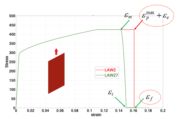

    With ε f 1 i n L A W 27 = ( ε e + ε p max ) i n L A W 2 MathType@MTEF@5@5@+= feaagKart1ev2aqatCvAUfeBSjuyZL2yd9gzLbvyNv2CaerbuLwBLn hiov2DGi1BTfMBaeXatLxBI9gBaerbd9wDYLwzYbItLDharqqtubsr 4rNCHbGeaGqiVu0Je9qqqrpepC0xbbL8F4rqGqFfpeea0xe9vq=Jb9 vqpeea0xd9q8qiYRWxGi6xij=hbba9q8aq0=yq=He9q8qiLsFr0=vr 0=vr0db8meaabaqaciGacaGaaeqabaWaaeaaeaaakeaacqaH1oqzda WgaaWcbaGaamOzaiaaigdaaeqaaOqbaeqabeqaaaqaaaaacaWGPbGa amOBauaabeqabeaaaeaaaaGaamitaiaadgeacaWGxbGaaGOmaiaaiE dacqGH9aqpcaGGOaGaeqyTdu2aaSbaaSqaaiaadwgaaeqaaOGaey4k aSIaeqyTdu2aa0baaSqaaiaadchaaeaaciGGTbGaaiyyaiaacIhaaa GccaGGPaqbaeqabeqaaaqaaaaacaWGPbGaamOBauaabeqabeaaaeaa aaGaamitaiaadgeacaWGxbGaaGOmaaaa@5187@
    • In LAW27, ε t i , ε m i , ε f i MathType@MTEF@5@5@+= feaagKart1ev2aqatCvAUfeBSjuyZL2yd9gzLbvyNv2CaerbuLwBLn hiov2DGi1BTfMBaeXatLxBI9gBaerbd9wDYLwzYbItLDharqqtubsr 4rNCHbGeaGqiVu0Je9qqqrpepC0xbbL8F4rqGqFfpeea0xe9vq=Jb9 vqpeea0xd9q8qiYRWxGi6xij=hbba9q8aq0=yq=He9q8qiLsFr0=vr 0=vr0db8meaabaqaciGacaGaaeqabaWaaeaaeaaakeaacqaH1oqzda WgaaWcbaGaamiDaiaadMgaaeqaaOGaaiilaiabew7aLnaaBaaaleaa caWGTbGaamyAaaqabaGccaGGSaGaeqyTdu2aaSbaaSqaaiaadAgaca WGPbaabeaaaaa@43D5@ are total strain.
    • In LAW2, ε p m a x is plastic strain.
    In one shell element set:
    • In LAW27, ε f 1 = 0.16 MathType@MTEF@5@5@+= feaagKart1ev2aqatCvAUfeBSjuyZL2yd9gzLbvyNv2CaerbuLwBLn hiov2DGi1BTfMBaeXatLxBI9gBaerbd9wDYLwzYbItLDharqqtubsr 4rNCHbGeaGqiVu0Je9qqqrpepC0xbbL8F4rqGqFfpeea0xe9vq=Jb9 vqpeea0xd9q8qiYRWxGi6xij=hbba9q8aq0=yq=He9q8qiLsFr0=vr 0=vr0db8meaabaqaciGacaGaaeqabaWaaeaaeaaakeaacqaH1oqzda WgaaWcbaGaamOzaiaaigdaaeqaaOGaeyypa0JaaGimaiaac6cacaaI XaGaaGOnaaaa@3EB8@
    • In LAW2, ε p max = 0.1559 MathType@MTEF@5@5@+= feaagKart1ev2aqatCvAUfeBSjuyZL2yd9gzLbvyNv2CaerbuLwBLn hiov2DGi1BTfMBaeXatLxBI9gBaerbd9wDYLwzYbItLDharqqtubsr 4rNCHbGeaGqiVu0Je9qqqrpepC0xbbL8F4rqGqFfpeea0xe9vq=Jb9 vqpeea0xd9q8qiYRWxGi6xij=hbba9q8aq0=yq=He9q8qiLsFr0=vr 0=vr0db8meaabaqaciGacaGaaeqabaWaaeaaeaaakeaacqaH1oqzda qhaaWcbaGaamiCaaqaaiGac2gacaGGHbGaaiiEaaaakiabg2da9iaa icdacaGGUaGaaGymaiaaiwdacaaI1aGaaGyoaaaa@425D@
    So that element deleted at same strain.
    ε t o t a l = ε e + ε p = σ y E + 0.1559 = 290 71000 + 0.1559 = 0.16 MathType@MTEF@5@5@+= feaagKart1ev2aqatCvAUfeBSjuyZL2yd9gzLbvyNv2CaerbuLwBLn hiov2DGi1BTfMBaeXatLxBI9gBaerbd9wDYLwzYbItLDharqqtubsr 4rNCHbGeaGqiVu0Je9qqqrpepC0xbbL8F4rqGqFfpeea0xe9vq=Jb9 vqpeea0xd9q8qiYRWxGi6xij=hbba9q8aq0=yq=He9q8qiLsFr0=vr 0=vr0db8meaabaqaciGacaGaaeqabaWaaeaaeaaakeaacqaH1oqzda WgaaWcbaGaamiDaiaad+gacaWG0bGaamyyaiaadYgaaeqaaOGaeyyp a0JaeqyTdu2aaSbaaSqaaiaadwgaaeqaaOGaey4kaSIaeqyTdu2aaS baaSqaaiaadchaaeqaaOGaeyypa0ZaaSaaaeaacqaHdpWCdaWgaaWc baGaamyEaaqabaaakeaacaWGfbaaaiabgUcaRiaaicdacaGGUaGaaG ymaiaaiwdacaaI1aGaaGyoaiabg2da9maalaaabaGaaGOmaiaaiMda caaIWaaabaGaaG4naiaaigdacaaIWaGaaGimaiaaicdaaaGaey4kaS IaaGimaiaac6cacaaIXaGaaGynaiaaiwdacaaI5aGaeyypa0JaaGim aiaac6cacaaIXaGaaGOnaaaa@5FB4@

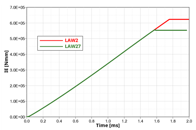

    Although the element is deleted at same strain the internal energy at failure is different for LAW2 and LAW27, due to the difference the failure treatment.

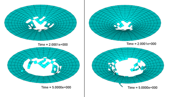

Plate Impact Model
If the previous failure strains definitions in a plate example is used, the results are also different.
Figure 6. Failure Behavior in Plate Test. left: LAW2; right: LAW27
fig_26-7
The previous one element biaxial tension test showed the differences in LAW2 and LAW27 in tension. Since LAW27 does not fail in compression, but LAW2 does fail in compression, this causes a difference in the plate example shown in Figure 6.
