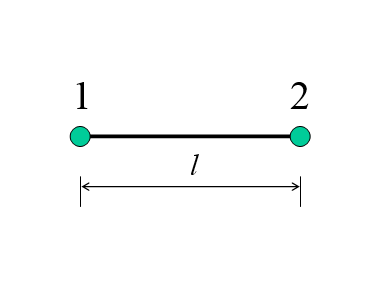

If a uniform linear-displacement bar element is considered, (Figure 2), and a lumped mass formulation at the nodes is used, the highest frequency of this element can be obtained by a resolution of an eigen value problem:
[ K ] { X } = ω 2 [ M ] { X }
det ( [ K ] − ω 2 [ M ] ) = 0
For a lumped mass bar, you have:
[ K ] = k [ 1 − 1 − 1 1 ]
[ M ] = m [ 1 0 0 1 ]
Where, m MathType@MTEF@5@5@+= feaagKart1ev2aaatCvAUfeBSjuyZL2yd9gzLbvyNv2CaerbuLwBLn hiov2DGi1BTfMBaeXatLxBI9gBaerbd9wDYLwzYbItLDharqqtubsr 4rNCHbGeaGqiVu0Je9sqqrpepC0xbbL8F4rqqrFfpeea0xe9Lq=Jc9 vqaqpepm0xbba9pwe9Q8fs0=yqaqpepae9pg0FirpepeKkFr0xfr=x fr=xb9adbaqaaeGaciGaaiaabeqaamaabaabaaGcbaGaam4saaaa@36C6@ and k MathType@MTEF@5@5@+= feaagKart1ev2aaatCvAUfeBSjuyZL2yd9gzLbvyNv2CaerbuLwBLn hiov2DGi1BTfMBaeXatLxBI9gBaerbd9wDYLwzYbItLDharqqtubsr 4rNCHbGeaGqiVu0Je9sqqrpepC0xbbL8F4rqqrFfpeea0xe9Lq=Jc9 vqaqpepm0xbba9pwe9Q8fs0=yqaqpepae9pg0FirpepeKkFr0xfr=x fr=xb9adbaqaaeGaciGaaiaabeqaamaabaabaaGcbaGaam4saaaa@36C6@ are respectively the nodal mass and stiffness of the bar:
k = E A l   ;   m = A ρ l 2
Equation Equation 5 yields:
( k − m ω 2 ) 2 − k 2 = 0
then:
ω = 2 k m
which can be simplified with Equation 8 to obtain:
ω = 2 l E ρ = 2 c l
Where, c MathType@MTEF@5@5@+= feaagKart1ev2aaatCvAUfeBSjuyZL2yd9gzLbvyNv2CaerbuLwBLn hiov2DGi1BTfMBaeXatLxBI9gBaerbd9wDYLwzYbItLDharqqtubsr 4rNCHbGeaGqiVu0Je9sqqrpepC0xbbL8F4rqqrFfpeea0xe9Lq=Jc9 vqaqpepm0xbba9pwe9Q8fs0=yqaqpepae9pg0FirpepeKkFr0xfr=x fr=xb9adbaqaaeGaciGaaiaabeqaamaabaabaaGcbaGaam4saaaa@36C6@ is the speed of sound in the material and its expression is given as:
c = E ρ
with ρ the material density and the Young’s modulus. Combining Equation 11 and Equation 1, you obtain:
Δ t ≤ l c

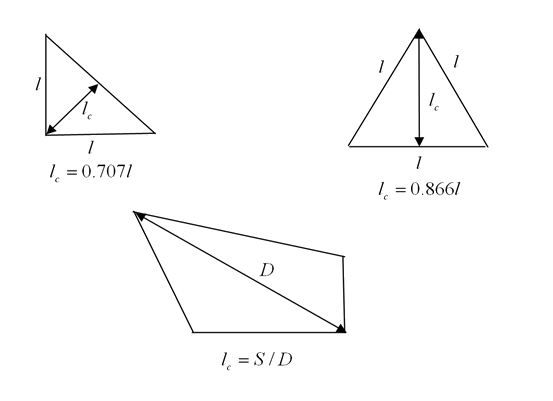

Figure 2. Element Characteristic Lengths
This relation is that of Equation 3 and shows that the critical time step value in the explicit time integration of dynamic equation of motion can be carried out by the interpretation of shock wave propagation in the material. This is shown for the first time by Courant. 1 In spite of their works are limited to simple cases, the same procedure can be used for different kinds of finite elements. The characteristic lengths of the elements are found and Equation 3 is written for all elements to find the most critical time step over a mesh. Regarding to the type (shape) of element, the expression of characteristic length is different. Figure 2 shows some typical cases for elements with one integration point.
