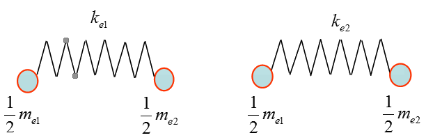

Interfaces have stiffness but no mass:
Where, is the impact speed.
