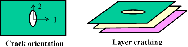

Johnson-Cook plasticity model is presented in Johnson-Cook Plasticity Model (LAW2). For shell applications, a simple damage model can be associated to this law to take into account the brittle failure. The crack propagation occurs in the plan of shell in the case of mono-layer property and through the thickness if a multi-layer property is defined (Figure 1).
Figure 1. Damage Affected Material
