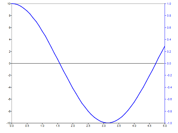

Examples
Simple addaxis example:
Figure 1. Add axis in new plot.
clf;
[ax, h] = addaxis(0:0.1:5, cos(0:0.1:5));

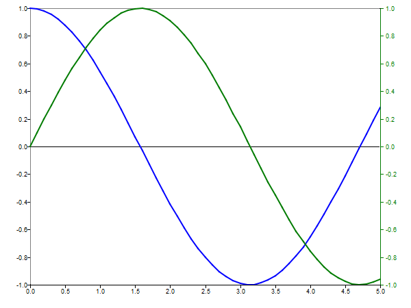

addaxis in an existing plot:
Figure 2. Add a vertical axis in an existing plot.
clf;
x = 0:0.1:5;
plot(x, cos(x));
[ax, h] = addaxis(x, sin(x));

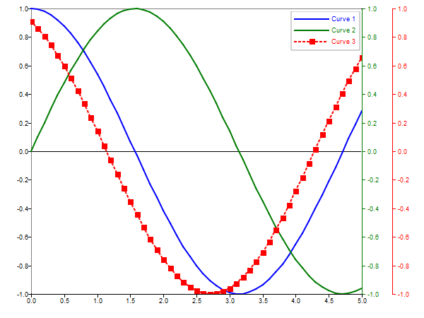

Multiple vertical axes can be added on the right side of the plot:
Figure 3. Multiple vertical axes.
clf;
x = 0:0.1:5;
plot(x, cos(x));
[ax1, h1] = addaxis(x, sin(x));
[ax2, h2] = addaxis(x, sin(x+2), ':s');
legend;

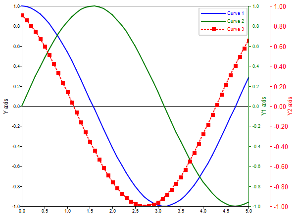

Change the appearance of vertical axis:
Figure 4. Change the appearance of vertical axis.
clf;
x = 0:0.1:5;
plot(x, cos(x));
set(ax2(2), {'fontsize', 'ynumericformat', 'ynumericprecision'}, {10, 'fixed', 2});
ylabel('Y axis');
ylabel(ax1(2), 'Y1 axis');
ylabel(ax2(2), 'Y2 axis');
legend;

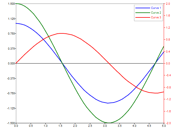

The vertical axis that a line is assigned to can be changed:
Figure 5. Change the y-axis of a curve.
clf;
x = 0:0.1:5;
h = plot(x, [cos(x); 2*cos(x)]);
[ax, h1] = addaxis(x, sin(x));
set(h(2),'yaxis', ax(2));
ylim([-1.5 1.5]);
ylim(ax(2), [-2 2]);
legend;
